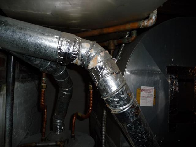

Robert Jones Posted December 12, 2009 Report Share Posted December 12, 2009 The furnace is approx 15 yrs old. The flue is vented to a masonry chimney(which is in poor shape). What would normally cause a drafting issue with this type of venting? There are no strange bends. It appears to have been going on for quite some time. Did I just ask a vague question? Click to Enlarge 40.32 KB Click to Enlarge 52.82 KB Click to Enlarge 63.8 KB Quote Link to comment Share on other sites More sharing options...

Jim Katen Posted December 12, 2009 Report Share Posted December 12, 2009 That looks like a single-wall vent connector. Is the furnace in an unheated area? If so, the cold, single wall pipe might be causing extra condensation. It also looks like the vent connector is larger than the outlet on the furnace itself. If the manual is available, I'd check the size of the vent connector. If it's too big, then you might get extra condensation. Another possibility -- and a likely one at that -- is that the furnace is short cycling. That is, it never runs long enough for the flue to warm up and re-evaporate the condensate that formed after the initial firing. Short cycling can be caused by lots of things but the two most common are that the furnace is oversized or that the thermostat is poorly placed near a supply register. - Jim Katen, Oregon Quote Link to comment Share on other sites More sharing options...
Robert Jones Posted December 12, 2009 Author Report Share Posted December 12, 2009 Thanks Jim, The furnace is 75000 btu, servicing a 2000 sq ft home. It is located in an unfinished basement and does share the same flue as the water heater. I appreciate the advice. Quote Link to comment Share on other sites More sharing options...
inspectorchris Posted December 12, 2009 Report Share Posted December 12, 2009 Did the chimney have a rain cap? Was the cap or top of the chimney possibly letting water into the stack? I see this all the time and sometimes when its raining you can see the water running down the chimney into the flue pipe. Because their are no restrictive bends, water can make its way, all the way back into the furnace. Does the water heater flue have and water marks on it? it may not be as bad as the furnace as it should be entering the chimney above the flue of the furnace. Quote Link to comment Share on other sites More sharing options...

hausdok Posted December 12, 2009 Report Share Posted December 12, 2009 Jim and Brandon have pretty much nailed it. Big cold stack with a single-walled connector on a gravity type flue - Condensation central. OT - OF!!! M. Quote Link to comment Share on other sites More sharing options...
