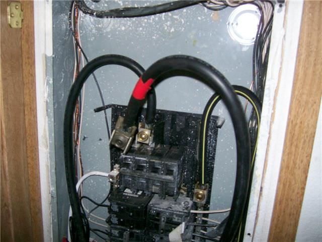

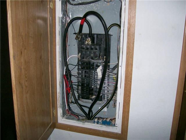

hausdok Posted December 15, 2009 Report Share Posted December 15, 2009 This wire is hot hanging loose in the panel (we moved it toward the front to make sure it didn't short to the can). The lug got so hot that the plastic that was holding it in place melted - the connection to the breaker failed and there you have a hot wire ready to nail you. Always be very careful when you remove a panel cover! Merry Christmas to all! Jim P. Simmons (Mr. Electric 360-705-4225 Olympia 360-426-7600 Shelton 360-458-4002 Yelm 253-203-0104 Tacoma) Link to comment Share on other sites More sharing options...
randynavarro Posted December 16, 2009 Report Share Posted December 16, 2009 I've often wondered about the strength of those main lugs. So many times I see that fat gauge SEC bent and torqued in to place wondering how those lugs are actually attached. But I've yet to see one like in the pic. Link to comment Share on other sites More sharing options...
Jim Katen Posted December 16, 2009 Report Share Posted December 16, 2009 About 12-15 years ago, I remember hearing a lot about this very problem with Siemens panels. There was talk of a recall but it never happened. - Jim Katen, Oregon Link to comment Share on other sites More sharing options...
mgbinspect Posted December 16, 2009 Report Share Posted December 16, 2009 Whew! I don't see them very often, but speaking of the devil, I just opened a Siemens today about 6 hours ago. [:-bigeyes I once simply backed out a panel cover screw (the cover screw that legitimately came with the panel mind you) and it cut into one of the main entry lines, tripping the main breaker after spot-welding the screw and panel cover to the box in a major fireworks show . It happened so fast I didn't even have time to be scared! I'm never in a hurry around the electric panel and absolutely refuse to remove the cover, if I am forced to be off balance to do so. I want to be ready and able to move or be moved in case something happens. Link to comment Share on other sites More sharing options...

Firestarter Posted October 15, 2011 Report Share Posted October 15, 2011 If there is one or two dead leg('s) in a panel I prefer to turn off all breakers pull the meter then look in the panel I have seen bad wires melt the inside of a panel and it's much safer to have no power in there when you pull the cover looking for a short. They can spring just about anywhere creating a much worse problem. Not sure if all areas allow you to pull the meter yourself though. Link to comment Share on other sites More sharing options...
