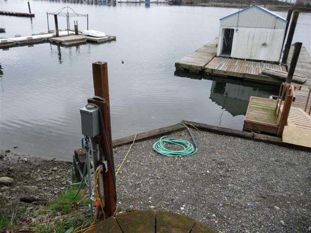

Robert Jones Posted February 10, 2010 Report Share Posted February 10, 2010 That the extension cord should be run under water to feed a boat dock? The yellow cord that is visible, goes from the outlet, into the sound, and back up to the boat dock/launch. Homeowner(builder) stated that it has always been like that! Click to Enlarge 68.88 KB Link to comment Share on other sites More sharing options...
Phillip Posted February 10, 2010 Report Share Posted February 10, 2010 Put a new meaning to "fish fry". It may be rated for outdoor use, but is it rated for under water use? I don't think I have seen one rated for that type of use. Have the builder show you the UL listing saying it can be used under water. Link to comment Share on other sites More sharing options...
Wayne Gardner Posted February 10, 2010 Report Share Posted February 10, 2010 That the extension cord should be run under water to feed a boat dock? The yellow cord that is visible, goes from the outlet, into the sound, and back up to the boat dock/launch. Homeowner(builder) stated that it has always been like that! I would note that the extension cord is not meant to be permanent wiring (wet or dry) and that they should have a proper feed/outlets/etc installed. On a side note, to illustrate the potential hazard... My Dad had a cabin/dock like this on the Lake of the Ozarks. In the summertime, these docks are often full of young kids jumping and swimming around the docks. Imagine the possible trajedy. Wayne G Link to comment Share on other sites More sharing options...
Tom Raymond Posted February 10, 2010 Report Share Posted February 10, 2010 Is it just me, or does any one else find it amusing that the disco is installed directly between the hose bib and the fire ring?[:-jump] I can't tell you how many times I've been jingled hooking up my camper to a set up like that, no way I'd go near it with that cord in the water. Tom Link to comment Share on other sites More sharing options...
Jack Davenport Posted February 11, 2010 Report Share Posted February 11, 2010 NO that is not allowed, nor is it safe. The correct way to get power out there is to have it run along the pier. National Electrical Code article 555 applies Link to comment Share on other sites More sharing options...

msteger Posted February 13, 2010 Report Share Posted February 13, 2010 Homeowner(builder) stated that it has always been like that! A lot of sellers say that when we find hazards in their home. Link to comment Share on other sites More sharing options...
Mr. Electric Posted February 24, 2010 Report Share Posted February 24, 2010 You all need to read this short story. Electricity and water are a hazard waiting to happen. GFCI outlets save lives! http://www.boatus.com/seaworthy/kritz.asp Link to comment Share on other sites More sharing options...
