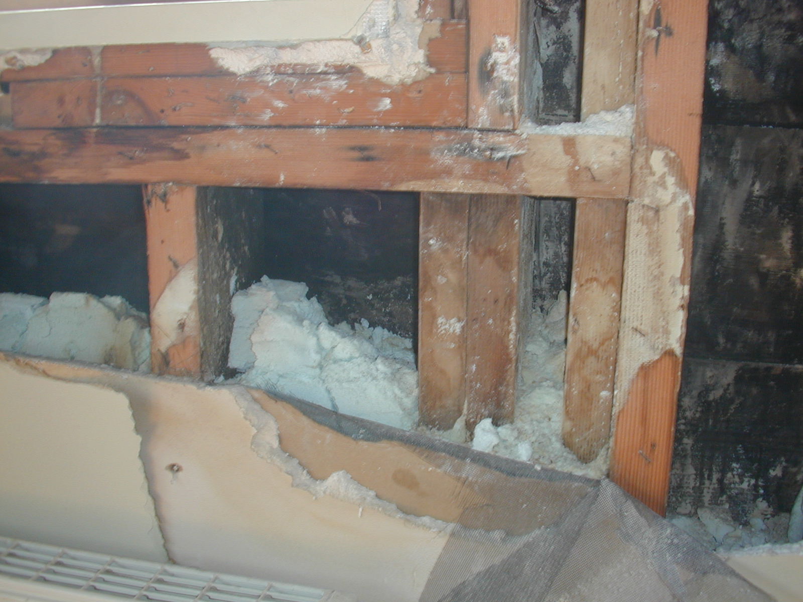

Peter Daly Posted March 19, 2010 Report Share Posted March 19, 2010 I'm hoping someone can identify the insulation shown in the attached photo. It was placed in the walls in a building in San Francisco inabout 2000, presumably blown in behind the netting before the drywall was installed. It has a fine granular texture. The wall cavities have been repeatedly wetted since then due to poor window installation detailing and the lack of a weather-resistive barrier behind old redwood siding and the insulation is currently saturated and has compressed somewhat. I'm hoping to identify the brand and to determine if it can be salvaged in any way or whether I should advise the owner to remove and replace it. Thanks Download Attachment: DSCN0019.JPG 864.27 KB Quote Link to comment Share on other sites More sharing options...
Richard Saunders Posted March 19, 2010 Report Share Posted March 19, 2010 Looks like Icynene pour-fill. I don't think I would try to salvage it if it's wet and compressed. Quote Link to comment Share on other sites More sharing options...

Bill Kibbel Posted March 19, 2010 Report Share Posted March 19, 2010 You sure about the installation date? It really looks like UFFI. I've never seen icynene fill though - only sprayed-on. Quote Link to comment Share on other sites More sharing options...
Peter Daly Posted March 19, 2010 Author Report Share Posted March 19, 2010 I don't think it's Icynene pour fill or uffi. It looks like it was placed behind a netting while the walls were open. Right now, it has very little if any cohesion. I can pull it out in handfulls and has the consistency of a fine sand. I'm sure that the insulation was installed when the building was remodeled in 2000. At the time, it was written up as one of the most important "green" projects in the city up to that time so I'm thinking that the insulation might be a product that was relatively new at the time. Quote Link to comment Share on other sites More sharing options...

mgbinspect Posted March 20, 2010 Report Share Posted March 20, 2010 Expanded Perlite - like what was used as a core-fill in masonry? http://www.perlite.net/ Quote Link to comment Share on other sites More sharing options...
Peter Daly Posted March 20, 2010 Author Report Share Posted March 20, 2010 The photo may be somewhat deceptive. The material is distinctly blue. Quote Link to comment Share on other sites More sharing options...

Bill Kibbel Posted March 20, 2010 Report Share Posted March 20, 2010 The photo may be somewhat deceptive. The material is distinctly blue. The only foam insulation that I've heard of that is blue is one of the BASF Chemical's products. I think it's called "Wall-Tite" or something similar. Quote Link to comment Share on other sites More sharing options...

mgbinspect Posted March 20, 2010 Report Share Posted March 20, 2010 I'm confused. It LOOKS as if it is a granular loose-fill material that has merely become clumpy through exposure to moisture. Is that an accurate assessment or not? Quote Link to comment Share on other sites More sharing options...
Peter Daly Posted March 20, 2010 Author Report Share Posted March 20, 2010 I'm confused. It LOOKS as if it is a granular loose-fill material that has merely become clumpy through exposure to moisture. Is that an accurate assessment or not? Yes I think that's accurate. The only alternative I can think of is that it's a foam product that has somehow broken down completely and that just doesn't seem likely Quote Link to comment Share on other sites More sharing options...
mgbinspect Posted March 20, 2010 Report Share Posted March 20, 2010 Well, it sure looks like Perlite, blue or not, having poured 1000s of bags down block wall. The size seems about right and Perlite is a decent insulation. We were pouring it down school walls in the 70's. I imagine the blue color could have been taken on by what moisture picked up from other materials along the way? Is it wispy light, as if you could accidentally inhale it? Perlite was light as a feather, when dry, and swirled all around us in the air as we poured - so light it almost appeared to defy gravity. One had to be patient in pouring so as not to overwhelm a block core and waste a ton of it. Yet, if there was a hole, of any size, down at the bottom of the wall, it would all sift out in an hour or so like sand in a sand clock - funny stuff... Quote Link to comment Share on other sites More sharing options...

Tom Raymond Posted March 20, 2010 Report Share Posted March 20, 2010 I'd remove it, especially if the walls are opened up like your pic. Perlite is used as an additive to potting soil because it readily absorbs moisture, holds it, and releases it slowly as the surrounding material dries out. Pretty lousy qualities for insulation in a wood framed wall, especially one that leaks. Tom Quote Link to comment Share on other sites More sharing options...
Chad Fabry Posted March 20, 2010 Report Share Posted March 20, 2010 I'd remove it, especially if the walls are opened up like your pic. Perlite is used as an additive to potting soil because it readily absorbs moisture, holds it, and releases it slowly as the surrounding material dries out. Pretty lousy qualities for insulation in a wood framed wall, especially one that leaks. I have the opposite opinion. I like insulations that act like moisture banks far better than non absorbent insulations like fiberglass for existing structures. Quote Link to comment Share on other sites More sharing options...
Peter Daly Posted March 20, 2010 Author Report Share Posted March 20, 2010 I'd remove it, especially if the walls are opened up like your pic. Perlite is used as an additive to potting soil because it readily absorbs moisture, holds it, and releases it slowly as the surrounding material dries out. Pretty lousy qualities for insulation in a wood framed wall, especially one that leaks. I have the opposite opinion. I like insulations that act like moisture banks far better than non absorbent insulations like fiberglass for existing structures. So do you think that this insulation which has been saturated can be dried after the water intrusion issues have been resolved and be effectively left in place? Even if it could be, there are still extensive void areas in the wall where the insulation has settled or been compacted through the wetting process. Quote Link to comment Share on other sites More sharing options...
Chad Fabry Posted March 20, 2010 Report Share Posted March 20, 2010 Peter, My statement addressed only what Tom said. I think the walls in your photo need a re-do. Quote Link to comment Share on other sites More sharing options...
mgbinspect Posted March 20, 2010 Report Share Posted March 20, 2010 I'd remove it, especially if the walls are opened up like your pic. Perlite is used as an additive to potting soil because it readily absorbs moisture, holds it, and releases it slowly as the surrounding material dries out. Pretty lousy qualities for insulation in a wood framed wall, especially one that leaks. I have the opposite opinion. I like insulations that act like moisture banks far better than non absorbent insulations like fiberglass for existing structures. So do you think that this insulation which has been saturated can be dried after the water intrusion issues have been resolved and be effectively left in place? Even if it could be, there are still extensive void areas in the wall where the insulation has settled or been compacted through the wetting process. Not taking into account what Chad or Tom have said, and merely addressing your question regarding moisture, I would guess that it would dry and be fine, because it is apparently an expanded (possibly through a heating process) stone - pretty inert material. Unless someone can make a case to the contrary My guess is that it would be find. I have mixed emotions about the pros and cons of Perlite and moisture: When I was still doing disaster restoration work, it was interesting to observe that typically moister would dribble right on down through fiberglass batt insulation with very little consequence, due to the lack of density of the insulation, until it hit the sill plate, where it finally then became a problem. Perlite, on the other hand is also used mixed with potting soils for either moisture retention or dispersion (not sure which). I can see Chad's point if the Perlite prevented the moisture from pooling and slowly promoted evaporation, but can adequate evaporation occur in a frame wall system? It's an interesting concept which is worth discussion if anyone had some good input. Quote Link to comment Share on other sites More sharing options...
