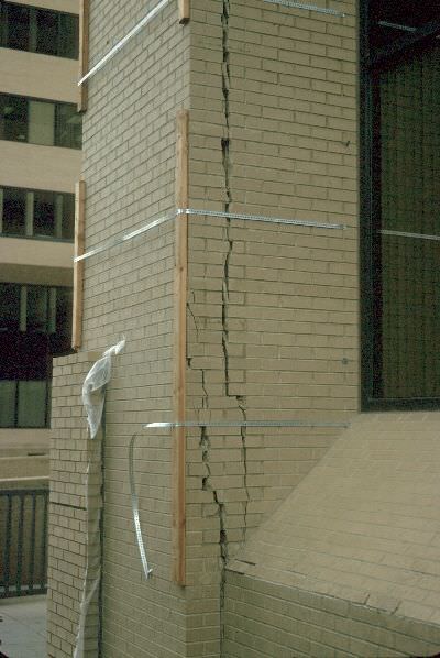

John Kogel Posted April 2, 2010 Report Share Posted April 2, 2010 This 30 year old steel and concrete 20 storey condo tower has brick veneer on three sides, glass on one side. It looks like weep holes were drilled as an afterthought. There were no weep holes visible at ground level, just up on the upper levels.There is a crack at the corner of the window. Is this big trouble or minor, typical settlement? The big crack is down between the first and second floors. Is it possible only the veneer is cracking and that the concrete column is ok? I should add we don't get big freezes up here, just high winds and an occasional tremor, so far, knock on wood, not brick. [] Click to Enlarge 61.2 KB Click to Enlarge 42.04 KB Click to Enlarge 49.3 KB Link to comment Share on other sites More sharing options...

mgbinspect Posted April 2, 2010 Report Share Posted April 2, 2010 John, Refer to a post I made in February of 2006, which will most likely put you on the right track. Since brick gets larger over time due to exposure to weather and moisture after leaving the kiln and concrete shrinks as it cures over the years, the brick is literally being squished away from the structure. That's why veneer on such buildings now is supported by a shelf angle attached to each floor and stops just short of the next shelf angle where a mastic expansion joint is formed to permit the concrete to shrink. As a mason, I was asked on several occasions to make repairs on such buildings and always declined. It's definitely one for a structural engineer and a proper fix ain't gonna be cheap. https://www.inspectorsjournal.com/forum ... erms=creep (If the vertical structure is steel, this post may not apply, but if the vertical structure is concrete, then it well may apply.) Link to comment Share on other sites More sharing options...

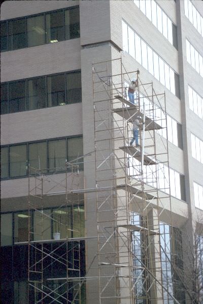

Garet Posted April 3, 2010 Report Share Posted April 3, 2010 That cracking looks remarkably like a case I saw about 15 years ago. Similar size building w/ brick veneer over concrete columns. Turns out the brick was self-supporting for 17 stories with no ledgers. After sitting there just fine for 20 years the brick finally decided the pressure was too much and started to buckle. Engineer had them start at the top floor and take out several adjacent bricks and install a short piece of ledger. Then they took out a few more bricks next to it and install another section of ledger. After completing a ledger on one floor they moved down and started all over again. The bottom section (where the cracking was bad) got completely torn off and rebuilt. The first photo shows temporary band-aid strapping as well as a test mock-up to verify color match. Click to Enlarge 50.03 KB Click to Enlarge 54.79 KB Link to comment Share on other sites More sharing options...
