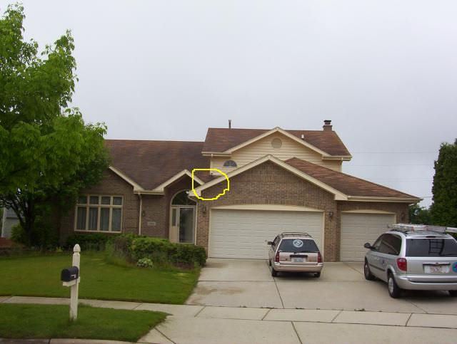

Mike Lamb Posted May 23, 2010 Report Share Posted May 23, 2010 Would the best maintenence for this valley flashing be prime and paint? Click to Enlarge 58.77 KB Link to comment Share on other sites More sharing options...
Phillip Posted May 23, 2010 Report Share Posted May 23, 2010 From what I can tell from the photo it is surface rust, so priming and painting it would be what I would recommend be done and have it replaced when the roof is replaced Link to comment Share on other sites More sharing options...
AHI in AR Posted May 23, 2010 Report Share Posted May 23, 2010 I think I'd favor an aluminized peel and stick material to cover it -- tucked as far under the bottom of the shingles as is possible. Link to comment Share on other sites More sharing options...
Jim Katen Posted May 23, 2010 Report Share Posted May 23, 2010 Would the best maintenence for this valley flashing be prime and paint? Personally, I wouldn't do a thing to it. That metal will still be fine long after the shingles are toast. - Jim Katen, Oregon Link to comment Share on other sites More sharing options...
ejager Posted May 24, 2010 Report Share Posted May 24, 2010 Certainly going to last longer than that fascia! Link to comment Share on other sites More sharing options...
Rocon Posted May 24, 2010 Report Share Posted May 24, 2010 What is causing the staining on the shingles above the flashing? Link to comment Share on other sites More sharing options...
Tom Raymond Posted May 24, 2010 Report Share Posted May 24, 2010 Do you have an establishing shot? Looking at that confluence/convergence/conflagration is making my head spin.[:-hypnoti Tom Link to comment Share on other sites More sharing options...

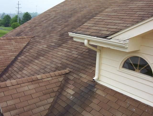

Mike Lamb Posted May 24, 2010 Author Report Share Posted May 24, 2010 What is causing the staining on the shingles above the flashing? Click to Enlarge 41.9 KB Click to Enlarge 64.32 KB Thanks for the comments. There was a downspout above the metal flashing but the staining is mostly from black algae. There were no stains at all on the south side of the roof. 15 year old roof. This is also an example where I think the dormer valleys should have been cut first even though the dormer has a steeper pitch. This was discussed in another thread recently. Link to comment Share on other sites More sharing options...
Tom Raymond Posted May 24, 2010 Report Share Posted May 24, 2010 This is also an example where I think the dormer valleys should have been cut first even though the dormer has a steeper pitch. This was discussed in another thread recently. Given that those shingles look as good as they do, I'd say that really wouldn't make too much difference. The 15 year old 3 tabs on my house are way worse than those. Tom Link to comment Share on other sites More sharing options...
hausdok Posted May 24, 2010 Report Share Posted May 24, 2010 What is causing the staining on the shingles above the flashing? The oxalic acid secreted by the algae. ONE TEAM - ONE FIGHT!!! Mike Link to comment Share on other sites More sharing options...
