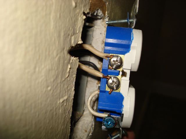

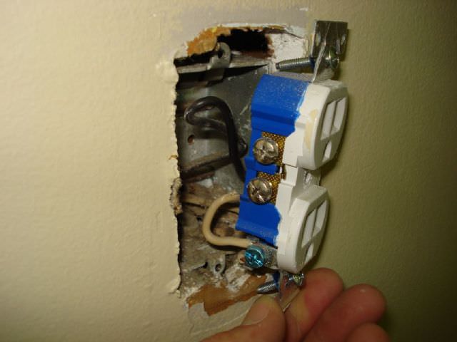

Marc Posted June 17, 2010 Report Share Posted June 17, 2010 For the record, can someone describe 'bootleg ground' and 'false ground'? The only terms I'm certaqin of are 'grounding connection present' and 'grounding connection not present'. Marc Link to comment Share on other sites More sharing options...
Richard Saunders Posted June 17, 2010 Report Share Posted June 17, 2010 Marc, they are talking about a jumper from the neutral terminal to the grounding terminal in the outlet so it tests as grounded but isn't. Link to comment Share on other sites More sharing options...
Richard Saunders Posted June 17, 2010 Report Share Posted June 17, 2010 I've never run into a GFCI breaker or outlet that was on a false ground circuit so I've never had the opportunity to test first hand. If the tester creates a fault or imbalance by shunting some of the current to a ground then it won't trip the GFCI if there's a false ground. The circuit remains balanced; the diverted current is still following its intended path. Makes sense. If a GFCI receptacle has a bootleg ground the tester will trip it but if the GFCI is downstream, the tester wont trip at a regular receptacle upstream with bootleg ground (as in Jim's scenario). Link to comment Share on other sites More sharing options...
Bain Posted June 17, 2010 Report Share Posted June 17, 2010 For the record, can someone describe 'bootleg ground' and 'false ground'? The only terms I'm certaqin of are 'grounding connection present' and 'grounding connection not present'. Marc This is a bootleg ground, Marc. Click to Enlarge 36.47 KB Click to Enlarge 35.68 KB Link to comment Share on other sites More sharing options...
Marc Posted June 17, 2010 Report Share Posted June 17, 2010 Got it. Thanks. Marc Link to comment Share on other sites More sharing options...
