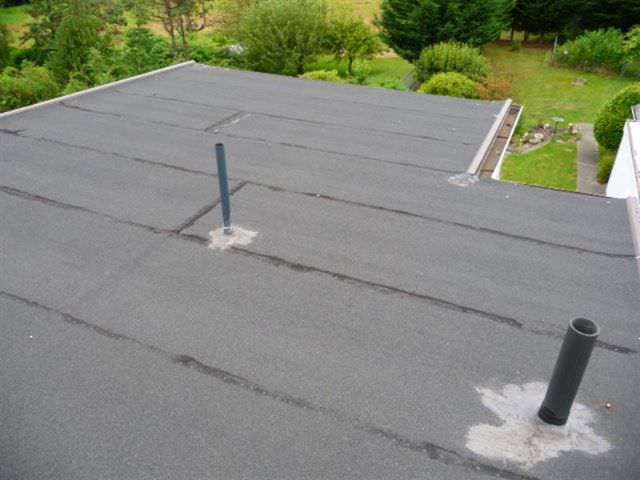

Robert Jones Posted July 20, 2010 Report Share Posted July 20, 2010 The seller's decided to get a roof cert prior to listing their home. For some reason the roofer would not "certify" the flat roof and actually recommended replacement. My bet is that he didn't even walk up to the flat roof area cause I see nothing wrong with it. He "certified" the shingles and wanted $1200 to replace the flat roof materials. Click to Enlarge 55.64 KB Click to Enlarge 47.03 KB Click to Enlarge 45.05 KB Link to comment Share on other sites More sharing options...
John Kogel Posted July 20, 2010 Report Share Posted July 20, 2010 I'll bet he didn't want to warranty those plumbing flashings. That's where the leaks will start. Since he wants to replace the plumbing flashings, well, might as well do it all over. Maybe he saw trouble where the roof joins the wall as well. Link to comment Share on other sites More sharing options...

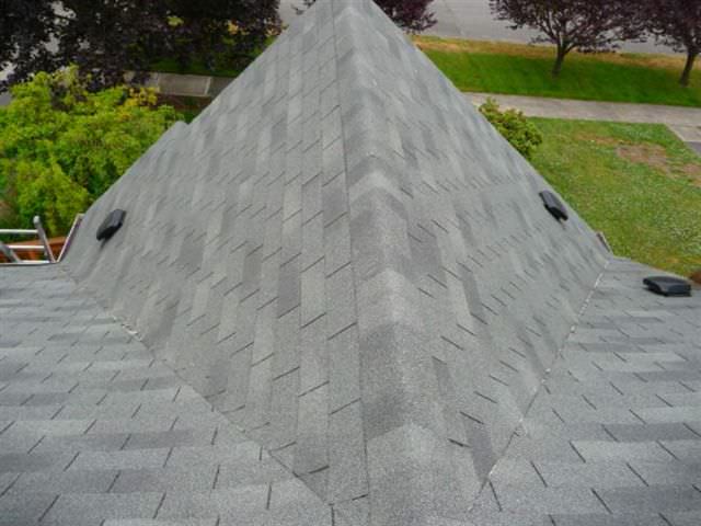

Neal Lewis Posted July 20, 2010 Report Share Posted July 20, 2010 Why do you suppose those roof vents are so low on the roof, rather up toward the ridge? Link to comment Share on other sites More sharing options...

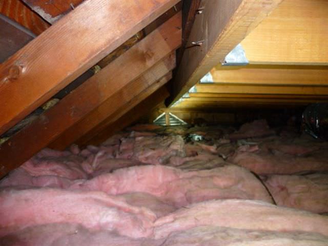

Robert Jones Posted July 20, 2010 Author Report Share Posted July 20, 2010 On the opposite(north) side, the vents are closer to the ridge. There were no soffits/eave vents installed as the home was 70 yrs old. The flat roof joined onto the top of the gabled roof as it was an addition. I have added a pic of the attic "cavity" where you can see, kinda, how it was tied in. I gave my clients the full run down on those plumbing boots and the chances for leaking and the need for periodic maintenance etc... Link to comment Share on other sites More sharing options...
John Kogel Posted July 20, 2010 Report Share Posted July 20, 2010 Thanks, Robert. In your attic pic, the heels of the old rafters are hanging below the ridge board, ridge board too narrow. Might have been too narrow for 70 years, good old Douglas fir. [] Link to comment Share on other sites More sharing options...

Robert Jones Posted July 20, 2010 Author Report Share Posted July 20, 2010 It was a bit tongue and cheek yes, but as far as the roofing material goes, it didn't appear to need replacement, in my opinion. The seams were well sealed, the boots around the vents were not deteriorated, and there was no granule loss on the asphalt roll roofing. What am I missing? Link to comment Share on other sites More sharing options...

Jim Katen Posted July 20, 2010 Report Share Posted July 20, 2010 It was a bit tongue and cheek yes, but as far as the roofing material goes, it didn't appear to need replacement, in my opinion. The seams were well sealed, the boots around the vents were not deteriorated, and there was no granule loss on the asphalt roll roofing. What am I missing? Well, there's the fact that it's asphalt roll roofing. You shouldn't use that stuff over a house -- or anything you want to remain dry for that matter. Just based on the pic you posted, I recommend tearing it off and replacing it. - Jim Katen, Oregon Link to comment Share on other sites More sharing options...
Brandon Whitmore Posted July 20, 2010 Report Share Posted July 20, 2010 I agree it has issues. Penetrations are wrong, perimeter flashing does not appear to be done right, and it looks like the overlying courses were face nailed-- am I seeing that correctly? Link to comment Share on other sites More sharing options...
Marc Posted July 20, 2010 Report Share Posted July 20, 2010 I think the nailing that is seen in the 2nd photo is how Jim figured out that it's roll roofing and not 'torch down'. Roll roofing belongs back on the vender's shelves where it can sit for eternity. Marc Link to comment Share on other sites More sharing options...

Robert Jones Posted July 21, 2010 Author Report Share Posted July 21, 2010 Ok, so I have humbled myself to my client, but I was always under the impression that roll roofing was Ok for flat to very low pitch roofs. Is it limited to garages and sheds? Link to comment Share on other sites More sharing options...
hausdok Posted July 21, 2010 Report Share Posted July 21, 2010 Hi Robert, While I don't like roll roofing any better than anyone else does, I have to disagree with the brethren when they say that any roll roofing is garbage. It is perfectly good for what it's designed to do and when installed correctly it works fine. When asphalt roofing was first invented and canvas roofs went out of favor it was a common alternative to wood shingles. Will it last as long as other types of roofs? No. Can it remain perfectly serviceable for six to ten years? Yeah, it can if it's properly maintained. The job is reporting current condition. If a component is being used in the correct application, is installed correctly, is functioning the way it's intended to function and is within the expected design life of the component we should be telling folks that, not condemning the product outright because we just don't like it. There's nothing wrong with letting folks know that a product is of lesser quality than what's typically/commonly used but that shouldn't change the facts of correct installation/functioning as intended/within it's normally expected service life. If the client wants to upgrade he/or she can always ask the seller to do so and if the seller refuses can pay to have it done; or, wait until it wears out and needs replacement. That said, that's some pretty abysmal vent flashing or lack of vent flashings there and that roof looks like it's less than 1:12. That stuff isn't supposed to be installed with concealed fasteners at less than 1:12 and with unconcealed fasteners at less than 2:12. What is the white stuff at the edges of the roof; is that gravel stop flashings? ONE TEAM - ONE FIGHT!!! Mike Link to comment Share on other sites More sharing options...
Marc Posted July 21, 2010 Report Share Posted July 21, 2010 I write up roll roofing where installed on dwellings everytime I see it, but that's only because the rows of fasteners are 3' apart with no other attachment in between. High winds from hurricanes cause it to lift off of the deck. If it doesn't tear off, it creases. Marc Link to comment Share on other sites More sharing options...
Robert Jones Posted July 21, 2010 Author Report Share Posted July 21, 2010 Thanks for the reply Mike. It was flashing on the edges, yes. While I knew it was an inferior product, I just couldn't see calling it out for replacement in it's current condition. It was a very small section of a roof that had been modified from the original state to allow for more headroom on at the second floor level. The flashing around the vents, was more of a "sealant" type material rather than a "boot". Link to comment Share on other sites More sharing options...
hausdok Posted July 21, 2010 Report Share Posted July 21, 2010 I write up roll roofing where installed on dwellings everytime I see it, but that's only because the rows of fasteners are 3' apart with no other attachment in between. High winds from hurricanes cause it to lift off of the deck. If it doesn't tear off, it creases. Marc Well, ensuring that it's installed with the rows running parallel to the prevailing winds and adding reinforcement strips perpendicular to the long axis of the material with double-rows of nails with fiber washers would improve performance. Hell, if you covered a roof with IWS and then applied a layer of that stuff over the top as UV protection it might perform as well or equal to modbit. Maybe not. Anyway, I won't be experimenting with it any time soon. This stuff is used plenty of places overseas still and seems to do a pretty good job where it's installed properly. We've essentially forgotten the old ways that worked so well for so long. ONE TEAM - ONE FIGHT!!! Mike Link to comment Share on other sites More sharing options...
Bill Kibbel Posted July 21, 2010 Report Share Posted July 21, 2010 I have never had a problem telling folks that this crap shouldn't have been installed on their house. On a few occasions, I've also been the one to discover roll roofing installed when "rubber roof" was on the invoice. There's a couple large inspection firms that bless this stuff as "common for city homes" and "performs well on low-slopes with an expected life of 15 years". Some of it is only smooth-surfaced roll roofing with a silver coating. When their clients become sellers, they're really pissed when the new buyer's inspector calls it out. I once had a document, from (I think) the Asphalt Roofing Manufacturers Assoc., that I used in litigation. It basically stated that asphalt roll roofing is intended for underlayment and flashing details on residential buildings. It also stated that mineral-surfaced roll roofing is only used as a primary roof on "secondary use" buildings. Link to comment Share on other sites More sharing options...
hausdok Posted July 21, 2010 Report Share Posted July 21, 2010 I have never had a problem telling folks that this crap shouldn't have been installed on their house. On a few occasions, I've also been the one to discover roll roofing installed when "rubber roof" was on the invoice. There's a couple large inspection firms that bless this stuff as "common for city homes" and "performs well on low-slopes with an expected life of 15 years". Some of it is only smooth-surfaced roll roofing with a silver coating. When their clients become sellers, they're really pissed when the new buyer's inspector calls it out. I once had a document, from (I think) the Asphalt Roofing Manufacturers Assoc., that I used in litigation. It basically stated that asphalt roll roofing is intended for underlayment and flashing details on residential buildings. It also stated that mineral-surfaced roll roofing is only used as a primary roof on "secondary use" buildings. So, if it's only allowed to be an underlayment, how do we reconcile it with IRC 905.5? OT - OF!!! M. Link to comment Share on other sites More sharing options...
Jim Katen Posted July 21, 2010 Report Share Posted July 21, 2010 . . . Will it last as long as other types of roofs? No. Can it remain perfectly serviceable for six to ten years? Yeah, it can if it's properly maintained. . . What's proper maintenance for roll roofing? - Jim Katen, Oregon Link to comment Share on other sites More sharing options...
