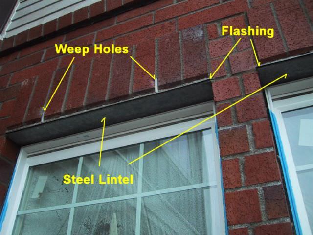

Mike Lamb Posted July 23, 2010 Report Share Posted July 23, 2010 Does anyone have a good shot of a steel lintel with weeps and flashing that looks like it was done right that I could use? I rarely take pictures of things that look like they have been done correctly. Quote Link to comment Share on other sites More sharing options...
kurt Posted July 23, 2010 Report Share Posted July 23, 2010 Click to Enlarge 50.82 KB You cut the plastic back when you're done. Quote Link to comment Share on other sites More sharing options...
Jim Katen Posted July 23, 2010 Report Share Posted July 23, 2010 Here's one. Galvanized steel lintel, stainless steel flashing, weeps with plastic inserts. - Jim Katen, Oregon Download Attachment: Window Flashing.JPG 135.33 KB Quote Link to comment Share on other sites More sharing options...
Mike Lamb Posted July 23, 2010 Author Report Share Posted July 23, 2010 These are good. I appreciate it. Quote Link to comment Share on other sites More sharing options...
Mike Lamb Posted July 23, 2010 Author Report Share Posted July 23, 2010 Kurt, do you have that in a higher resolution? I'm sending these to a client who needs lintel replacement and is fuzzy on the concept. Quote Link to comment Share on other sites More sharing options...
Mike Lamb Posted July 23, 2010 Author Report Share Posted July 23, 2010 I'm sending this to my client. Thanks, Jim. Click to Enlarge 62.26 KB Quote Link to comment Share on other sites More sharing options...
Darren Posted July 23, 2010 Report Share Posted July 23, 2010 Kurt, What happened to the bond? Quote Link to comment Share on other sites More sharing options...
kurt Posted July 24, 2010 Report Share Posted July 24, 2010 Kurt, What happened to the bond? It isn't there. Bodacious inertia holds stuff in place. I do have it in higher rez. Quote Link to comment Share on other sites More sharing options...
mgbinspect Posted July 24, 2010 Report Share Posted July 24, 2010 Kurt, What happened to the bond? It's hard for me to get used to this detail now too. Even when I laid brick on US Government and County schools, etc. we always stopped the flashings about a 1/2" short of the front of the bed joint. The only ones that knew the flashing was there was the one that designed it and the one who installed it. I asked the county about this detail and they simply said "This was the only way to confirm the flashing was really there." - kinda sad, but I understand. It sure is ugly though... Quote Link to comment Share on other sites More sharing options...
Tom Raymond Posted July 24, 2010 Report Share Posted July 24, 2010 I think Mike was wondering about the butt ugly expansion joint. Quote Link to comment Share on other sites More sharing options...
