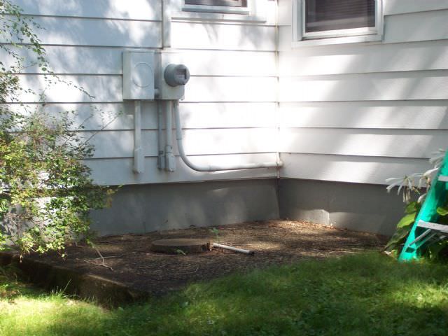

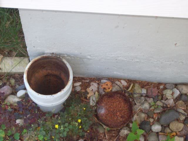

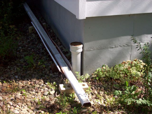

matto Posted September 1, 2010 Report Share Posted September 1, 2010 I came across these sewer standoffs at an inspection of a 75+ year old home. I was able to pop a lid and look down, I saw water and the depth looks at least 8 feet. I thought that these mayu have carried gutter runoff at one time but i am not sure. There is no discharge at the road but I guess it could discharge to the sewer lateral, which would be bad. There is also a large cistern well the exterior of the property and at first I thought that they may have feed that but I think they run too deep. Any thoughts???? Thanks, Matt I added a pic of the well Click to Enlarge 71.61 KB Click to Enlarge 36.59 KB Click to Enlarge 48.14 KB Click to Enlarge 57.16 KB Link to comment Share on other sites More sharing options...
mgbinspect Posted September 1, 2010 Report Share Posted September 1, 2010 I would also guess that it is an abandoned underground drainage system for the downspouts? When they fail, they can really cause problems with moisture intursion into the basement. Link to comment Share on other sites More sharing options...
Tom Raymond Posted September 1, 2010 Report Share Posted September 1, 2010 How old is the house? You mention a cistern and I see cast iron drains, but those things don't jive with the poured concrete foundation. At least not around here. Link to comment Share on other sites More sharing options...
Jim Katen Posted September 1, 2010 Report Share Posted September 1, 2010 I have no doubt that they were rain drains for the downspouts. They could have lead to the sanitary sewer, a storm sewer, a dry well, or a cistern. Ask an experienced inspector in your neighborhood; he'll probably know. In my area, they either lead to a dry well or to a sanitary sewer. For years, the City of Portland has been paying people $50 to disconnect their downspouts from the sewer drains because the stormwater often overburdens the sewage treatement facilities. When this happens, they seal the drains with a cap and a label that explains what was done. Something similar might be going on in your area, or the underground drains might have simply failed. Link to comment Share on other sites More sharing options...
