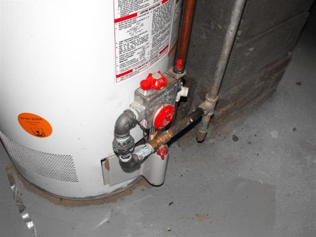

Les Posted September 9, 2010 Report Share Posted September 9, 2010 Am I just being picky? Seems everyone except me thinks this is just fine! Click to Enlarge 44.21 KB Click to Enlarge 26.06 KB Quote Link to comment Share on other sites More sharing options...
hausdok Posted September 9, 2010 Report Share Posted September 9, 2010 Hi Les, You'd think that they could have placed that tee about 10 inches higher and could have avoided that. It's an FVIR water heater with a sealed opening and a sight glass so there won't be any rollout that could damage the valve. I dunno, give the guy a Darwin award but unless that valve were subjected to rollout I guess it'd be OK. We don't have 'em like that around hee - too rigid - that's almost always a flexible stainless steel connector. ONE TEAM - ONE FIGHT!!! Mike Quote Link to comment Share on other sites More sharing options...
mgbinspect Posted September 9, 2010 Report Share Posted September 9, 2010 MLS marketing statement: Gas water heater with a pre-heated gas burning system and an 'ever-warm' emergency shutoff valve handle. This home is designed with both technology and every creature comfort in mind. Must see to believe!" Quote Link to comment Share on other sites More sharing options...
Mark P Posted September 9, 2010 Report Share Posted September 9, 2010 Seems there would be a concern with corrision going from galvanized to black iron to copper to galvanized. Is galvanized even an approved gas line anymore? I see it in old house, but never in new installs. Quote Link to comment Share on other sites More sharing options...
kurt Posted September 9, 2010 Report Share Posted September 9, 2010 He was working off the existing tee. It's an FVIR, don't know why it would be a problem other than displaying the guy's an idiot. Quote Link to comment Share on other sites More sharing options...
mgbinspect Posted September 9, 2010 Report Share Posted September 9, 2010 It is a lot of potential leak points right in front of the burner chamber. I suppose that's not the best arangement. I've found leaks many times on that stretch of supply line. Quote Link to comment Share on other sites More sharing options...
hausdok Posted September 9, 2010 Report Share Posted September 9, 2010 Again, As Kurt pointed out; it's an FVIR. That chamber is sealed with a door and has a little glass porthole to look through. Even if there were a gas leak, it wouldn't be exposed to the flame. There is no heat or flame there when you take the puff shield off. The air inlets for combustion on an FVIR are those perforations you see. ONE TEAM - ONE FIGHT!!! Mike Quote Link to comment Share on other sites More sharing options...
mgbinspect Posted September 9, 2010 Report Share Posted September 9, 2010 Padon' my little phone doesn't offer much of a photo and I thought you had aid "If" It was a sealed chamber. My bad. Quote Link to comment Share on other sites More sharing options...

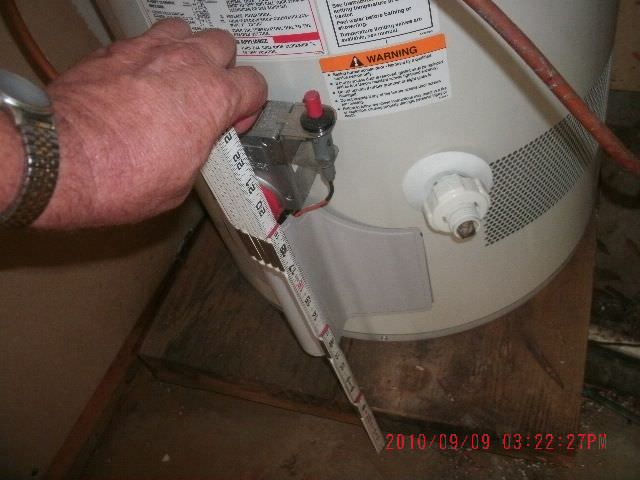

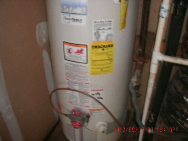

Phillip Posted September 9, 2010 Report Share Posted September 9, 2010 This is a FVIR but look at the label with the gas can and fumes. Click to Enlarge 34.08 KB I guess I'm being too picky. Click to Enlarge 47.36 KB Its in the garage closet Click to Enlarge 35.44 KB Yes I wrote up the missing pipe on the TPR valve. Quote Link to comment Share on other sites More sharing options...
Bain Posted September 9, 2010 Report Share Posted September 9, 2010 Seems there would be a concern with corrision going from galvanized to black iron to copper to galvanized. Is galvanized even an approved gas line anymore? I see it in old house, but never in new installs. It was banned here for several years, but now it's permissable, again. Don't know why. Quote Link to comment Share on other sites More sharing options...
Brandon Whitmore Posted September 9, 2010 Report Share Posted September 9, 2010 One way to try and get them to change it would be to write up the fact that the sediment trap is on the wrong side of the gas valve, at least according to recent standards. Since it is an FVIR water heater, I don't see a problem with the valve placement. Quote Link to comment Share on other sites More sharing options...
Tom Raymond Posted September 9, 2010 Report Share Posted September 9, 2010 There's enough fittings and nipples there to fix it. Might be faster and easier than writing it up. You do carry pipe dope, don't you?[:-dev3] Quote Link to comment Share on other sites More sharing options...
Richard Saunders Posted September 11, 2010 Report Share Posted September 11, 2010 Steel to copper and lack of a drip pan is what I'd write up,unless it was in a garage. Quote Link to comment Share on other sites More sharing options...
Les Posted September 11, 2010 Author Report Share Posted September 11, 2010 Richard, Regional differences. I review abt 1,000 inspections each year and see only 3-4 drip pans. Quote Link to comment Share on other sites More sharing options...
