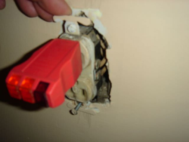

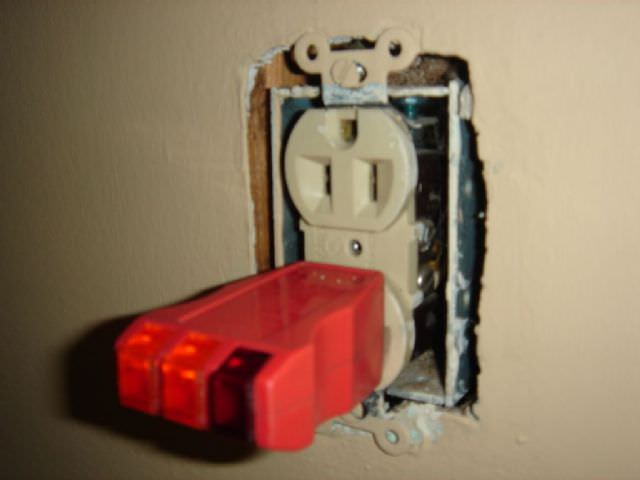

Bain Posted September 9, 2010 Report Share Posted September 9, 2010 I checked out a pre-1960s house today, and noticed there were very few ground wires on the terminal bar. But when I began checking outlets, many newer ones designed for three-prong plugs were showing positive for grounds. My first thought was that there must be bootleg grounds, but when I removed a few cover-plates, there were no wires at all on the grounding screws. Interestingly, when I began removing the screws that secure the outlets to the junction boxes, the tester flickered and registered open grounds. I assume this means someone grounded (or bonded) the j-boxes to the pipes or something else, and that's why the tester was fooled. I was in the crawlspace before I checked out the interior of the house, but don't remember seeing any dangling wires that might have been used for grounds. IF the junction boxes were grounded, DOES that constitute a LEGITIMATE ground? Or might there have been something else going on that I missed or that I'm not hip to? The photos are a little out of focus, but you can see the wireless grounding screws at the upper rights of the outlets. Click to Enlarge 26.8 KB Click to Enlarge 20.59 KB Link to comment Share on other sites More sharing options...

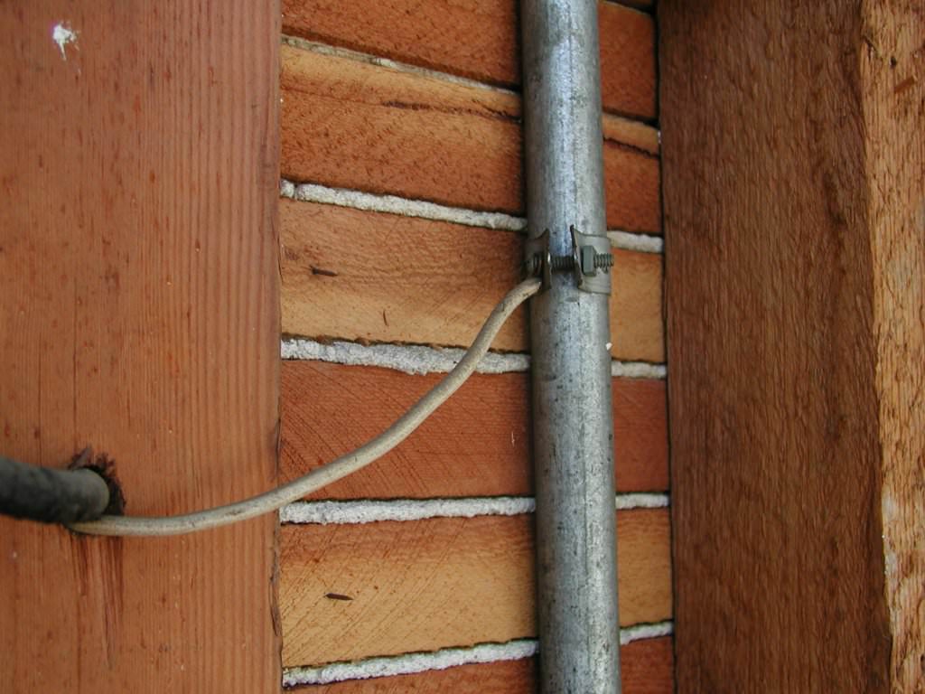

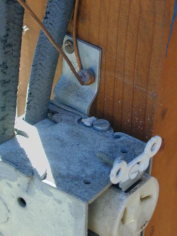

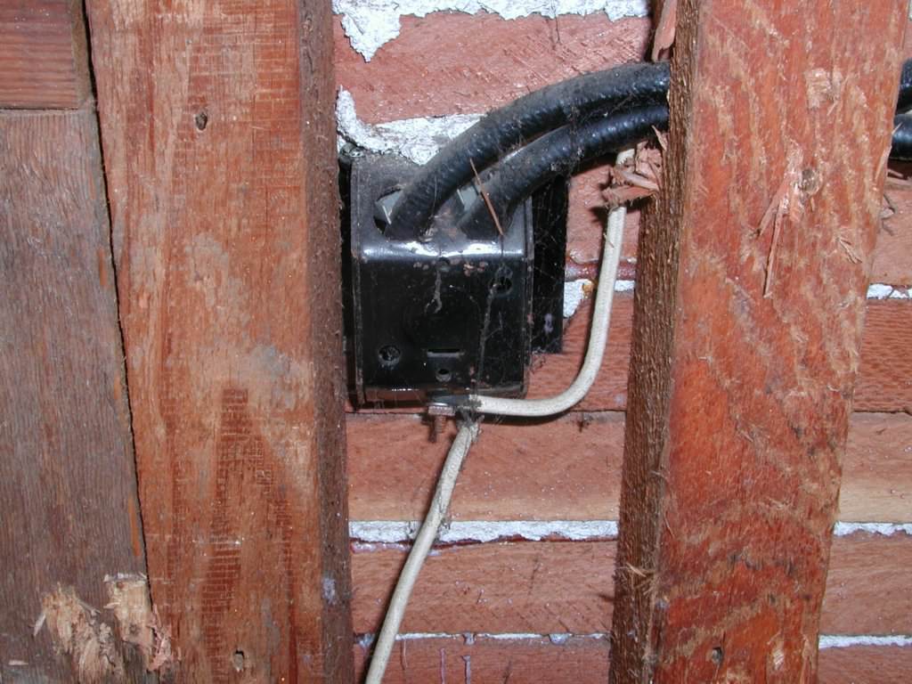

Jim Katen Posted September 10, 2010 Report Share Posted September 10, 2010 I remember hearing about a pre-1960s grounding method that was local to some particular area back east. I don't remember where. It consisted of running a thin bare wire, similar to stone wire, from one metal box to the next along the surface of the studs. As I recall, it was one of those peculiar regional things. Anyone else remember that? - Jim Katen, Oregon Link to comment Share on other sites More sharing options...
Bill Kibbel Posted September 10, 2010 Report Share Posted September 10, 2010 I remember hearing about a pre-1960s grounding method that was local to some particular area back east. I don't remember where. It consisted of running a thin bare wire, similar to stone wire, from one metal box to the next along the surface of the studs. As I recall, it was one of those peculiar regional things. Anyone else remember that? Levittown, PA, built in the early through mid '50s. Each house had to be built in one day and 40 houses were completed every day. Link to comment Share on other sites More sharing options...
kurt Posted September 10, 2010 Report Share Posted September 10, 2010 All other considerations being satisfactory, that'd work, wouldn't it? Link to comment Share on other sites More sharing options...
Tom Raymond Posted September 10, 2010 Report Share Posted September 10, 2010 Sure it would, but today it would violate that pesky 'all conductors of a circuit must run together' rule. Sorry Jim, I haven't memorized the NEC yet. Link to comment Share on other sites More sharing options...
Douglas Hansen Posted September 10, 2010 Report Share Posted September 10, 2010 Prior to the use of plastic or bakelite boxes, it was pretty common to see metal boxes grounded by some other means than the wiring method. Since at least 1923, the NEC required all metal boxes to be grounded, then gave exemptions for those which had some requisite distances from other grounded objects. The net effect of the rule - at least around here - was to find that the boxes in bathrooms, kitchens, laundry rooms, and some exterior locations would be "grounded." Woody and I like to refer to this method as "nail to nail" grounding, since it typically involved whatever wire was handy being looped around the box mounting nails, then eventually being wrapped or clamped to a water pipe. It does seem likely there would be regional variations on this theme. It did still take place in the 1950's with rag-wrap romex. It raises interesting questions for code compliance. Whenever we replace a receptacle in a location where a grounding means exists, we are supposed to use a grounding type receptacle and utilize that grounding means. Ordinary receptacles don't quite qualify, since the mounting screws are not intended as a grounding means unless they are "self grounding" receptacles with one screw captive in a metal washer secured to the yoke. The other side we could question is whether that grounding means is really effective. It isn't going to be the low-impedance path or the method that would be used today, though it is better than nothing. Click to Enlarge 35.24 KB Download Attachment: 250G-130c_N2H2o.jpg 153.28 KB Download Attachment: 250G-130cNtoN.jpg 201.02 KB Link to comment Share on other sites More sharing options...

Bain Posted September 10, 2010 Author Report Share Posted September 10, 2010 That makes perfect sense, Douglas. Thanks. Regarding the effectiveness of the grounds, I opted to leave that up to someone else. I seldom refer out to others, but did on this house RE the grounds that I didn't understand. Link to comment Share on other sites More sharing options...
