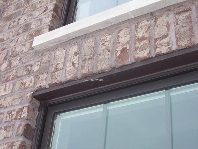

Ben H Posted December 20, 2010 Report Share Posted December 20, 2010 What's the deal behind the solider coarse with no support? Half the house had lintels, the other half didn't. Lame mason? Click to Enlarge 46.98 KB Link to comment Share on other sites More sharing options...

Ben H Posted December 20, 2010 Author Report Share Posted December 20, 2010 So you run a piece of re-bar through the brick to hold it into place while the mortar sets? I'm assuming this is only allowed in this situation, meaning not bearing any more weight than it's own. I'll bet your right Bill. Total of 6 windows, all the soldiers waved at you as you walked by. What did they REALLY do? Plywood support while the mortar set? Link to comment Share on other sites More sharing options...
mgbinspect Posted December 20, 2010 Report Share Posted December 20, 2010 Looking at the pic, it's probably not installed like this: Click to Enlarge 3.66 KB Interesting detail... The rendering really appears to show a typical 10" or 12" concrete block, given away by the slot in the middle, which permits a mason to easily cut the unit into half units with a brick hammer or chisel. Yet, the text identifies it as a brick. I never ran across a brick with such a generous core. That is indeed a lame installation. Fortunately, it's just the one soldier course and it's not structural. It appears that, if one pulls the frieze board, the soldier will fall right out of the wall. Nice! I fear there are no true masons left.... Link to comment Share on other sites More sharing options...
Ben H Posted December 20, 2010 Author Report Share Posted December 20, 2010 Another thought I had was the windows are nail flange style and where installed first. The brick was then installed on top of the window frame, using it as a shelf.... just a WAG though. Link to comment Share on other sites More sharing options...

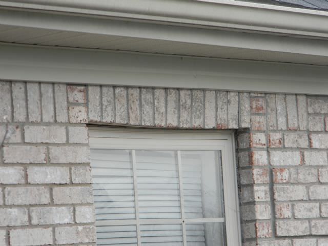

Bain Posted December 20, 2010 Report Share Posted December 20, 2010 I see it all the time, Ben. The reasons why are plain ol' ineptitude and laziness. Click to Enlarge 52.65 KB Link to comment Share on other sites More sharing options...
mgbinspect Posted December 20, 2010 Report Share Posted December 20, 2010 So you run a piece of re-bar through the brick to hold it into place while the mortar sets? I'm assuming this is only allowed in this situation, meaning not bearing any more weight than it's own. I'll bet your right Bill. Total of 6 windows, all the soldiers waved at you as you walked by. What did they REALLY do? Plywood support while the mortar set? Back in my masonry days, even with a lintel present, the frieze was almost always in place, which was nice, because you could slide the brick up in behind the board to rest tightly against it, which made for a nice tight fit. But, we'd have NEVER installed brick on a window head without support. Even the formal request to do so would have been met with bewilderment and vehement resistance. Link to comment Share on other sites More sharing options...

Ben H Posted December 20, 2010 Author Report Share Posted December 20, 2010 Not to re-hi-jack the thread What would you chaps write up about said missing lintel? I took the easy way out on this one and called for a mason, but what would you say? Link to comment Share on other sites More sharing options...
mgbinspect Posted December 20, 2010 Report Share Posted December 20, 2010 Me personally, I'd disclose it as an unconventional brick veneer installation - not a structural issue - just a really lousy veneer job. As long as the frieze isn't remover, the brick's not going anywhere, and since it (the brick) bears no weight, repairs or modifications aren't paramount and will become more of an eye-sore than the existing condition. It's unfortunate, but not a threat to structure or safety concern. (Maybe when I see a bigger picture of it than on my phone, I might change my mind about the threat to safety) In short, I'd fully disclose it as what it is: a cosmetic mess; an improper use of materials; a bad detail; all pretty much cosmetic. Link to comment Share on other sites More sharing options...
Bain Posted December 20, 2010 Report Share Posted December 20, 2010 Me personally, I'd disclose it as an unconventional brick veneer installation - not a structural issue - just a really lousy veneer job. As long as the frieze isn't remover, the brick's not going anywhere, and since it (the brick) bears no weight, repairs or modifications aren't paramount and will become more of an eye-sore than the existing condition. It's unfortunate, but not a threat to structure or safety concern. (Maybe when I see a bigger picture of it than on my phone, I might change my mind about the threat to safety) In short, I'd fully disclose it as what it is: a cosmetic mess; an improper use of materials; a bad detail; all pretty much cosmetic. Well, but I see this mistake fairly often, Mike, and lots of times the bricks are loose and can be moved by hand. Look at the upper/right corner of Ben's photo. The mortar's cracked and I'll bet the brick is loose. I ALWAYS say this should be repaired. Link to comment Share on other sites More sharing options...
mgbinspect Posted December 20, 2010 Report Share Posted December 20, 2010 Me personally, I'd disclose it as an unconventional brick veneer installation - not a structural issue - just a really lousy veneer job. As long as the frieze isn't remover, the brick's not going anywhere, and since it (the brick) bears no weight, repairs or modifications aren't paramount and will become more of an eye-sore than the existing condition. It's unfortunate, but not a threat to structure or safety concern. (Maybe when I see a bigger picture of it than on my phone, I might change my mind about the threat to safety) In short, I'd fully disclose it as what it is: a cosmetic mess; an improper use of materials; a bad detail; all pretty much cosmetic. Well, but I see this mistake fairly often, Mike, and lots of times the bricks are loose and can be moved by hand. Look at the upper/right corner of Ben's photo. The mortar's cracked and I'll bet the brick is loose. I ALWAYS say this should be repaired. Agreed. If it's a danger, that changes everything. I'm just not a "it's wrong fix it guy." when it comes to masonry, that can land you in the immortal home inspector category, as folks say, "My God! What happened to your brickwork?" and the owner responds, "This was my home inspector's idea of a necessary repair." ... Oops... In ALL situations similar to this one (cosmetic more than a real problem), I begin with a verbal discussion, like my previous post - essentially "it is what it is". Then, after being the voice of education and reason, I ask my client, "Where do you wish to go with this?" I honor my client's desire in cases like this. Link to comment Share on other sites More sharing options...
robert1966 Posted December 27, 2010 Report Share Posted December 27, 2010 I have seen similar situations with no lintel or decayed metal lintels, all resulting if sagging as seen in your photo. Link to comment Share on other sites More sharing options...

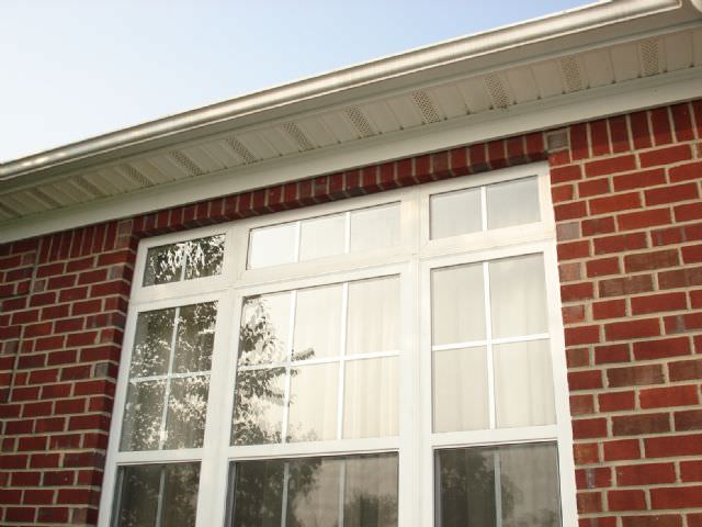

Mike Lamb Posted December 28, 2010 Report Share Posted December 28, 2010 This is new construction. There may be an unsupported lintel here or maybe no lintel at all. The soldiers may be a RBM lintel as in Bill K's diagram or maybe not. And then a sweet caulk job on top of it all. Click to Enlarge 51.55 KB Link to comment Share on other sites More sharing options...
mgbinspect Posted December 28, 2010 Report Share Posted December 28, 2010 This is new construction. There may be an unsupported lintel here or maybe no lintel at all. The soldiers may be a RBM lintel as in Bill K's diagram or maybe not. And then a sweet caulk job on top of it all. Click to Enlarge 51.55 KB Based upon that one picture, I believe that's probably a steel hung plate affair. The reason for the offset in coursing is that those aren't "standard" brick (3 courses for 8"). They appear to be modular brick (5 courses in 16") - hated them. Lol... (They're designed for production and reduce installation labor by approximately twenty percent. I saw them most in warehouses, schools, shopping centers, etc.). I have real problems with wrapping and sealing support steel that's integral with masonry - ALWAYS a REALLY BAD IDEA, in my opinion. The masonry holds moisture which will condensate and linger on that cold steel to accelerate rust. Give that detail a few years and open it up to find a real disaster in the making - a lot of the same dynamics that go into Kurt's reason not to flash the backside of parapets. Link to comment Share on other sites More sharing options...
