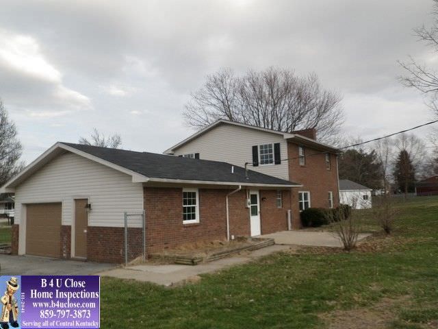

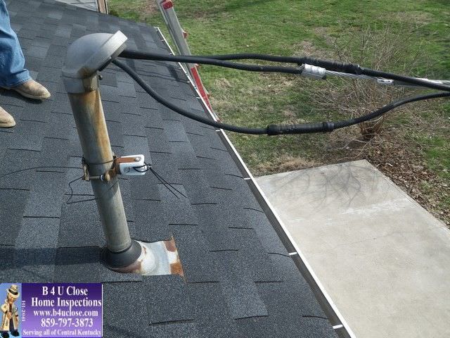

Erby Posted March 5, 2011 Report Share Posted March 5, 2011 Did a foreclosure today that had been vacant with the power off for over a year. The local utility wouldn't turn the power back on until the electrical system had been inspected by the local AHJ, so it was, just a few days ago according to the sticker on the electrical panel. I guess they overlooked the fact that the support cable from the neutral to the mast had broken. All the weight was on the neutral's electrical spice. Click to Enlarge 53.44 KB Click to Enlarge 84.66 KB Quote Link to comment Share on other sites More sharing options...
plummen Posted March 5, 2011 Report Share Posted March 5, 2011 Once it leaves weather head the power co should have resecured it to mast Quote Link to comment Share on other sites More sharing options...
Erby Posted March 5, 2011 Report Share Posted March 5, 2011 Well golly, Jim. I wonder why they didn't think of that! Quote Link to comment Share on other sites More sharing options...
