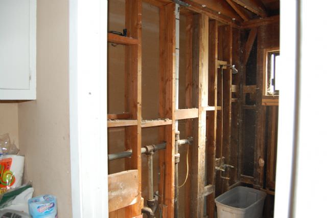

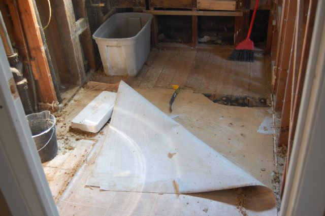

antnida Posted September 11, 2011 Report Share Posted September 11, 2011 We just bought this house that was build in the 60's, pretty much rip it down to the studs since there was no insulation in the wall and a lot of items that needed to be updated. We will start with the bathroom remodeling first. I'll be installing non faced insulation in all the wall of the bathroom followed by a vapor barrier, the bathroom wall is going to be 3 pieces of cultural marble (Marblestone). I'll be using durock or similar product (doesn't look like home depot or lowes carry durock) for area where the shower walls and 5/8" green sheetrock for everywhere else My question is do I insulate all the wall down the wall around the tub or just to the lip of the tub only? As for the ceiling, do I install faced or non faced insulation? One more question that does not related to insulation, is the bathroom's sub floor, right now it's 2x6, should I add a layer of plywood before putting down a layer of cement board for tile on the floor area? Thanks Click to Enlarge 42.01 KB Click to Enlarge 36.17 KB Click to Enlarge 36.24 KB Quote Link to comment Share on other sites More sharing options...
Marc Posted September 11, 2011 Report Share Posted September 11, 2011 My question is do I insulate all the wall down the wall around the tub or just to the lip of the tub only? All the way down the wall. Otherwise your insulation envelope will have a big hole in it behind the tub. As for the ceiling, do I install faced or non faced insulation? Faced. 'Faced' means that it has a vapor barrier on it, which you should have to retard the flow of moisture from the bathroom interior to the attic space. One more question that does not related to insulation, is the bathroom's sub floor, right now it's 2x6, should I add a layer of plywood before putting down a layer of cement board for tile on the floor area? I see no reason for that. You do understand the difference between 'floor joist' and 'subfloor' do you? 2X6 is a common size of lumber for joists but I've never seen it installed as subfloor. Subfloor is usually 1X planks or 3/4 plywood. Marc Quote Link to comment Share on other sites More sharing options...
kurt Posted September 11, 2011 Report Share Posted September 11, 2011 Marc alludes to my concern.......i.e.....you don't know enough terms for anyone to provide good direction without writing a how to manual. All the big boxes carry durock; maybe they're out. Quote Link to comment Share on other sites More sharing options...
Jim Katen Posted September 11, 2011 Report Share Posted September 11, 2011 Kurt & Marc are forgetting that in the west coast states 2x6 subflooring was the dominant floor framing model for a long time and, in some areas, still is. How far apart are the girders under your subflooring? That will determine how stiff the floor is and whether or not it would be a good idea to add plywood. Quote Link to comment Share on other sites More sharing options...
kurt Posted September 11, 2011 Report Share Posted September 11, 2011 Forget? Heck, I didn't know. Quote Link to comment Share on other sites More sharing options...
Marc Posted September 11, 2011 Report Share Posted September 11, 2011 I'll be dang. How do you figure deflection where the joists are 2X members laid broadside? Marc Quote Link to comment Share on other sites More sharing options...
Jim Katen Posted September 11, 2011 Report Share Posted September 11, 2011 I'll be dang. How do you figure deflection where the joists are 2X members laid broadside? Marc Well, you could use IRC Table 503.1, but around here we pretty much just put it on girders spaced 4'0" on center and it's fine. You're supposed to use T&G material but it usually shrinks so much that the tongues don't end up sitting in the grooves very well anyway. I regularly see square-edged stock in 2x6, 2x8, & 2x10 sizes. Makes for a nice solid floor. Quote Link to comment Share on other sites More sharing options...
randynavarro Posted September 12, 2011 Report Share Posted September 12, 2011 I don't run any calc's but I do do the highly scientific tests on floors sometimes. . . I bounce on them. The 2 x 6 T&G "car decking" subfloors hardly ever rattle the dining room table. "Modern" system usually do. Jim mentioned girders on 4' centers. I often seem them on 5' or 6' centers. Quote Link to comment Share on other sites More sharing options...
randynavarro Posted September 12, 2011 Report Share Posted September 12, 2011 Oh. . . the original poster's questions . . . Insulation all the way to the floor. If you don't want to investigate if your floor is stiff enough, add a layer of 5/8" or 3/4" plywood, then cement backer. Make sure you'll be ok with the lip on the floor created by the added plywood though. Vapor retarder/barrier. . . ? That's a bit more tricky. . . go to buildingscience.com. I'm sure they've got a good wall detail for your climate. Quote Link to comment Share on other sites More sharing options...
Jim Katen Posted September 12, 2011 Report Share Posted September 12, 2011 . . . Jim mentioned girders on 4' centers. I often seem them on 5' or 6' centers. . . Most of what I see is hemlock and it's only supposed to span 4'. You're allowed to go up to 5' if you use fir. It's never supposed to exceed a 5' span. Of course, I see it done occasionally out in the sticks and across the river in . . . ahem . . . Washington State. Quote Link to comment Share on other sites More sharing options...

SNations Posted September 13, 2011 Report Share Posted September 13, 2011 We will start with the bathroom remodeling first. I'll be installing non faced insulation in all the wall of the bathroom followed by a vapor barrier, Just curious, but why are you going to use unfaced insulation and then add a vapor barrier? Why not just faced insulation? And what kind of vapor barrier to you plan to use? A couple of weeks ago someone had a very similar issue and I recommended using closed cell spray foam at the exterior walls of the bathroom. Sacramento might be too mild of a climate to make this worthwhile, though. Check out the July 2011 issue of the Journal of Light Construction and look for an article titled "Energy Retrofit in Stages." Quote Link to comment Share on other sites More sharing options...
antnida Posted September 13, 2011 Author Report Share Posted September 13, 2011 Thanks you everyone for helping out, with today economic state we just afford to hire a contractor for this remodeling task being handy around the house I just have to do a lots of reading, ask questions and do my best I haven't got a chance to go down to the sub floor to measure how far apart are the griders as of yet, too bz tearing down all the sheet rock, no insulation on any of the walls there are very fine one on the ceiling though. I understand the differences between floor joists and subfloors, just haven't seen one that did it with 2x6 vs plywood. Talking about plywood, there aren't any on the exterior wall either, doesn't looks like it required in the 60's. Going back to the insulation and vapor barrier for the bathroom, if I were to use unfaced insulation with vapor barrier then the material for the vapor barrier would be Certainteed MemBrain. Looks like at this point I will be installing faced insulation for all exterior walls and unfaced for interior walls. As for the bathroom floor, I'll just install cement board and tile over it. I'll post some pictures once insulation is completed. Thanks Tony Quote Link to comment Share on other sites More sharing options...
Jim Katen Posted September 13, 2011 Report Share Posted September 13, 2011 . . . As for the bathroom floor, I'll just install cement board and tile over it. I'll post some pictures once insulation is completed. If you do that, re-secure every piece of 2x6 with two screws at every girder. Then install your backer board in a layer of thinset that you apply with a 1/4x1/4 notched trowel. Screw it down every 6" in both directions with the proper screws. If you find that the girders are more than 4' apart, I'd add a layer of plywood. Quote Link to comment Share on other sites More sharing options...
