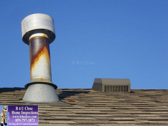

Erby Posted January 4, 2012 Report Share Posted January 4, 2012 What do you tell people when you see the flue rusted like this? Click to Enlarge 45.44?KB Two story house with the furnace & water heater in garage closets. Both 18 years old. Induced draft fan at furnace. Link to comment Share on other sites More sharing options...
Bain Posted January 4, 2012 Report Share Posted January 4, 2012 I just tell people what's up, and to keep an eye on the flue pipe. It's likely 18 years old, as well, and the zinc coating has eroded away from the galvanized metal, so it's rusting. It could be fine for several more years . . . or not. Painting, clearly, is not an acceptable repair method. : ) Click to Enlarge 88.15 KB Link to comment Share on other sites More sharing options...
ericwlewis Posted January 4, 2012 Report Share Posted January 4, 2012 [ Painting, clearly, is not an acceptable repair method. : ) Click to Enlarge 88.15?KB Are you sure this isn't just camo like on a sub periscope? [:-bigeyes Link to comment Share on other sites More sharing options...
Jerry Simon Posted January 4, 2012 Report Share Posted January 4, 2012 What do you tell people when you see the flue rusted like this? Click to Enlarge 45.44?KB Two story house with the furnace & water heater in garage closets. Both 18 years old. Induced draft fan at furnace. I always probe them. If they feel solid, I don't mention it. Link to comment Share on other sites More sharing options...
hausdok Posted January 4, 2012 Report Share Posted January 4, 2012 There's an exhaust gas bouyancy issue. Single-walled connector in cold space, too many bends in that flue, wrong-sized flue pipe, etc. - something that's causing those gases to cool too quickly, lose bouyancy and stall as they leave the vent. The acidic steam settles around that vent and strips the galvanizing. It also degrades the vent, causes so much mineral salt to form and fall out of the base of the vent that it looks like it's snowing inside the appliance and it can trash the exchanger. If there's an elbow directly below the roof plane, as there often is, there's probably condensate dripping off the elbow onto the insulation. Or,.......it's just old as hell and wearing out. When I see those I'll normally walk over to the vent and feel the pipe to see if it's still got a substantial amount of steel left or if it's already paper thin and cracked or about to crack. Often find cracks. Sometimes holes. Sometimes the entire outside of the vent will be eaten away and what you can see from the ground is the liner. Drive down a city street and look at the condition of those vents and you can identify from the street those houses where furnaces or boilers have an issue with weak exhaust gas bouyancy and could have vent or H.E. issues. Got a phone call from an HVAC firm a couple of months ago after I'd called a vent after seeing this and checking the vent. Thought he was calling me to argue with me about something. Nah, he was calling to tell me that he was taking the unusual step of calling a home inspector to compliment him for being the first inspector he's ever known that's savvy enough about furnace vent issues to recognize this as an issue. Told him he should get out more; this is inspector 101 stuff. He disagreed, said it can't be or he'd get called out for it more. Says it's HVAC 101 stuff but the majority of folks in his business don't get it or they ignore it. That explains why I find so many new furnaces with vents that look like that and when I get up on the roof to check them out I find them cracked, holed or ready to fail. ONE TEAM - ONE FIGHT!!! Mike Link to comment Share on other sites More sharing options...
John Dirks Jr Posted January 7, 2012 Report Share Posted January 7, 2012 I say the following. The flue pipe is rusting above the roof line. Rusting metal will eventually get holes in it. The holes can allow water intrusion that can damage the buildings materials. Have the rusted flue pipe replaced. Link to comment Share on other sites More sharing options...

Marc Posted July 24, 2016 Report Share Posted July 24, 2016 Repair of gas vent is done by replacement. The inspector may have called for replacement not because of a little rust but because the pipe was single-wall pipe. Single wall is a lousy choice in most places now. Just about all new installations use B-vent (double-wall) pipe. No one knows for sure how long it will last. We don't carry crystal balls in our tool pouch. Marc Link to comment Share on other sites More sharing options...
