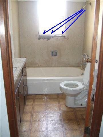

Denray Posted January 20, 2012 Report Share Posted January 20, 2012 Going to cost to repair. This shows up every once in a while. Click to Enlarge 26.9 KB Quote Link to comment Share on other sites More sharing options...
Erby Posted January 20, 2012 Report Share Posted January 20, 2012 See it on a lot of older homes that were built before showers came around and then a shower was added. It was cool when it was just a bathtub under a window. Not so cool when you start spraying water all over it from the shower. Quote Link to comment Share on other sites More sharing options...
Denray Posted January 20, 2012 Author Report Share Posted January 20, 2012 I saw it on a remodel once where the tile on the sill was sloped towards the window. I always carry around a marble with me for just such an occasion. P.S. it's finally raining out here on the NW coast of CA. Quote Link to comment Share on other sites More sharing options...
Mike Lamb Posted January 21, 2012 Report Share Posted January 21, 2012 I think this stupid design with a nice big window above the tub (where else you gonna put it?) went all the way into the early 60's when a shower was certainly expected with a tub. I tell clients to get another shower curtain to pull across the window or face misery. Quote Link to comment Share on other sites More sharing options...
Erby Posted January 21, 2012 Report Share Posted January 21, 2012 It wasn't a stupid design when they did it. The window was the ventilation. Didn't have bath fans back then. Quote Link to comment Share on other sites More sharing options...
plummen Posted January 21, 2012 Report Share Posted January 21, 2012 Yeah I tell people to get an extra rod and a shower curtain also,and to open the curtain when not using the shower to keep area dried out Quote Link to comment Share on other sites More sharing options...
ericwlewis Posted January 21, 2012 Report Share Posted January 21, 2012 wouldn't it be required to be safety glass or is this one "grandfathered in"? Quote Link to comment Share on other sites More sharing options...
Jim Katen Posted January 21, 2012 Report Share Posted January 21, 2012 wouldn't it be required to be safety glass or is this one "grandfathered in"? I always recommend installating safety glass in these. Don't know about "required." Quote Link to comment Share on other sites More sharing options...
