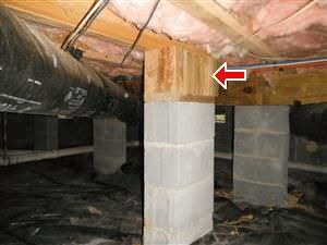

Mourad Posted March 6, 2012 Report Share Posted March 6, 2012 Hi All, I just had a home inspection report pointing out an issue with the house foundation as described by the inspector: "The piers in the crawlspace have excessive shimming on top of the block pier. This can be subject to compression or deterioration". Please see attached pictures. Click to Enlarge 13.84 KB Click to Enlarge 12.1 KB The house is not that old (2006) and was built by a known national builder. It has no cracks or any other foundation issues. Could you please help me assess the severity of such issue? Link to comment Share on other sites More sharing options...
Brandon Whitmore Posted March 6, 2012 Report Share Posted March 6, 2012 The 2x "shims" won't compress any more than the framing they are supporting. In earthquake country, this wouldn't be allowed. Link to comment Share on other sites More sharing options...
Mourad Posted March 6, 2012 Author Report Share Posted March 6, 2012 Thanks Brandon, So you don't think that this is something that needs to be addressed (replaced?). Link to comment Share on other sites More sharing options...
Jim Baird Posted March 6, 2012 Report Share Posted March 6, 2012 From the '06 IRC: R606.6.1 Pier cap. Hollow piers shall be capped with 4 inches (102 mm) of solid masonry or concrete or shall have cavities of the top course filled with concrete or grout or other approved methods. That stack of lumber will compress some. How much? It's hard to say. If the pier is hollow and you are in NC, it could serve as a termite highway into the structure, as routine termite inspection can't see inside the pier. It is certainly sloppy, lazy, workmanship. Just because a builder is a "national" builder it doesn't mean he's better than anybody else. I would rather have something built by a one-at-a-time local builder who takes pride in his work. Link to comment Share on other sites More sharing options...

Tom Raymond Posted March 6, 2012 Report Share Posted March 6, 2012 The math is off. There's 9" of lumber there, an 8" block would fall short. I agree that it's sloppy, but I'd be far more concerned by the hole in the VB in the first pic and the lack of capillary breaks and termite shields at the tops of the piers. Link to comment Share on other sites More sharing options...
Marc Posted March 6, 2012 Report Share Posted March 6, 2012 I'm not aware of a provision by any prescriptive building method that allows different materials to be alternated within the construction of a single pier. Marc Link to comment Share on other sites More sharing options...

leeboy Posted March 6, 2012 Report Share Posted March 6, 2012 How is it different that a concrete pier and a 6x6 post for example, The grain is horizontal as oppose to vertical which may mean more shrinkage, besides that if it has a footing, I dont see a problem with it. It is also carrying a load through an I joist close the wall. Link to comment Share on other sites More sharing options...
Jim Katen Posted March 6, 2012 Report Share Posted March 6, 2012 Hi All, I just had a home inspection report pointing out an issue with the house foundation as described by the inspector: "The piers in the crawlspace have excessive shimming on top of the block pier. This can be subject to compression or deterioration". Please see attached pictures. The house is not that old (2006) and was built by a known national builder. It has no cracks or any other foundation issues. Could you please help me assess the severity of such issue? It's severely stupid. The crew that did that were morons. The issue isn't compression. The shim's won't "compress" under the load of a smaller member above them. However, they will change in dimension as a result of shrinkage. During the first few months after they were placed, they probably shrank significantly and allowed the structure above them to move as well. There might be seasonal movement as the humidity in your crawlspace increases and decreases throughout the year and the shims expand and contract in response - perhaps as much as 1/4". This "pumping" action can cause problems with your finish flooring and it can lead to squeaks in the floor and cracks in the drywall. None of this would have any effect on the perimeter foundation and it certainly won't cause cracks there. The real problem is termites. Where are the solid pier caps that, as Jim Baird pointed out, are supposed to be present? This isn't a "big" problem, it's just a stupid one. If it were my house, I'd want it fixed just so that I knew I wasn't walking around on top of stupid every day. Your naive confidence in a "known national builder" is frustrating for us, as those kinds of builders are often the worst out there. And they were particularly bad 6 years ago when they were building houses at breakneck speed. Link to comment Share on other sites More sharing options...
Bain Posted March 6, 2012 Report Share Posted March 6, 2012 Those aren't shims. They're stacked boards that are serving as a pier. Something no one has mentioned is the prevention of uplift and lateral displacement. And don't you want the components of a pier to serve as a single, supportive member? As we know, in real time, those piers could perform swimmingly for many, many decades. But if someone is spending his dough, and buying a house, why not buy one a little less idiotic? Link to comment Share on other sites More sharing options...

Marc Posted March 6, 2012 Report Share Posted March 6, 2012 It wouldn't be much cost for just that. Simply replace the stacked lumber with CMU's then add a plate on top. The real issue here, I think, is what else did this couillon builder do on this house because that may be where the really expensive repairs are. The 2nd OP photo shows one such pier supporting a single floor joist. That makes me suspicious and is why I say 'couillon builder'. Marc Link to comment Share on other sites More sharing options...

emalernee Posted March 7, 2012 Report Share Posted March 7, 2012 It looks to me that those piers are supporting I joists, not beams. Could they have been added later because of bounce in the floor or improperly cut I joists? Link to comment Share on other sites More sharing options...
kurt Posted March 7, 2012 Report Share Posted March 7, 2012 I have to ask the "ok, how bad is it really?" question. Stupid? check..... Termite highway? check...... Movement? probably, but mostly because the vb and other details are whacked, and even then, relatively minor. I'd be fixing everything else before I gave the stacked pier a thought. And, nationally known builders are the worst. Absolute worst. Link to comment Share on other sites More sharing options...
