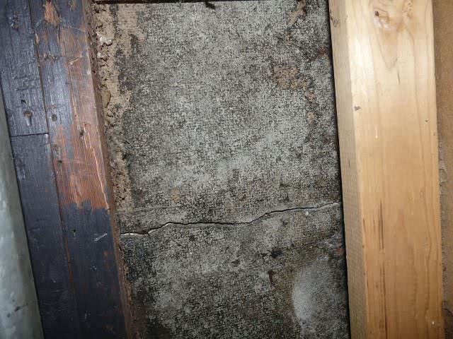

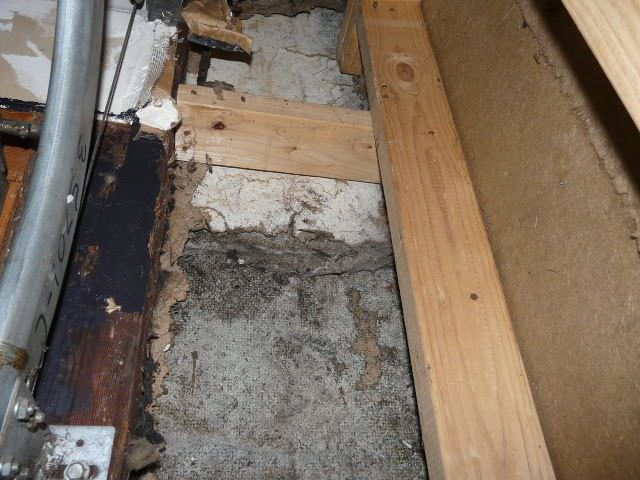

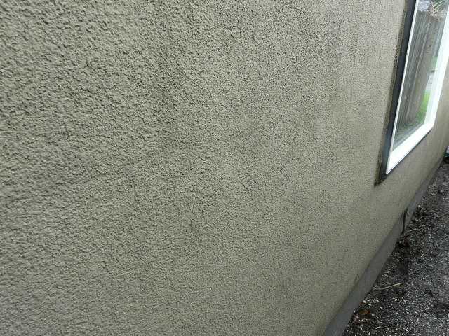

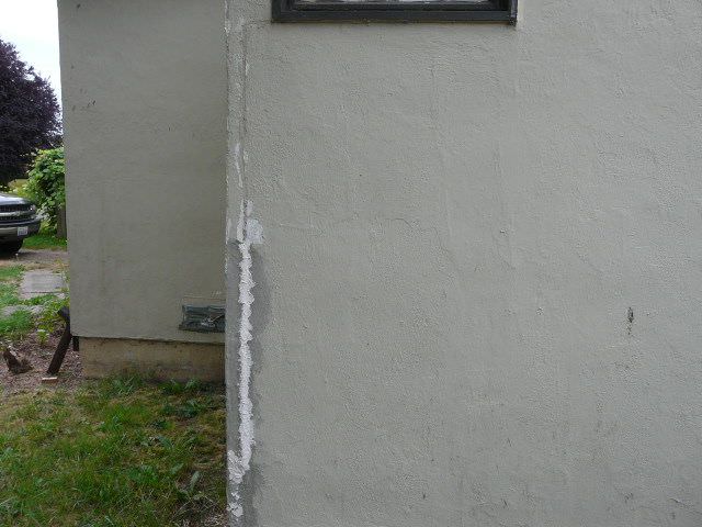

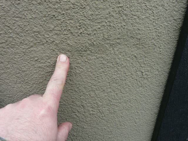

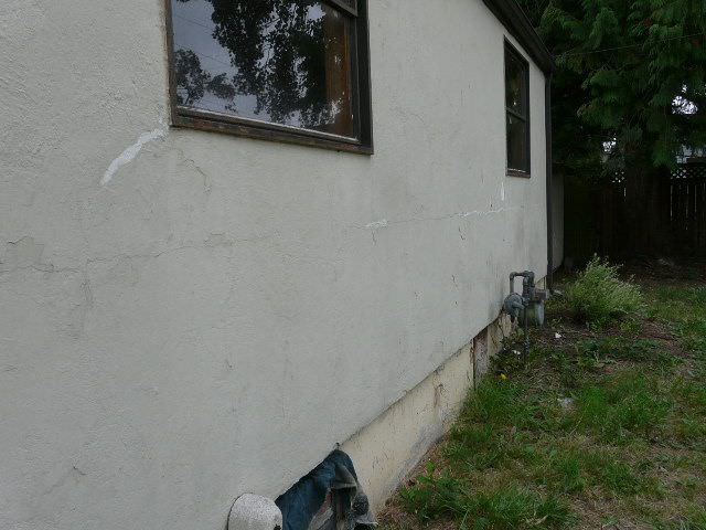

tybertown29 Posted April 5, 2012 Report Share Posted April 5, 2012 Heres one for you. I was called to inspect a house for a local Real Estate agent that he was buying in hopes of turning and flipping. He asked that i look at the Major issues of the house and give him an evaluation. House was full of storage debris and other things that made a full inspection impossible. I let him know this but I was able to partially evaluate the stucco siding. The stucco siding had horizontal cracks all around the house and garage. Cracks where very linear in nature. I recommended having a stucco expert evaluate and make recommendations for repair/replacement. Now fast forward 7 months. I get the call to inspect same property for the new perspective buyer. I noticed the stucco had been resurfaced but had new cracks in same location. Upon entering the garage I noticed that the unfinished wall exposed the stucco siding from the back side. I also noticed that vapor barrier and fiber board where missing. I could also see the original crack and could see daylight along the other side. So I again recommended that the stucco expert be contacted and get his evaluation of the siding. I did advise that the current condition is not advisable and should be evaluated by a different stucco expert. Attached are pics and stucco eval. You should all have fun with this one. Download Attachment: Stucco eval letter 001.pdf 159.15?KB Click to Enlarge 55.43?KB Click to Enlarge 57.1?KB Click to Enlarge 67.03?KB Click to Enlarge 92.9?KB Click to Enlarge 79.88?KB Click to Enlarge 65.88?KB Link to comment Share on other sites More sharing options...
hausdok Posted April 5, 2012 Report Share Posted April 5, 2012 30 years in the stucco business? As what, a marketing guy? No expansion joints, no accessory joints under windows. Of course it cracked. ONE TEAM - ONE FIGHT!!! Mike Link to comment Share on other sites More sharing options...

Jim Katen Posted April 5, 2012 Report Share Posted April 5, 2012 My feelings are hurt that is the only thing you find interesting. Bad Form You found a commonplace problem. It wasn't fixed properly. 7 months later it was still there. A contractor with 30 years experience swears it's ok. Yawn. Normally, I wouldn't even comment. But "perspective client," who could resist? Link to comment Share on other sites More sharing options...

Layla Posted April 8, 2012 Report Share Posted April 8, 2012 I'm a little confused... the pics to me look more like EIFS than stucco...I don't think the two words are interchangable, but maybe I am way off base. Link to comment Share on other sites More sharing options...
Jim Katen Posted April 8, 2012 Report Share Posted April 8, 2012 I'm a little confused... the pics to me look more like EIFS than stucco...I don't think the two words are interchangable, but maybe I am way off base. Why do you think they look like EIFS? The crack patterns in the first few pictures are typical of hardcoat stucco. The last two pics show the backside of the stucco, which looks very different from the backside of EIFS. I don't see anything in any of the pics that suggests EIFS. Link to comment Share on other sites More sharing options...
