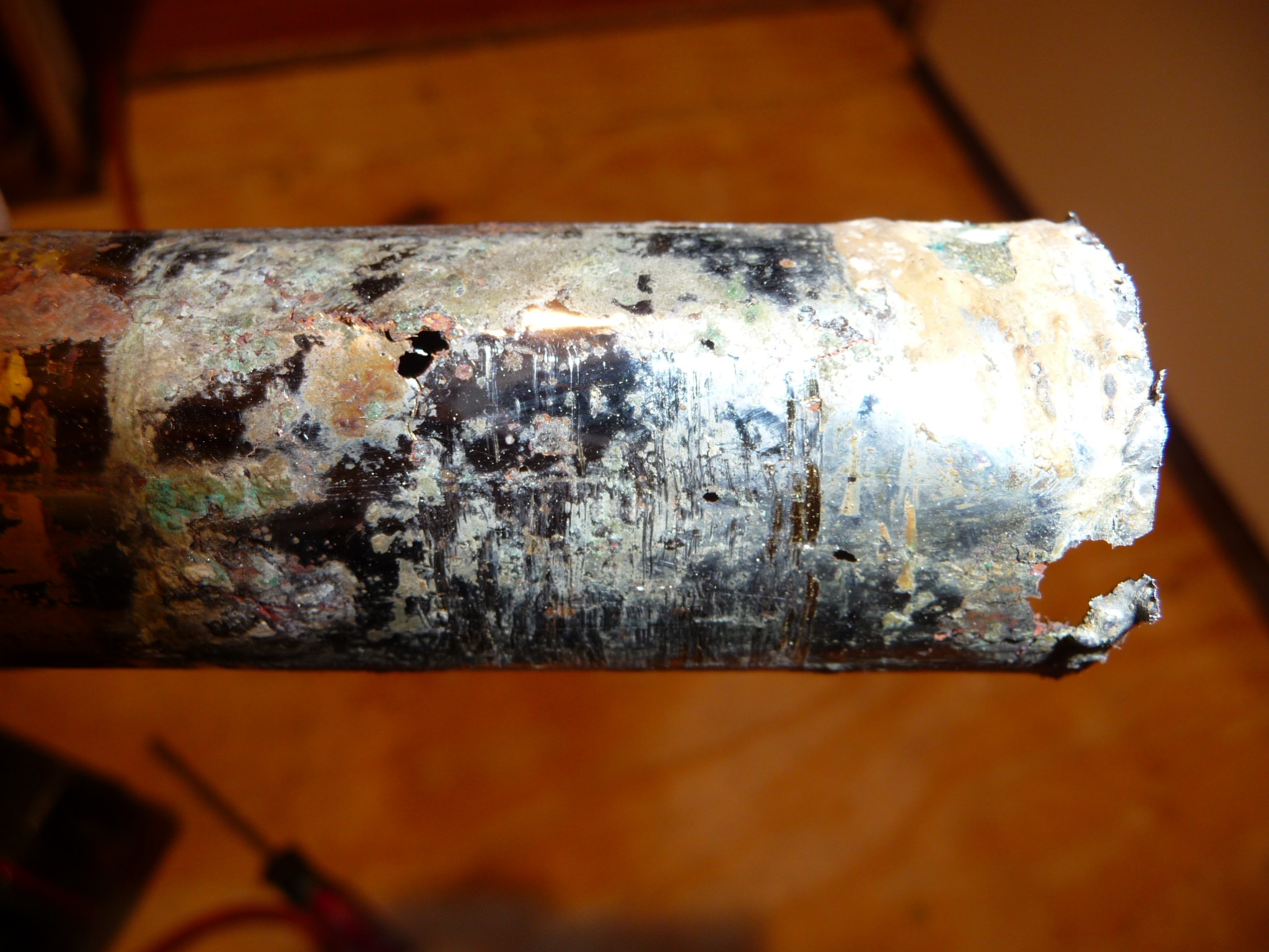

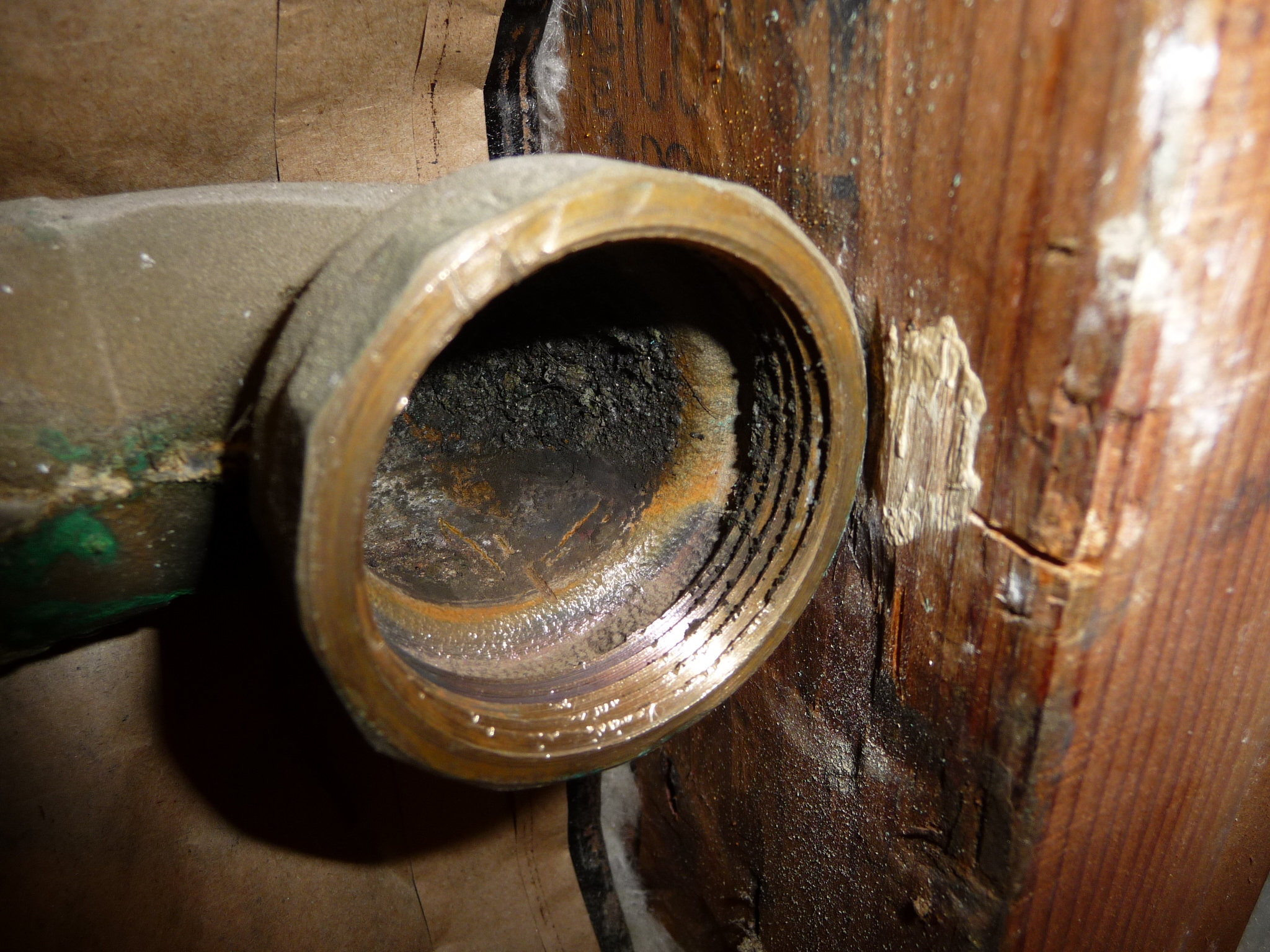

John Dirks Jr Posted April 13, 2012 Report Share Posted April 13, 2012 Before I close the wall, now is the time to change the stub out. The drain piping in the wall is 1 1/2 copper and thats a brass fitting. Should I change to a 1 1/2 stub out and trap? I know the sink tail piece is 1 1/4 but if everything down from that is larger I figure fewer clogs. What would be your choice in this situation? What size and material stub out and threaded or not? The first pic is the current stub out. The second pic is the sink drain tail piece. Download Attachment: P1240679.JPG 1515.91 KB Download Attachment: P1240680.JPG 1597.58 KB Quote Link to comment Share on other sites More sharing options...

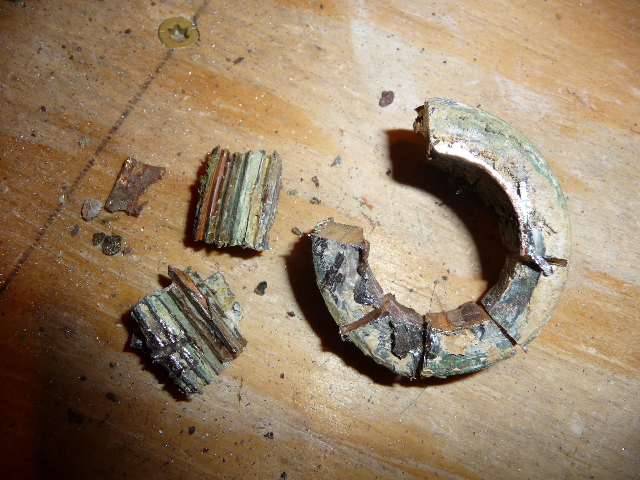

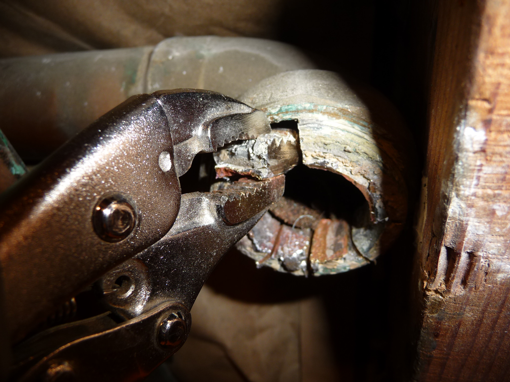

John Dirks Jr Posted April 14, 2012 Author Report Share Posted April 14, 2012 Good thing I took it out. The pipe was pitted and ready to leak anyway. I cut it flush then hacked radius cuts in the brass bushing. Vice grips, chisel and a wire brush later and like new and ready for a new stub. Download Attachment: P1240682.JPG 1581.23 KB Download Attachment: P1240686.JPG 1549.67 KB Download Attachment: P1240689.JPG 1610.7 KB Download Attachment: P1240691.JPG 1554.82 KB Download Attachment: P1240693.JPG 1645.93 KB Quote Link to comment Share on other sites More sharing options...

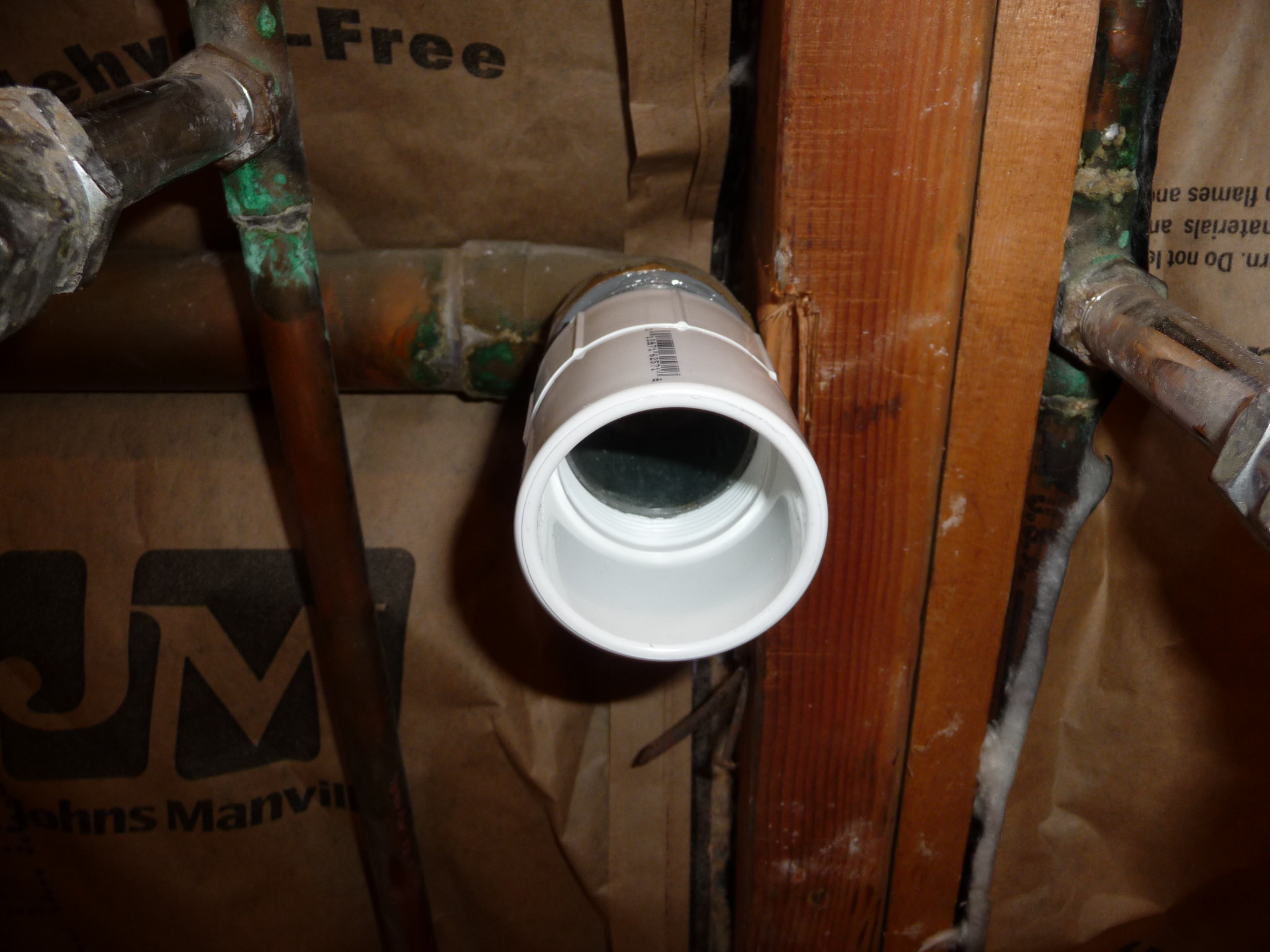

John Dirks Jr Posted April 15, 2012 Author Report Share Posted April 15, 2012 Stubbed out in 1 1/2 and ready. Download Attachment: P1240705.JPG 1593.83 KB Quote Link to comment Share on other sites More sharing options...
