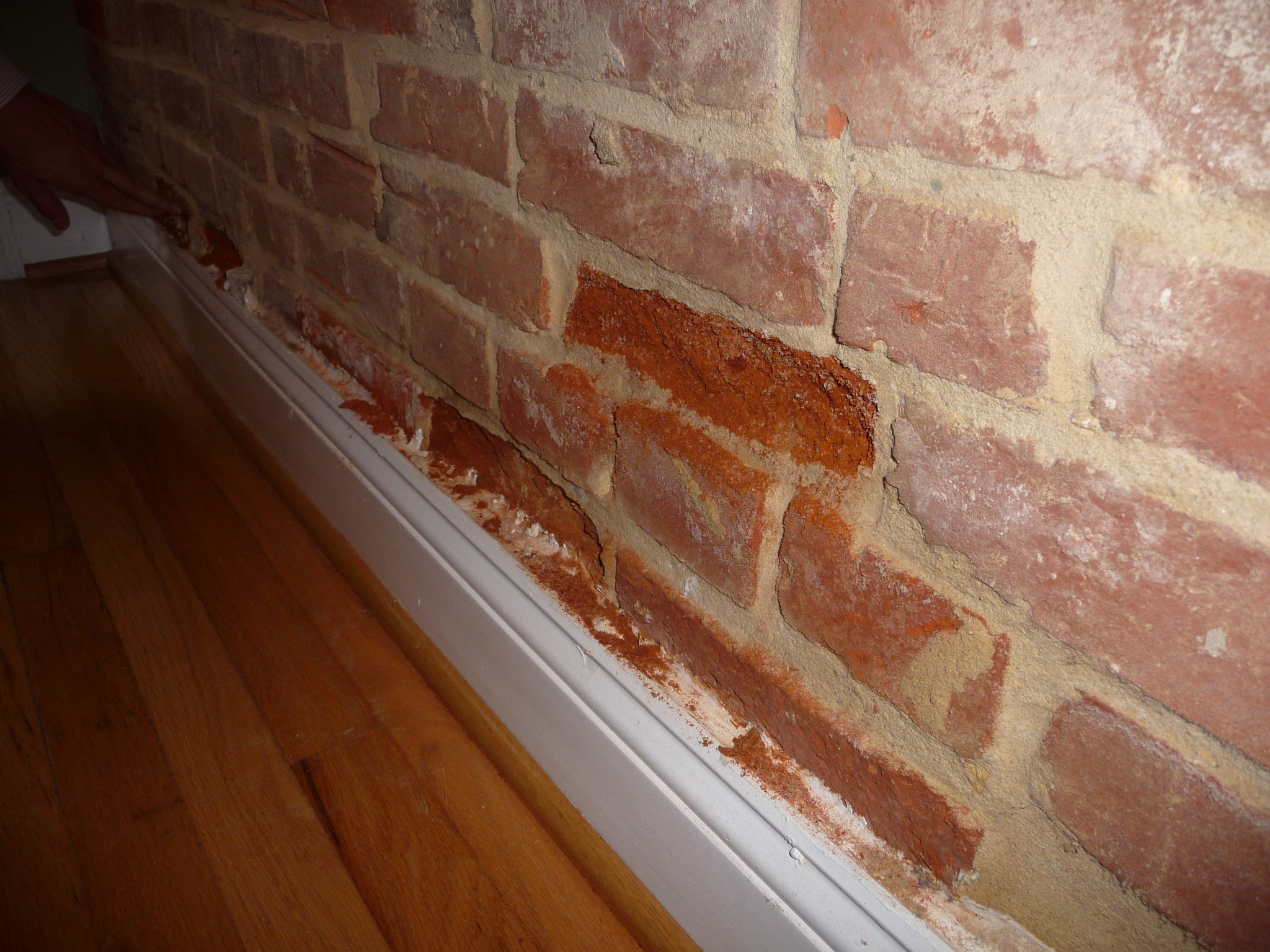

John Dirks Jr Posted May 10, 2012 Report Share Posted May 10, 2012 The pics are of structural brick circa 1880 in Baltimore City. Obviously, the bricks are soft. However, the mortar was very hard and did not crumble very easily under the tip of my screwdriver. This looks like a classic case of using portland cement based mortar to re-point old soft bricks. The reno was done in 2005 and these damaged bricks are near the bottom of the wall. Does this ill effect of incorrect mortar type usually cause damage at the bottom first? Download Attachment: P1250179.JPG 1595.6 KB Download Attachment: P1250178.JPG 1514.77 KB Quote Link to comment Share on other sites More sharing options...

Bill Kibbel Posted May 10, 2012 Report Share Posted May 10, 2012 If the bricks are spalling on the interior, it's likely from moisture wicking or trapped in the wall. The big problem is that an asshole completely removed the plaster to expose the bricks inside the home. Quote Link to comment Share on other sites More sharing options...
Mike Lamb Posted May 10, 2012 Report Share Posted May 10, 2012 I'd be blaming serious exterior moisture problems. Quote Link to comment Share on other sites More sharing options...

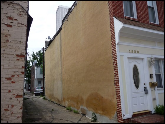

John Dirks Jr Posted May 10, 2012 Author Report Share Posted May 10, 2012 Would these stains on the exterior wall fit the rising damp idea? Also...Bill, how exactly does removing the plaster negatively affect the situation? Download Attachment: P1250097.JPG 96.14?KB Quote Link to comment Share on other sites More sharing options...
Bill Kibbel Posted May 10, 2012 Report Share Posted May 10, 2012 Aha! The Portland-based cement stucco is trapping the moisture in the brick walls. Skin-fired bricks should never, ever have stucco or "Brick-face" (so popular here), containing Portland cement applied. If the bricks were still exposed on the exterior, the pointing and bedding mortar is lime-based and the interior lime-based plaster was still present, not a single brick would be failing. Quote Link to comment Share on other sites More sharing options...
Bill Kibbel Posted May 10, 2012 Report Share Posted May 10, 2012 Also...Bill, how exactly does removing the plaster negatively affect the situation? The bricks on the interior wythe were specifically selected for interior use because they were the furthest from the heat source in the kiln (underfired). The skin is inadequate for the face of the brick to remain exposed. The moisture that is in the brick wall now only has one path out - inwards, taking out what little skin was on the brick. It's an epidemic. Folks buy expensive brick homes in exclusive historic areas, strip all the plaster to expose the brick, then ask "why is there constantly red dust all over my home?" Quote Link to comment Share on other sites More sharing options...
AHI in AR Posted May 10, 2012 Report Share Posted May 10, 2012 Would these stains on the exterior wall fit the rising damp idea? Also...Bill, how exactly does removing the plaster negatively affect the situation? Download Attachment: P1250097.JPG 96.14?KB Homes around here are too new to see structural brick very much at all, but I'd have to think that a plaster layer would help diffuse moisture so that it could evaporate evenly. Quote Link to comment Share on other sites More sharing options...

Marc Posted May 10, 2012 Report Share Posted May 10, 2012 The moisture that is in the brick wall now only has one path out - inwards, taking out what little skin was on the brick. I understand the mechanics of the moisture. What I don't get is how does the moisture spall the skin off the brick. Or did it spall just because exposing it allowed people to damage it with chairs, furniture, etc? Marc Quote Link to comment Share on other sites More sharing options...
Bill Kibbel Posted May 10, 2012 Report Share Posted May 10, 2012 I understand the mechanics of the moisture. What I don't get is how does the moisture spall the skin off the brick. Or did it spall just because exposing it allowed people to damage it with chairs, furniture, etc? Marc It's caused by using the wrong type of mortar for later repointing.http://www.oldhouseweb.com/how-to-advic ... onry.shtml Quote Link to comment Share on other sites More sharing options...

kurt Posted May 11, 2012 Report Share Posted May 11, 2012 Screw it up. The problem cited is epidemic in all masonry. Incompatible mortars, and it's not just historic stuff. The engineers love the high compressive strength mortars, but they simply aren't compatible with all brick. The parging we see so often was, at one time, a lime based preparation that "nourished" the old masonry, a moisture barrier (sort of) and acted as a sacrificial layer for the valuable underlying brick. It's been reinterpreted as a layer of "waterproofing" that really screws stuff up. Forget portland cement, or at minimum, apply it sparingly in any mortar mix. Think lime. Quote Link to comment Share on other sites More sharing options...
