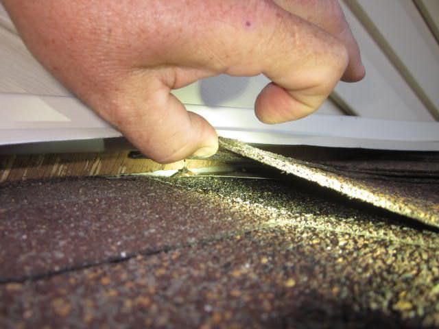

Mike Lamb Posted June 28, 2012 Report Share Posted June 28, 2012 What do you think of this detail? There is no step flashing, only a 90 degree compressed counter flashing. Click to Enlarge 42.56 KB Quote Link to comment Share on other sites More sharing options...
Brandon Whitmore Posted June 28, 2012 Report Share Posted June 28, 2012 Not a chance...... Quote Link to comment Share on other sites More sharing options...
kurt Posted June 28, 2012 Report Share Posted June 28, 2012 It's showing up lots of places. I put it in the report as a weak link. Quote Link to comment Share on other sites More sharing options...
Jerry Simon Posted June 28, 2012 Report Share Posted June 28, 2012 I think it's fine. The siding/siding lower channel acts like the counter-flashing. Quote Link to comment Share on other sites More sharing options...

kurt Posted June 28, 2012 Report Share Posted June 28, 2012 Except in a high wind driven rain. If there was IWS up and down the wall, I supposed it's "fine". How hard is step flashing? If someone would leave out step flashing because it's too complicated, I couldn't trust anything else they did. Quote Link to comment Share on other sites More sharing options...
Mike Lamb Posted June 28, 2012 Author Report Share Posted June 28, 2012 I've seen this before but could not verify there was no step flashing. Here I could. I'm also think with a hard wind driven rain this could be a real leaker. The roof is about 4 years old. This pic does not help the roofer or owner. I think roofer's should just read and follow the instructions. Click to Enlarge 46.15?KB Thanks for your comments. Quote Link to comment Share on other sites More sharing options...
Marc Posted June 28, 2012 Report Share Posted June 28, 2012 Click to Enlarge 46.15?KB Thanks for your comments. I may be wrong but that picture shows what seems to be step flashing, cut at an angle at the lower edge instead of straight as I usually see. Marc Quote Link to comment Share on other sites More sharing options...
BADAIR Posted June 28, 2012 Report Share Posted June 28, 2012 there's your BINGO unprotected ply substrate (vertical mulch) will wick and rot they can fix wall/flashing details now or fix wall/flashing details, structure and associated moisture intrusion issues down the road ignoring the facts don't lessen the cost... Quote Link to comment Share on other sites More sharing options...

Mike Lamb Posted June 28, 2012 Author Report Share Posted June 28, 2012 Click to Enlarge 46.15?KB Thanks for your comments. I may be wrong but that picture shows what seems to be step flashing, cut at an angle at the lower edge instead of straight as I usually see. Marc That could be. It's not what I normally see either. And the flashing would have been installed behind the plywood wall sheathing which is also atypical. Quote Link to comment Share on other sites More sharing options...
ericwlewis Posted June 29, 2012 Report Share Posted June 29, 2012 Click to Enlarge 46.15?KB Thanks for your comments. I may be wrong but that picture shows what seems to be step flashing, cut at an angle at the lower edge instead of straight as I usually see. Marc I see step flashing too, installed behind plywood siding, covered by vinyl siding. The "counter flashing" was installed by the siding guy IMO. Quote Link to comment Share on other sites More sharing options...
John Kogel Posted June 29, 2012 Report Share Posted June 29, 2012 Click to Enlarge 46.15?KB Thanks for your comments. I may be wrong but that picture shows what seems to be step flashing, cut at an angle at the lower edge instead of straight as I usually see. Marc That could be. It's not what I normally see either. And the flashing would have been installed behind the plywood wall sheathing which is also atypical. It is still wrong. Quote Link to comment Share on other sites More sharing options...
ericwlewis Posted June 29, 2012 Report Share Posted June 29, 2012 Click to Enlarge 46.15?KB Thanks for your comments. I may be wrong but that picture shows what seems to be step flashing, cut at an angle at the lower edge instead of straight as I usually see. Marc That could be. It's not what I normally see either. And the flashing would have been installed behind the plywood wall sheathing which is also atypical. It is still wrong. I realize that wood siding touching the roof is wrong and should have been corrected but are you objecting to; -covering wood siding with vinyl? -covering wood siding with vinyl without a housewrap? -covering wood siding with vinyl without additional step flashing? If there was housewrap added over the wood siding and there happened to be housewrap under the wood siding, would that be an issue? I cannot judge 100% by a photo but I don't see the problem. -New siding, old wood siding, step flashing, what's missing? Quote Link to comment Share on other sites More sharing options...
Marc Posted June 29, 2012 Report Share Posted June 29, 2012 Click to Enlarge 46.15?KB Thanks for your comments. I may be wrong but that picture shows what seems to be step flashing, cut at an angle at the lower edge instead of straight as I usually see. Marc That could be. It's not what I normally see either. And the flashing would have been installed behind the plywood wall sheathing which is also atypical. It is still wrong. I realize that wood siding touching the roof is wrong and should have been corrected but are you objecting to; -covering wood siding with vinyl? -covering wood siding with vinyl without a housewrap? -covering wood siding with vinyl without additional step flashing? If there was housewrap added over the wood siding and there happened to be housewrap under the wood siding, would that be an issue? I cannot judge 100% by a photo but I don't see the problem. -New siding, old wood siding, step flashing, what's missing? I agree with John K. As a former roofer, a literate one, galvanized flashing corrodes quite quickly if incidental moisture cannot escape. Marc Quote Link to comment Share on other sites More sharing options...
Brandon Whitmore Posted June 29, 2012 Report Share Posted June 29, 2012 -New siding, old wood siding, step flashing, what's missing? The plywood may not be old siding; it's probably just the wall sheathing. Could you tell Mike? What was visible from the attic, if accessible? If the plywood "siding" was original, then it was improperly installed since it's too close to the roof line. Every installation detail I have ever seen indicates that step flashing needs to be installed in between the siding and wall sheathing. If there is step flashing run in behind the plywood, then it's less of an issue, but still wrong. The plywood is most likely going to rot out over time. Quote Link to comment Share on other sites More sharing options...
Mike Lamb Posted June 29, 2012 Author Report Share Posted June 29, 2012 The house was 1984 I think. This newer roof was after a tear-off. The angled counter flashing was installed under the siding so siding had to be removed. I thought there was no step flashing at the inspection. Only after looking at the photo did I consider that there might be step flashing behind the plywood. I had to position my camera on the roof, shine a flashlight in there, and lift the flashing to get this pic. I did not see what the photo shows during the inspection. So maybe that's step flashing under the plywood and maybe not. Maybe there's an MB behind the vinyl placed above that flashing and maybe not. I don't know why they just didn't step flash and remove all the drama. The attic had excessive mold under the roof sheathing. Quote Link to comment Share on other sites More sharing options...
Jeff Remas Posted October 11, 2012 Report Share Posted October 11, 2012 Very common to see substandard work like that. Too lazy to follow the manufacturer's installation instructions and the code requirements. Most manufacturers require 5" of vertical flashing with 7x10 pieces and the code since 2009 (IRC) requires 4" of vertical flashing. Step flashing with counterflashing is the only acceptable method. I just did an expert witness for this exact situation that resulted in leaks during driving rainstorms. Quote Link to comment Share on other sites More sharing options...
Jeff Remas Posted October 11, 2012 Report Share Posted October 11, 2012 I've seen this before but could not verify there was no step flashing. Here I could. I'm also think with a hard wind driven rain this could be a real leaker. The roof is about 4 years old. This pic does not help the roofer or owner. I think roofer's should just read and follow the instructions. Click to Enlarge 46.15?KB Thanks for your comments. That appears to be step flashing and the siding acts as counter flashing. This may be OK if we had better photographic evidence and could verify the height of the vertical portion of the step flashing. Quote Link to comment Share on other sites More sharing options...
