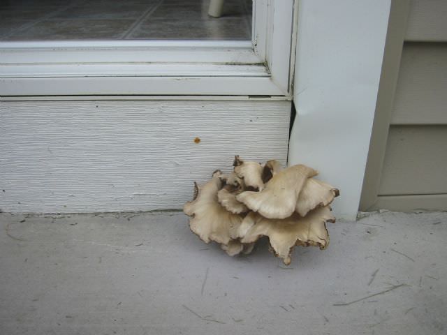

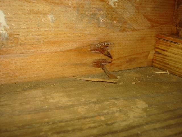

Inspectorjoe Posted August 26, 2012 Report Share Posted August 26, 2012 Yesterday I had a 5 year old townhouse that had a small patio, with the surface at least 5 or 6 inches above the top of the foundation. The concrete was poured against the siding and trim. It was hard to miss a mushroom growing out of the trim under the sliding door. Surprisingly, the only damage visible at the interior was slight staining, a few rusty nails and a yellowish powdery substance (mold?) on the insulation vapor barrier. All of the units within sight had patios built the same way. I'm going to recommend that a contractor remove some of the trim and determine the damage, but I'm wondering what the options might be for permanently correcting this. It might be difficult or impossible to make major modifications to the patio because of the association rules. Does anyone with contracting experience have any suggestions? Click to Enlarge 36.89 KB Click to Enlarge 46.12 KB Quote Link to comment Share on other sites More sharing options...

Inspectorjoe Posted August 27, 2012 Author Report Share Posted August 27, 2012 The patios are really small, John. A landing at the door would have eaten up close to a quarter of the square footage. I'm sure that's why they placed them so high. I don't think tearing it out is an option, at least not without jumping through a lot of hoops. Click to Enlarge 62.35 KB Quote Link to comment Share on other sites More sharing options...
Scottpat Posted August 27, 2012 Report Share Posted August 27, 2012 I'm sure the sill plate is gone in that area. In order to correct it, I see no other option but to remove the small patio. The I would install a PT deck in it's place. We can't worry about an HOA and if they will allow the repair, all we can do is to report what we find. Ya can't fix stupid! Quote Link to comment Share on other sites More sharing options...
kurt Posted August 27, 2012 Report Share Posted August 27, 2012 Yeah, there's nothing but rot in there. I can think of a lot of ways to repair it, and they all involve taking the patio out. Quote Link to comment Share on other sites More sharing options...
Brandon Whitmore Posted August 27, 2012 Report Share Posted August 27, 2012 Take a mini excavator, slide the concrete out slightly away from the wall, replace the rot, stick flashing in between the concrete and new wall, and use the excavator to push the patio back into place. Quote Link to comment Share on other sites More sharing options...

Inspectorjoe Posted August 27, 2012 Author Report Share Posted August 27, 2012 Thanks for the replies, everyone. I assumed removal was the only option, but held out hope there might be some miracle cure. There's probably about a 10% chance that patio is going to be corrected, but that's not my problem. Just two days ago, I got a call from an agent who was in a house I'd inspected a few weeks ago. She was trying to determine if rotted framing caused by a high patio had been repaired. I had recommended that the rotted framing be replaced, AS WELL AS THE PATIO. I asked her what was done with the patio, and of course it hadn't been touched. Now I know how my doctor must feel when he tells me I need to eat more sensibly and lose weight. Quote Link to comment Share on other sites More sharing options...
John Kogel Posted August 27, 2012 Report Share Posted August 27, 2012 Only 5 years old, the damage could be minor so far. But a mushroom says otherwise. The part we see is only the fruit. Down in the dark, there is a root mass eating away at the sill. I wonder if they can still go after the builder for that screw up? They could cut away a 6" strip of the concrete along the wall and install a metal grate there. They could have put little roofs over the decks as well. I like the idea of pulling the slabs away from the wall, with a hoe or with your teeth, whatever. [] Quote Link to comment Share on other sites More sharing options...

Marc Posted August 27, 2012 Report Share Posted August 27, 2012 Only 5 years old, the damage could be minor so far. But a mushroom says otherwise. The part we see is only the fruit. Down in the dark, there is a root mass eating away at the sill. I wonder if they can still go after the builder for that screw up? On a 5 yr old house, I'd recommend corrective action even if I didn't see any damage. Not so on an undamaged 30 year old home. Marc Quote Link to comment Share on other sites More sharing options...

Inspectorjoe Posted August 28, 2012 Author Report Share Posted August 28, 2012 John, I hadn't thought of cutting a section out and installing a grate. It's not an ideal solution, but it might be doable. One other complication that I didn't mention, but was visible in the second picture is that each patio serves two units. This evening I was back to pick up the radon monitor, so I took a little walk. Every unit in that community had the exact same patio with the same issue. I'm sure others are encountering the same problem. I can't see how the builder would ever be able to correct every one without going into bankruptcy. After 5 years, the streets don't even have the top layer of asphalt. Also, after 5 years, the ground rod for this unit is still not installed - and the sticker signing off on the final electrical inspection was on the panel: http://www.facebook.com/homeprolv?ref=h ... =1&theater Quote Link to comment Share on other sites More sharing options...
