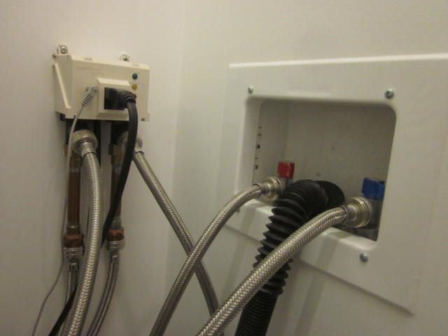

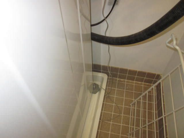

Mike Lamb Posted September 5, 2012 Report Share Posted September 5, 2012 I was hired by a lawyer to do a post repair inspection involving $1M condo in the Trump Tower. Much of the condo needed to be gutted. The washer now has an automatic shut-off system that shuts down the valves when the washer is done with its cycle so to limit stress on the hoses, or it shuts off if moisture is sensed in the pan. Click to Enlarge 26.07?KB Click to Enlarge 25.2 KB Quote Link to comment Share on other sites More sharing options...
Neal Lewis Posted September 5, 2012 Report Share Posted September 5, 2012 That's the Watts Intelliflow. I had to remove mine when I found out it didn't work with washers with digital/push button controls. That was ten years ago, though. Quote Link to comment Share on other sites More sharing options...

Mike Lamb Posted September 5, 2012 Report Share Posted September 5, 2012 The system in my pics is about $300 for parts. Plus labor. So about $600 - 800 installed. Quote Link to comment Share on other sites More sharing options...
