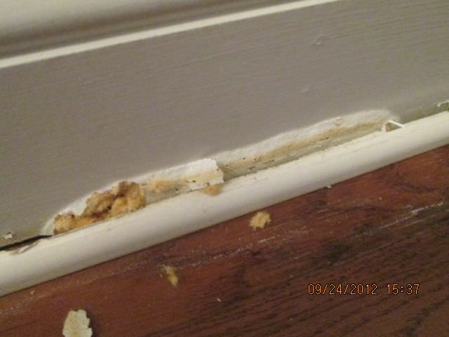

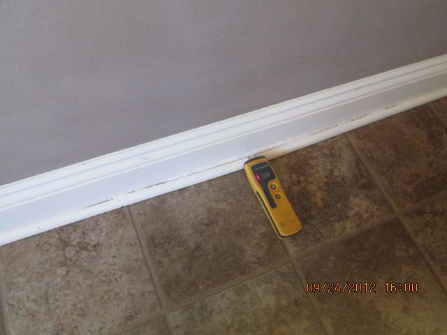

Phillip Posted September 25, 2012 Report Share Posted September 25, 2012 I need a little help. I have no idea what is causing this. This is close to the front door. There is a porch on the front of the house and the garage is on the other side of the wall. Click to Enlarge 43.02 KB I have 100% moisture reading. I check the attic and no water is getting in above it. The walls in the garage show no high readings or damage. Here is a larger view of what going on. Click to Enlarge 36.42 KB Here is a close shot. I am the one that probed it. Click to Enlarge 38.46 KB I was on the edge to say it was getting in at the front door which the trim has a high moisture read until i found it in the dining room at an outside wall. Which I open up the vinyl siding and did not see anything. Click to Enlarge 38.46 KB Any ideals? Quote Link to comment Share on other sites More sharing options...

Marc Posted September 25, 2012 Report Share Posted September 25, 2012 What building material is that damaged molding made of? It doesn't have to be wet to make the surveymaster peg at 100% if the material is even mildly electrically conductive. Marc Quote Link to comment Share on other sites More sharing options...
John Kogel Posted September 25, 2012 Report Share Posted September 25, 2012 That is MDF, is it not? There is not much doubt that there is moisture there. Maybe a plumbing pipe is leaking in that wall. Also water can run a long way along a sill sometimes, and it could be leaking into the attic near the eave where you can't see it. Quote Link to comment Share on other sites More sharing options...

hausdok Posted September 25, 2012 Report Share Posted September 25, 2012 That looks like a 10% moisture reating - not 100%. My meter only goes to 99.9 - it never displayes 100. Got a dog there that might typically exit that door to relieve himself and might use that wall if someone doesn't immediately open the door? My little guy seems to always demand to go out at about the point where his bladder is going to burst. Even the slightest hesitation on my part enroute to the door has resulted in "accidents" near the entrance. ONE TEAM - ONE FIGHT!!! Mike Quote Link to comment Share on other sites More sharing options...
John Kogel Posted September 25, 2012 Report Share Posted September 25, 2012 That looks like a 10% moisture reating - not 100%. My meter only goes to 99.9 - it never displayes 100. I saw that, but his other pic shows the meter in the red, so he does have high readings. Got a dog there? Yep, this calls for a sniff and taste test. Bring it to a Lab! Black, Golden, or Chesnut, no matter. [] Quote Link to comment Share on other sites More sharing options...

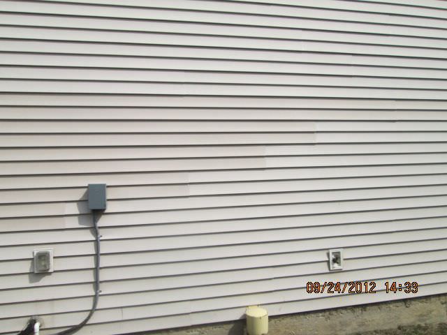

Phillip Posted September 25, 2012 Author Report Share Posted September 25, 2012 Any pictures of the outside near these two areas. What about liberal application of water on the floor during mopping getting soaked up into that trim. Was WRB behind the vinyl? To everyone this is an forcloser house. No one has live in it since the first of the year. I don't have any photos Of the areas behind them. The one at the front door is next to the garage which the slab for the house floor is higher than the garage slab. Standard drywall which I scanned and did not get any moisture reading. The outside of the other one isnormal vinyl side that has house wrap. Quote Link to comment Share on other sites More sharing options...
Phillip Posted September 25, 2012 Author Report Share Posted September 25, 2012 The trim is MDF. it is swollen material is from bottom up. It is at the front door which is setting on the metal jam that has weather striping. It is 100% I watch it go up and when it hits a 100 the light go out. It taste like chicken. I'm thinking that some of this stormy weather blew it in. As far as I could tell there is no water pipes in the area and I looked hard in the attic above them. There was no high moisture reading above these places. Quote Link to comment Share on other sites More sharing options...

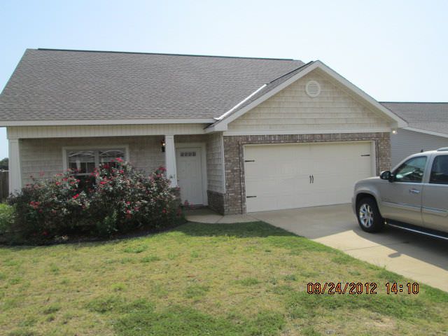

Phillip Posted September 25, 2012 Author Report Share Posted September 25, 2012 This is a shot of the front of the house. Click to Enlarge 52.82 KB This is the right side of the house the area that the damage is, is to the right Click to Enlarge 54.17 KB Quote Link to comment Share on other sites More sharing options...
