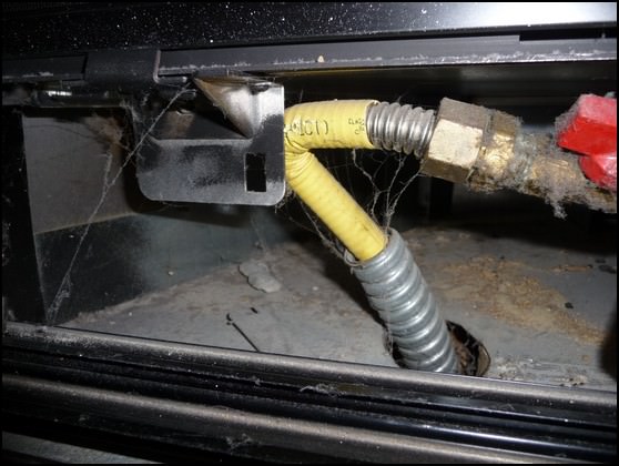

John Dirks Jr Posted October 11, 2012 Author Report Share Posted October 11, 2012 Metal chimney through the roof. Metal fireplace insert with CSST running through metal conduit and also in contact with fireplace metal cabinet. Download Attachment: P1300334.JPG 100.27 KB Quote Link to comment Share on other sites More sharing options...
inspector57 Posted October 11, 2012 Report Share Posted October 11, 2012 One of the major builders in my area has abandoned using CSST all together and has gone back to using black iron. Have you recognized any of the builders in your area doing the same? I sometimes use this following document in reports to explain CSST to my clients. What's your opinion of including something like this in an inspection report? http://hawkeyehomeinspects.com/document ... ANGERS.pdf I wonder, what is the date of that document? The author does not mention the bonding of CSST which is what the manufacturers are hanging their hat on to reduce liability. This was also part of the settlement from the law suit. One thing to be aware of is to consider the likelihood of lightening both in your area and the individual house. In Frisco (on of the first areas to note the correlation of CSST and fire damage from lightening) lots and lots of the homes have two or three furnaces and a couple of water heaters along with metal fireplaces in a two or three story house with most all of the CSST and equipment stuck up in the attic. All of this is on the rolling prairie in a high lightening density area. I may be off base but I would think a single section of CSST hidden in the crawl space or basement in an area without much lightening would be at a far lower risk. Quote Link to comment Share on other sites More sharing options...
