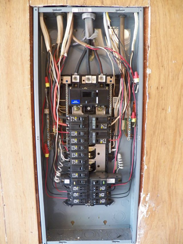

kimball gray Posted October 12, 2012 Report Share Posted October 12, 2012 House is a 1977 flip that has a new panel (200-amp). In the panel the legend for the GFCI's point to AFCI circuit breakers. The GFCI outlets have the test buttons/reset on the outlets in both bathrooms. I tripped them and they would not reset. I go to the panel, and the AFCI breaker is tripped. So, I reset the AFCI breaker, go back to the outlet and it still wont reset. I go to another bathroom and find that that GFCI has power. Long story short, I went all over the house and exterior checking to see if any other outlets were tied to the bathroom that I originally tripped and never did get a clear indication of how this circuit was configured. Somehow, not sure how, after several attempts, the GFCI that I originally tripped came back on and I left it alone. My questions is: Can GFCI outlets be connected to AFCI breakers? Also, the AFCI breakers in the panel would not reset unless you pressed the test button(that was already tripped) again to make it release. In other words the test button on the AFCI breaker in the panel would stay "pressed-in" until I manually made it release, then reset the breaker... Any help would be appreciated. Thanks again in advance for your expertise! Click to Enlarge 106.81 KB Quote Link to comment Share on other sites More sharing options...

Jim Katen Posted October 12, 2012 Report Share Posted October 12, 2012 House is a 1977 flip that has a new panel (200-amp). In the panel the legend for the GFCI's point to AFCI circuit breakers. The GFCI outlets have the test buttons/reset on the outlets in both bathrooms. I tripped them and they would not reset. I go to the panel, and the AFCI breaker is tripped. So, I reset the AFCI breaker, go back to the outlet and it still wont reset. I go to another bathroom and find that that GFCI has power. Long story short, I went all over the house and exterior checking to see if any other outlets were tied to the bathroom that I originally tripped and never did get a clear indication of how this circuit was configured. Somehow, not sure how, after several attempts, the GFCI that I originally tripped came back on and I left it alone. My questions is: Can GFCI outlets be connected to AFCI breakers? Yes, they can and they should work just fine. However, if you use a portable tester to test them, then you risk tripping the built-in GFCI protection in the AFCI breaker. In that case, you have to go reset everything in the proper order to restore power. This should not happen if you use the GFCI's built-in test button, as it creates a fault that's below the threshold of the AFCI's GFCI function. (The GFCI function in an AFCI is not for protection of people and it has a much higher threshold than the type of GFCIs that you're used to.) Also, the AFCI breakers in the panel would not reset unless you pressed the test button(that was already tripped) again to make it release. In other words the test button on the AFCI breaker in the panel would stay "pressed-in" until I manually made it release, then reset the breaker... Any help would be appreciated. Thanks again in advance for your expertise! What brand AFCIs were these? Were they the branch/feeder type or the combination type? Quote Link to comment Share on other sites More sharing options...
Jack Davenport Posted October 12, 2012 Report Share Posted October 12, 2012 How old are the AFCI breakers? Are they the newer required combination type AFCI breakers? When AFCI breakers first came out they did not play well with GFCI's. The newer ones have no problems. I make electricians put GFCI outlets on AFCI breakers all the time. Matter of Fact in the upcoming 2014 NEC the kitchen will require afci protection. That means the counter top outlets must be gfci and AFCI protected Quote Link to comment Share on other sites More sharing options...
