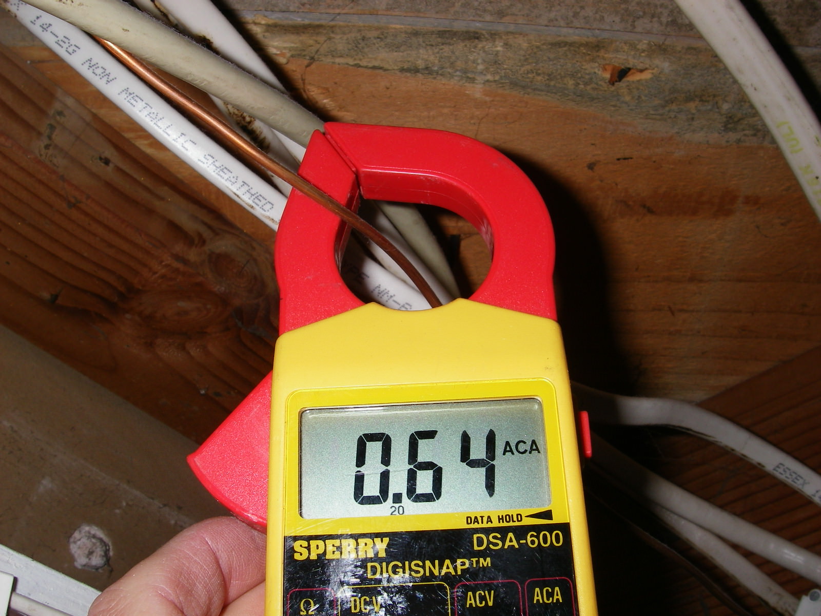

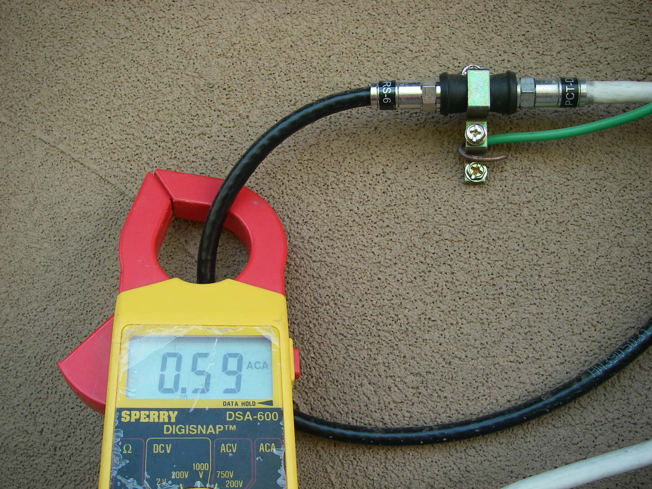

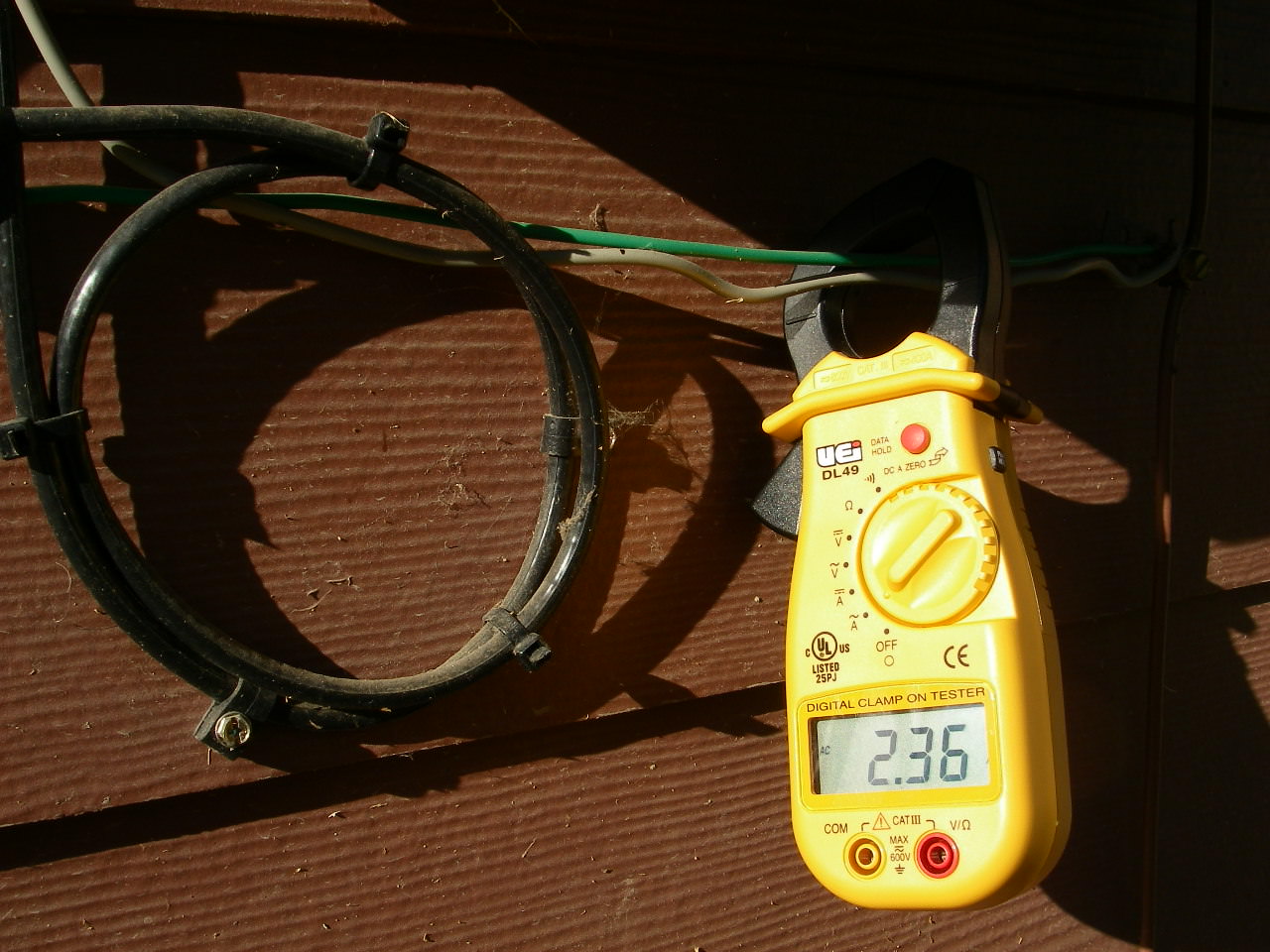

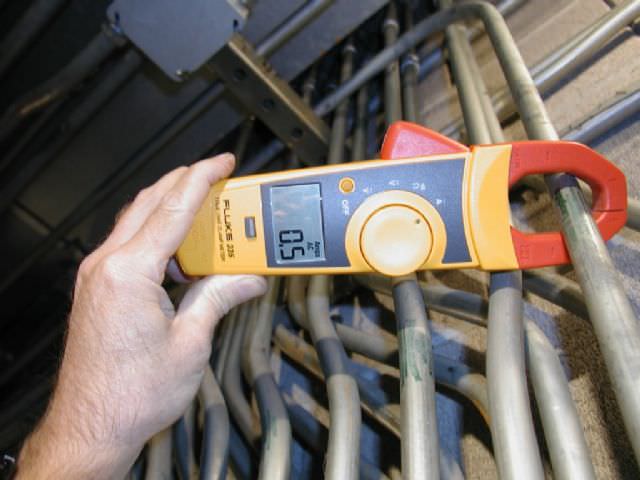

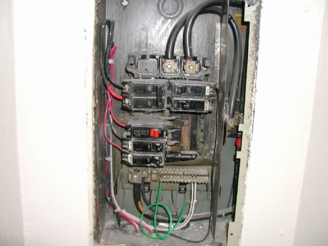

Douglas Hansen Posted October 24, 2012 Report Share Posted October 24, 2012 These pictures are from an apartment where someone was being shocked in their kitchen. The genius that "repaired" it decided to bond every neutral to the panel enclosures. The wiring was all in EMT. The picture with my meter shows a half amp on one of the pieces of EMT. That's the same amount of current a 60Watt bulb would draw, except in this case that energy is just being expended to heat up the conduit. In the kitchen, the client who hired us had experienced a mild shock when touching the stove and refrigerator at the same time, after the "repair." UL refers to these low level shocks as "startle current." They really can't have more voltage behind them than the voltage drop of the neutral, yet it is enough to get your attention. The inductive reactance heating of those conduits is racking up the electric bill. It will also create odd magnetic fields. If you have a high-end stereo, you will get a hum on your speakers. Even though the consequences are usually not severe, it is the first step on the slippery slope. Most electrical accidents are the result of more than one thing going wrong, and this one should be fixed. Click to Enlarge 44.81 KB Click to Enlarge 48.65 KB Quote Link to comment Share on other sites More sharing options...
Marc Posted October 24, 2012 Report Share Posted October 24, 2012 These pictures are from an apartment where someone was being shocked in their kitchen. The genius that "repaired" it decided to bond every neutral to the panel enclosures. The wiring was all in EMT. The picture with my meter shows a half amp on one of the pieces of EMT. That's the same amount of current a 60Watt bulb would draw, except in this case that energy is just being expended to heat up the conduit. In the kitchen, the client who hired us had experienced a mild shock when touching the stove and refrigerator at the same time, after the "repair." UL refers to these low level shocks as "startle current." They really can't have more voltage behind them than the voltage drop of the neutral, yet it is enough to get your attention. The inductive reactance heating of those conduits is racking up the electric bill. It will also create odd magnetic fields. If you have a high-end stereo, you will get a hum on your speakers. Even though the consequences are usually not severe, it is the first step on the slippery slope. Most electrical accidents are the result of more than one thing going wrong, and this one should be fixed. Click to Enlarge 44.81?KB Click to Enlarge 48.65?KB Maybe I should begin lugging that clamp-on around after all. Marc Quote Link to comment Share on other sites More sharing options...
Garet Posted October 24, 2012 Report Share Posted October 24, 2012 Maybe I should begin lugging that clamp-on around after all. It does occasionally prove useful. Cable Guy's should, too, if they want to stay alive. Download Attachment: Sub Bonding Wrong 001 08082001.jpg 270.92 KB Download Attachment: Sub Bonding Wrong 005 080104.jpg 306.94 KB Download Attachment: Sub Bonding Wrong 006 09100601.jpg 485.81 KB Quote Link to comment Share on other sites More sharing options...
