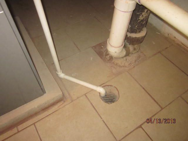

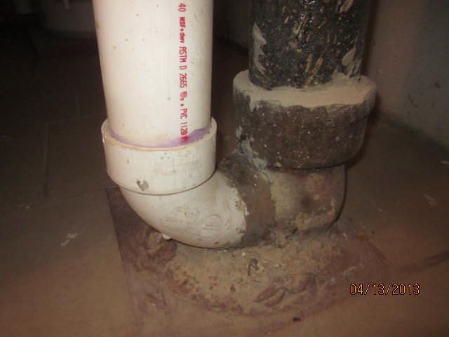

Mike Lamb Posted April 15, 2013 Report Share Posted April 15, 2013 This is a 2" PVC drain going into a 3" cast iron sanitary T with a 2" branch. I'm not sure if the connection is being made with caulk or mortar. Is it possible a neoprene compression donut is stuck in there? If not what are options for repair? Click to Enlarge 29.1 KB Click to Enlarge 30.26 KB Quote Link to comment Share on other sites More sharing options...
John Kogel Posted April 15, 2013 Report Share Posted April 15, 2013 It needs a Ferco connector to be done properly. Shiny metal and rubber connector with a clamp at each end. Quote Link to comment Share on other sites More sharing options...
LeePlace Posted April 16, 2013 Report Share Posted April 16, 2013 The Bell end is missing from the tee inlet (that would have been cut off). There is no point after the bell that a no hub band connection could be made or any other code approved connection could be made. The cast Iron fitting looks like it could be a cleanout tee which would have been located there at the floor. Recomend a plumber for evaluation of drainage loads, venting and piping design. Lee Quote Link to comment Share on other sites More sharing options...
kurt Posted April 16, 2013 Report Share Posted April 16, 2013 It looks like a hacked connection to a clean out. I'd trace the PVC back and see what it drained and if that thing that it drained was installed satisfactorily. I wouldn't call a plumber for something that's relatively easy to figure out. Quote Link to comment Share on other sites More sharing options...
LeePlace Posted April 16, 2013 Report Share Posted April 16, 2013 Kurt, How would you write this up in an inspection report? Lee Quote Link to comment Share on other sites More sharing options...
kurt Posted April 16, 2013 Report Share Posted April 16, 2013 Not sure, I'd have to see it. But, I'd start with the lack of a clean out and the hacked connection. If what I needed to see was buried in a wall, I'd indicate anyone that would do the hack job would do other bad stuff, and it's all in question until I could tear open the wall to look. The reason I wouldn't call a plumber is.....I've yet to find a plumber in Chicago with adequate analytical ability. They all blather nonsense, then sell people stuff they don't need. Then again, I'm dealing with Local 130, where anyone with decent analytical ability is drummed out of the corp. Maybe it's different elsewhere. Quote Link to comment Share on other sites More sharing options...
John Dirks Jr Posted April 17, 2013 Report Share Posted April 17, 2013 Not sure, I'd have to see it. But, I'd start with the lack of a clean out and the hacked connection. If what I needed to see was buried in a wall, I'd indicate anyone that would do the hack job would do other bad stuff, and it's all in question until I could tear open the wall to look. The reason I wouldn't call a plumber is.....I've yet to find a plumber in Chicago with adequate analytical ability. They all blather nonsense, then sell people stuff they don't need. Then again, I'm dealing with Local 130, where anyone with decent analytical ability is drummed out of the corp. Maybe it's different elsewhere. Its clear you have it figured out. I mean the general idea of how specific contractors are not competent. But you are the exception and your clients don't understand it. Whether you think it will solve the problem or not, the correct call is for repair by a qualified plumber. Seriously though, we all understand you but you are the one who has to put the recommendation in writing. Quote Link to comment Share on other sites More sharing options...
kurt Posted April 17, 2013 Report Share Posted April 17, 2013 The correct call is the one I'm comfortable making. If one doesn't want to make the call, or doesn't know how, they shouldn't. Quote Link to comment Share on other sites More sharing options...
