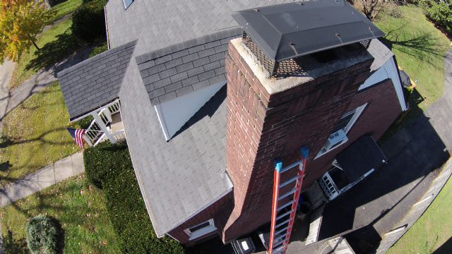

Ben H Posted December 18, 2014 Report Share Posted December 18, 2014 I record and watch the vid on my laptop. 15min flying. 15-20 watching. But make no mistake, you're not going to see a ripped shingle easily. My 30ft ladder was a far cry from the top of this chimney. The bot came in handy. Click to Enlarge 61.09 KB Quote Link to comment Share on other sites More sharing options...
