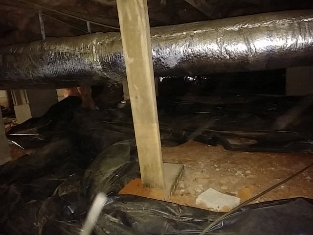

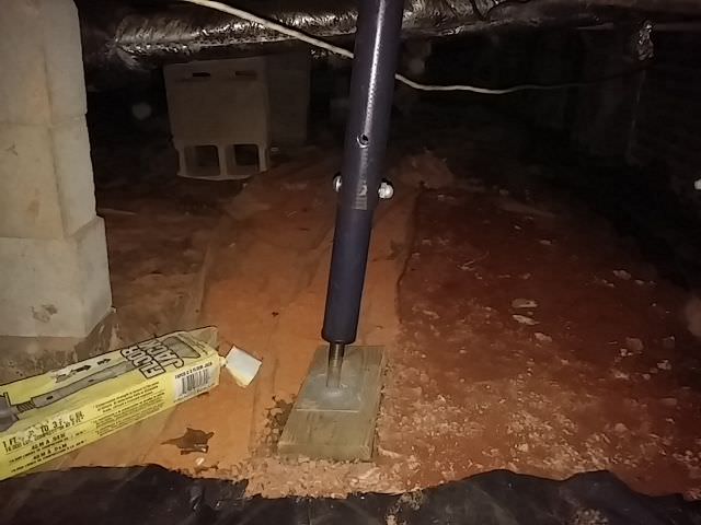

ductwork Posted February 24, 2015 Report Share Posted February 24, 2015 I was on an inspection yesterday, amazing the half attempted repairs one finds , even the insulation in the crawlspace was installed upside down. The electrical throughout the house was even worse . Click to Enlarge 50.1 KB Click to Enlarge 43.64 KB Click to Enlarge 43.2 KB Link to comment Share on other sites More sharing options...
Erby Posted February 25, 2015 Report Share Posted February 25, 2015 Uhm, gee, handyman. That's not really what they meant when they said "Pier and Beam" foundation. See a lot of that junky point load support system stuff hammered into place around here! Link to comment Share on other sites More sharing options...
Jim Baird Posted February 25, 2015 Report Share Posted February 25, 2015 ...very typical for the area, friend. Remember that sometimes "helper" supports like this do work, even if they are not by the code book. When I see them I usually call them out as "temporary" and advise that more permanent assemblies be installed. Link to comment Share on other sites More sharing options...
John Kogel Posted February 26, 2015 Report Share Posted February 26, 2015 When I see them I usually call them out as "temporary" and advise that more permanent assemblies be installed. Yes, I like that he left the box so the jack can be used again under his next house. [] People do what they have to do and get outa there ASAP. Nobody goes back until something breaks or leaks. Life goes on. Of course the new owners don't want that, so we cry foul. [] Link to comment Share on other sites More sharing options...
ductwork Posted February 26, 2015 Author Report Share Posted February 26, 2015 Exactly what I stated, "Unprofessional / temporary support was observed at the areas shown in the pictures, Floor joists and / or beams were supported by wood or a jack, simply propped under them. Although no immediate concern was observed, client should contact a qualified contractor for further information and / or evaluation. " Link to comment Share on other sites More sharing options...

Chad Fabry Posted February 26, 2015 Report Share Posted February 26, 2015 I'll expose my soft underbelly here- it'd be nice to see how some of the rest of you would actually write this up. The piers supporting the floor system are a hodge-podge of poorly conceived, poorly built assemblies employing a variety of inappropriate methods and materials. Have a competent trades-person install footings and rated columns to an approved standard or engineered design. Expect to spend low to mid four-figures. Link to comment Share on other sites More sharing options...
kurt Posted February 26, 2015 Report Share Posted February 26, 2015 Why is 3rd person passive voice easier? Blum's comment is as easy it gets. It's wrong because of XYZ, fix it. Link to comment Share on other sites More sharing options...
Jim Baird Posted February 26, 2015 Report Share Posted February 26, 2015 Sometimes for third person I will say, "My traverse of the crawlspace found..." --I found a number of what I call temporary supports for the floor system. Some are technically wrong, others are just sloppy. Have a competent contractor replace the temporary assemblies with more permanent ones, including spot footings.-- Link to comment Share on other sites More sharing options...
kurt Posted February 26, 2015 Report Share Posted February 26, 2015 "The floor platform and supports have multiple defects, including but not limited to: 1) blah 2) blah blah 3) blah blah blah 4) etc. until the list is finished These conditions should be repaired. Have a contractor tell you how much. There are a number of repair variables effecting cost, call me at my office to discuss them." I would have several pictures with red arrows pointing at the issues. Link to comment Share on other sites More sharing options...

Marc Posted February 26, 2015 Report Share Posted February 26, 2015 Several of the piers that support the structural floor system use the wrong materials or products, and are incorrectly installed. If they fail, the floor, ceiling and roof could all sag or otherwise become damaged. Ask a contractor who knows what he's doing to fix them. Marc Link to comment Share on other sites More sharing options...

Mike Lamb Posted February 26, 2015 Report Share Posted February 26, 2015 Click to Enlarge 43.2 KB Did you use a PS paint brush filter for this picture? It kind of looks like a painting. The floor framing is poorly reinforced. Basic construction standards have been ignored. Have a qualified carpenter evaluate further and reinforce as necessary. Repairs may (or may not be) extensive. Link to comment Share on other sites More sharing options...

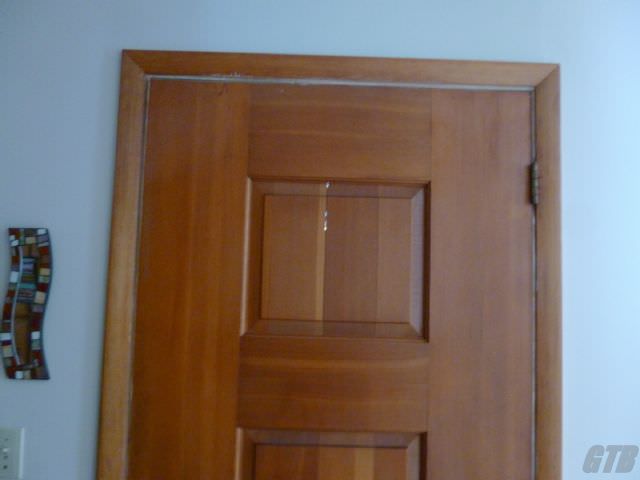

gtblum Posted February 26, 2015 Report Share Posted February 26, 2015 Here's the actual remark I just put in a report I'm writing right now. Click to Enlarge 25.1 KB The top panel in the front entrance door has split to where daylight can be seen through the crack. Have a carpenter repair this to prevent a loss of heat that will result in higher energy costs. Done deal. Link to comment Share on other sites More sharing options...
