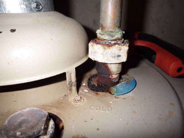

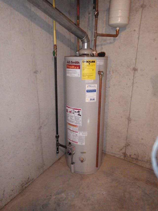

Mark P Posted June 30, 2016 Report Share Posted June 30, 2016 First time I've ever come across this. A.O Smith water heater manufactured in 2003, same year as the house was built. The vent pipe is not shared with anything else. The draft hood is well attached. Nothing else seemed wonky. I'm looking for your thoughts... Click to Enlarge 37.97 KB Quote Link to comment Share on other sites More sharing options...

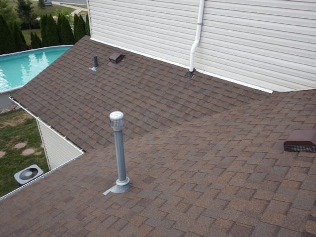

Marc Posted June 30, 2016 Report Share Posted June 30, 2016 What's the vertical height of the flue? It may have been due to conditions no longer present like a flue too short. The flue pipe in the photo looks new. Marc Quote Link to comment Share on other sites More sharing options...
Mark P Posted June 30, 2016 Author Report Share Posted June 30, 2016 I don't know the height. The vent goes up at a 45 degree angel for 6+ feet then goes straight up and terminates above the one story garage. Click to Enlarge 61.59 KB Click to Enlarge 55.44 KB Quote Link to comment Share on other sites More sharing options...

Mark P Posted June 30, 2016 Author Report Share Posted June 30, 2016 IDK - The home is vacant. This is what I put in the report, but I have not sent it out yet, so it may change. FYI: The water line connections to the water heater are scorched. This was caused by hot exhaust gasses spilling out from under the draft hood. I found no problems with the vent pipe. I can only assume that the condition that existed for the scorching to occur, no longer exist. Ask the seller if they know anything about this. Quote Link to comment Share on other sites More sharing options...
Mike Lamb Posted July 1, 2016 Report Share Posted July 1, 2016 I would skip the assumption about no longer back drafting. An HVAC guy needs to consider. Quote Link to comment Share on other sites More sharing options...
David Meiland Posted July 1, 2016 Report Share Posted July 1, 2016 I agree, skip the assumption about no longer backdrafting. It looks like there was a huge amount of exhaust gas spillage, possibly because of a negative pressure situation in the garage, or perhaps a dead squirrel blocking the vent pipe. It could still happen sometimes, and needs to be ruled out by not you. Quote Link to comment Share on other sites More sharing options...

Mark P Posted July 1, 2016 Author Report Share Posted July 1, 2016 Thanks for the comments. The water heater is in the unfinished basement, not the garage. The exhaust vent passes through the garage attic. I'll pass the ball to a HVAC guy to evaluate the venting details. Quote Link to comment Share on other sites More sharing options...
Steven Hockstein Posted July 1, 2016 Report Share Posted July 1, 2016 Maybe the vent run is too long and there is moisture condensing in the vent pipe AND there is back-drafting. This may result in moist fumes blowing onto the fitting and causing the corrosion Additionally, there seems to be additional corrosion caused by dissimilar metals at the fitting. Quote Link to comment Share on other sites More sharing options...
Hearthman Posted July 1, 2016 Report Share Posted July 1, 2016 A pro certified in CO/combustion analysis should test and correct as needed. The vent connector should rise straight up as far as possible while still making room for the 1/4" per LF slope up to the vent. The vent connector should be supported at the offset and every four feet. The vent should be inspected for obstruction (level II). There could be a a flow obstruction such as damaged inner liner or the use of TEK screws pushing in the inner liner instead of piercing it and pulling the two single walls together. If the B-vent joints have any screws, this is a common defect. A worst case depressurization test should be conducted. There is either a flow obstruction or a depressurization issue WRT the CAZ. This is just another reason to remove draft hoods--they work just as designed. They are the most dangerous item in a home. An NCI pro knows how to make the repair to a bullhead tee with double acting barometric damper and spill switch. Backdraft must always be investigated and corrected or somebody could wake up dead. Quote Link to comment Share on other sites More sharing options...
