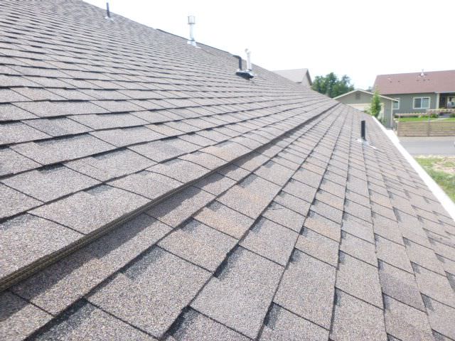

Trent Tarter Posted July 21, 2016 Report Share Posted July 21, 2016 First time I have seen this before. New builder in area is building homes with a secondary ventilation strip that runs full length at both sides of home. Seems like a good idea as ventilation issues are commonly found down below eaves. The home has ridge vent, soffit vent, and these additional vents placed low on roof a few feet above eaves. Is there a specific name for these type of vents? Click to Enlarge 84.05 KB Link to comment Share on other sites More sharing options...
Chad Fabry Posted July 21, 2016 Report Share Posted July 21, 2016 There are a number of trade names but they're called shingle-over intake vents. Link to comment Share on other sites More sharing options...
Trent Tarter Posted July 22, 2016 Author Report Share Posted July 22, 2016 Intake vents works for me, thanks. Link to comment Share on other sites More sharing options...
Darren Posted July 22, 2016 Report Share Posted July 22, 2016 Looks like the Edge Vent. http://www.airvent.com/products/intake- ... -edge-vent Link to comment Share on other sites More sharing options...

John Kogel Posted July 23, 2016 Report Share Posted July 23, 2016 In some districts of the Golden State (Hi Denny), if houses are built to the minimum dist from the sideline, the only lower venting allowed is up on the deck like that. Those vents helps stop fires from jumping from house to house. Link to comment Share on other sites More sharing options...

kurt Posted July 26, 2016 Report Share Posted July 26, 2016 Looks like the Edge Vent. http://www.airvent.com/products/intake- ... -edge-vent These things are a nightmare in ice dam conditions. They got some initial use around here, and then everyone backed off because of water flowing into eaves. Link to comment Share on other sites More sharing options...
