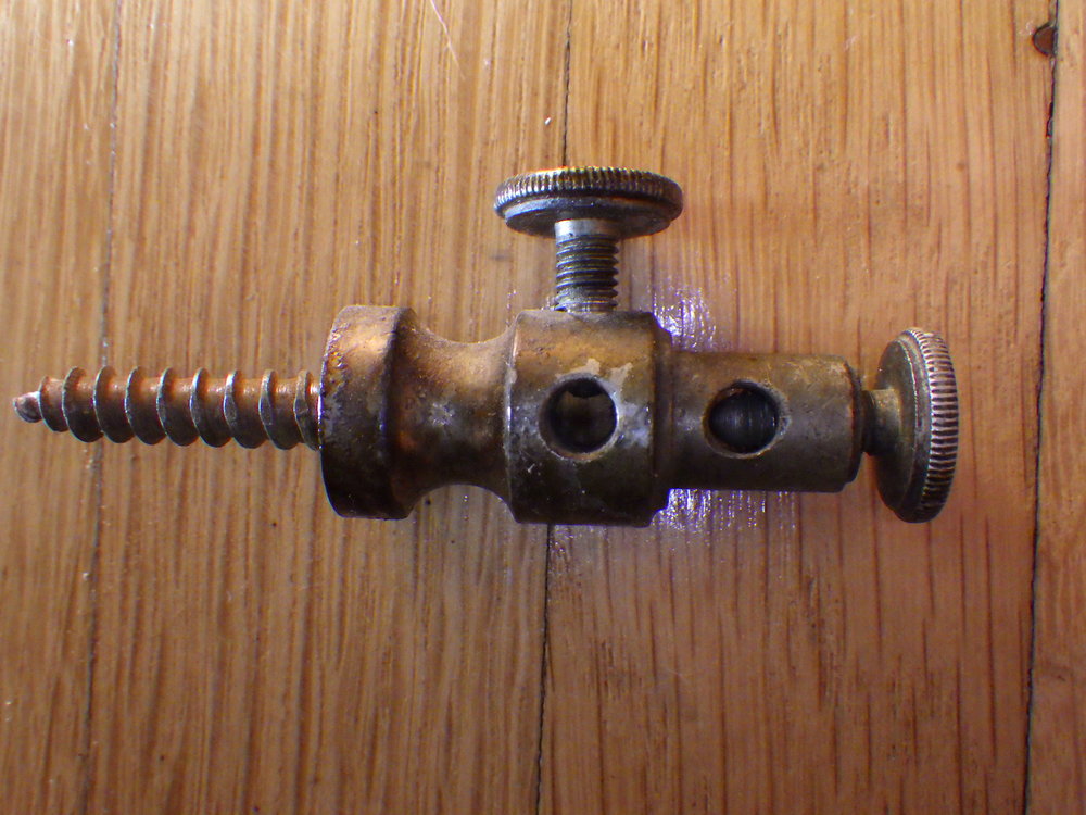

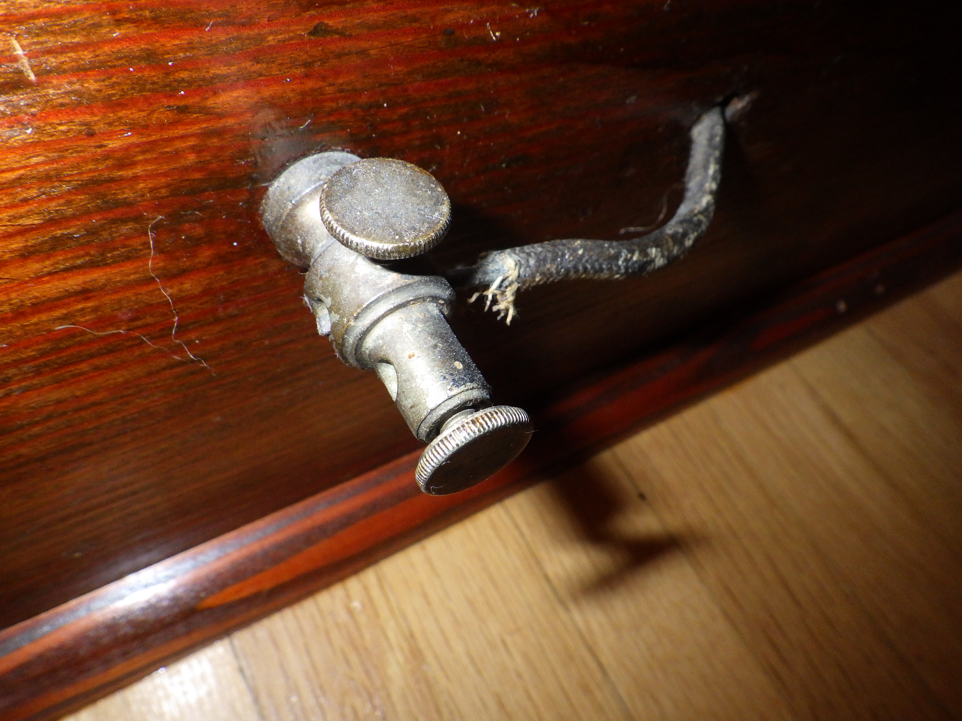

Jim Katen Posted February 9, 2018 Report Share Posted February 9, 2018 This device is screwed onto a baseboard in the living room of a 1911 craftsman bungalow in SE Portland (Westmoreland/Sellwood). A single fabric-covered wire emerges from the baseboard and terminates under one of the knurled screws. The other screw is empty. The wire is not energized and I can't find its other end in the crawlspace below or in the attic above. An old radio grounding terminal? Antenna connection point? Does anyone recognize it? Quote Link to comment Share on other sites More sharing options...
mjr6550 Posted February 14, 2018 Report Share Posted February 14, 2018 It is either an electric doorstop or a baseboard mounted wire extender. ...Or Kibbel will know what it is. Quote Link to comment Share on other sites More sharing options...
Jim Baird Posted February 14, 2018 Report Share Posted February 14, 2018 ...it's an extension to the telegraph receiver, before they had phone nooks. Quote Link to comment Share on other sites More sharing options...
Rob Amaral Posted April 1, 2018 Report Share Posted April 1, 2018 Probably radio antenna... I find remnants of old antennas in attics all the time around Boston.. Quote Link to comment Share on other sites More sharing options...
Jim Katen Posted April 1, 2018 Author Report Share Posted April 1, 2018 Radio grounding connection or radio antenna are still my prime suspects. The thing is, most old radio grounds & antennas consisted of a simple wire connected directly to the radio. Sometimes they used a radio antenna plug, which I see several times a year. This little gadget just seems awfully involved for a simple radio splice point. After seeing Jim Baird's comment, I looked at lots of pictures of telegraph equipment and this thing really looks like part of that equipment. I doubt that the house had a telegraph, but someone might have re-purposed a piece of telegraph equipment as the antenna or ground connection for their radio. Quote Link to comment Share on other sites More sharing options...
Nolan Kienitz Posted April 2, 2018 Report Share Posted April 2, 2018 This museum in Bellingham, WA might have something to help provide more data. Fellow from this museum has also written a book about the history of telegraphy that is available at Amazon and elsewhere. http://www.sparkmuseum.org/ Quote Link to comment Share on other sites More sharing options...
John Kogel Posted April 2, 2018 Report Share Posted April 2, 2018 (edited) A telegraph office would be possible if the location seems right. If it is just a residence, it is probably as mentioned by Rob, nothing more than an antenna connector for the big console radio. They didn't start having internal loop antennas until the early 30's. And for short wave, they'd add a long wire antenna, maybe strung up in the attic. Edited April 2, 2018 by John Kogel Quote Link to comment Share on other sites More sharing options...
Nolan Kienitz Posted April 3, 2018 Report Share Posted April 3, 2018 I've been on a mission and I think I have found the manufacture source of the "binding post". Link will take you to the website for the catalog from Bunnell Telegraphic and Electrical catalog with a suggested published date of 1901. Image is from the page relating to the "binding posts" the seem to be quite similar to Katen's image. http://www.telegraph-history.org/bunnell-tel-elec-catalog/index.html 2 Quote Link to comment Share on other sites More sharing options...
Bill Kibbel Posted April 3, 2018 Report Share Posted April 3, 2018 Thanks Nolan. Just recently saw a pair in a very old train depot. Quote Link to comment Share on other sites More sharing options...
Jim Katen Posted April 3, 2018 Author Report Share Posted April 3, 2018 Thanks Nolan. It looks very similar to "Style A" which would have set someone back $0.17. Clearly, it's a repurposed piece of telegraph equipment. Thanks again for the leg work. Quote Link to comment Share on other sites More sharing options...
