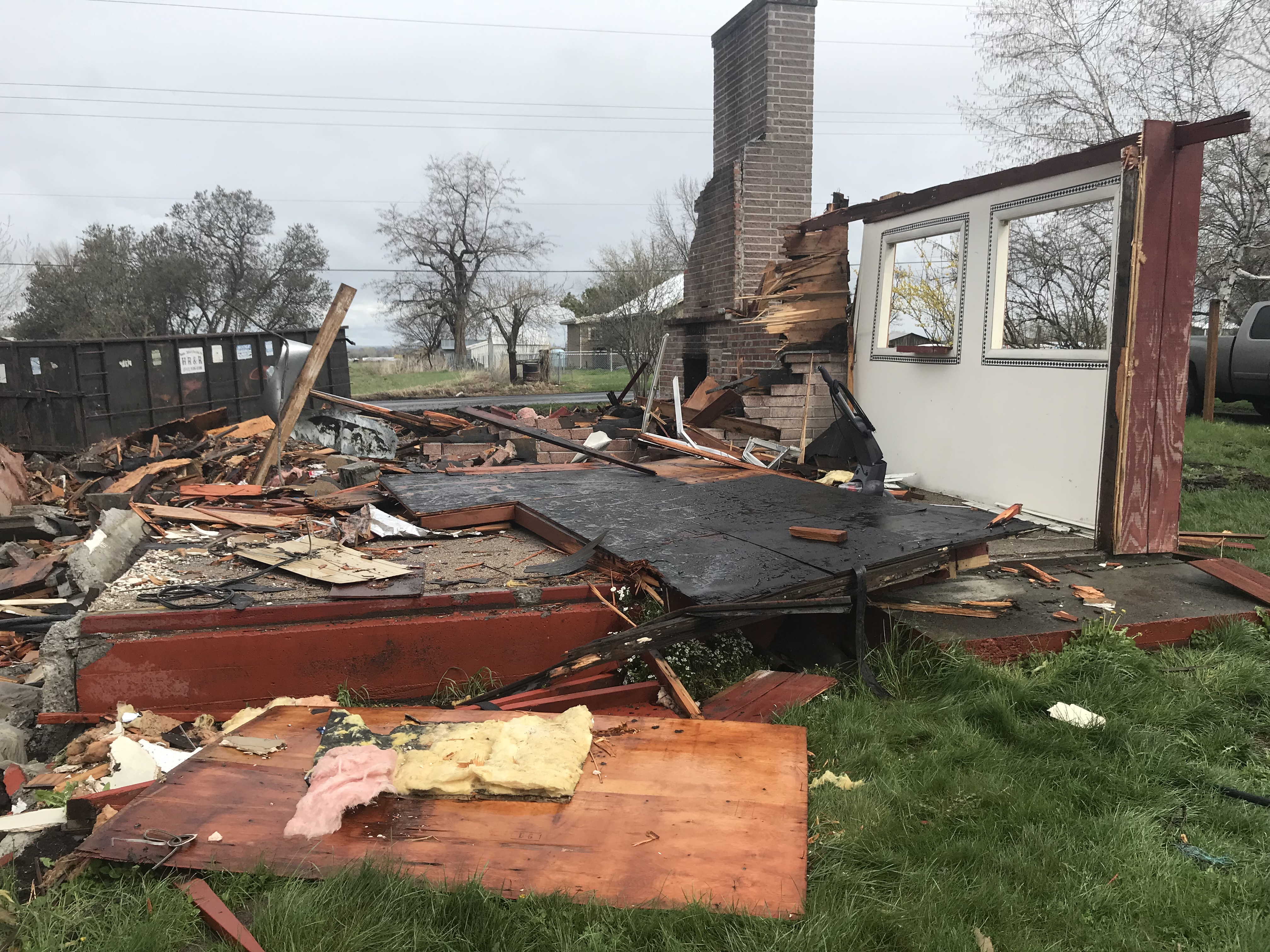

Trent Tarter Posted December 12, 2020 Report Share Posted December 12, 2020 A few years ago I had a property that I declined the inspection. The house was to far gone and had lots of unpermitted additions. Long story short, my client went foreword in buying the property for the building site, I ended up tearing the house down for her. Quote Link to comment Share on other sites More sharing options...

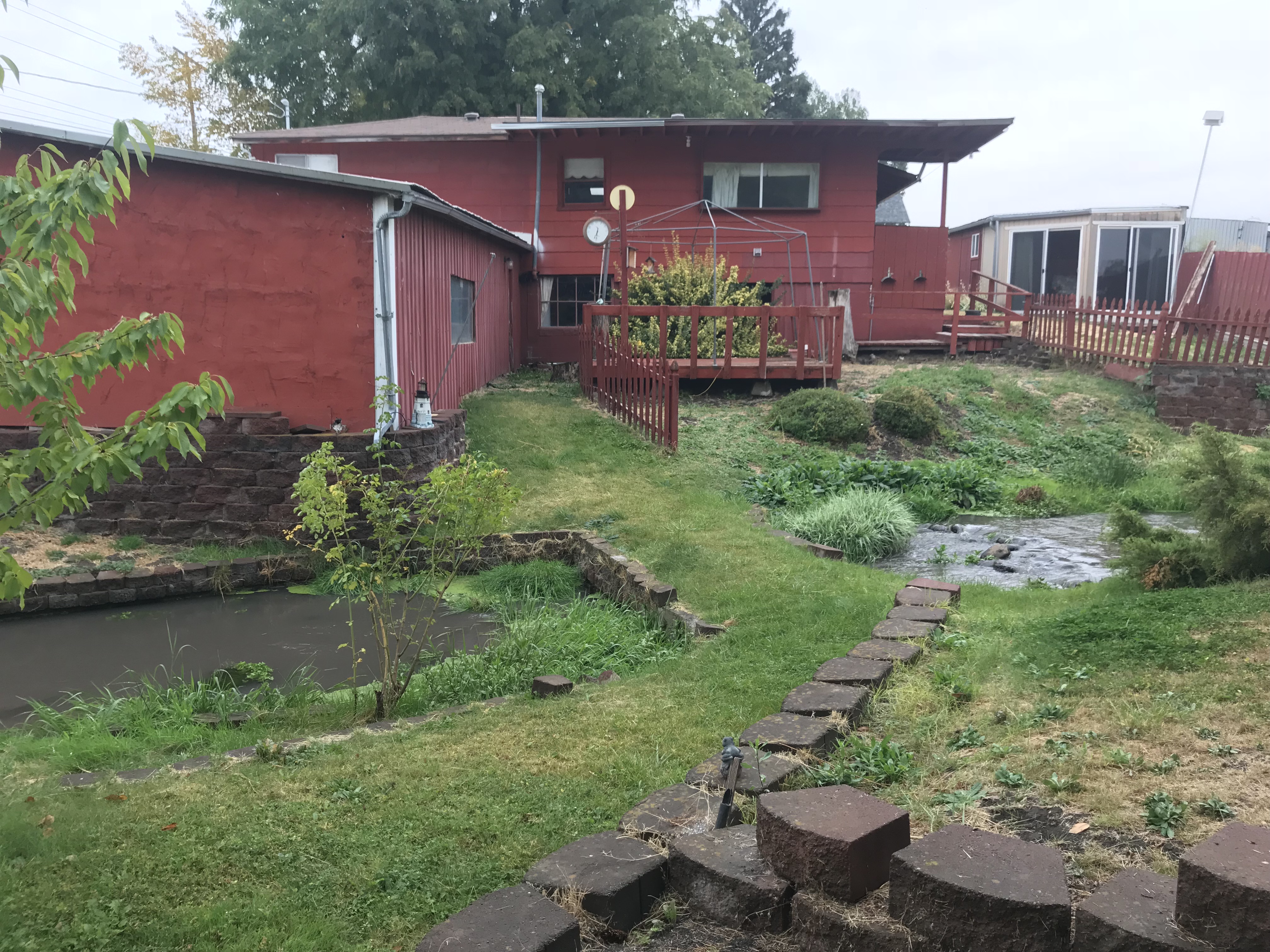

Jim Baird Posted December 13, 2020 Report Share Posted December 13, 2020 I usually leave crawl till end, and when I crawled a 70's ranch for a friend. I pushed my screwdriver through every joist I touched, declared house a bust, so my client made an offer only for the site, and declared he would remove the building one rolloff at a time. Seller accepted, and my friend moved in, though there are areas inside where floors are caving and he can't enter them. Quote Link to comment Share on other sites More sharing options...
