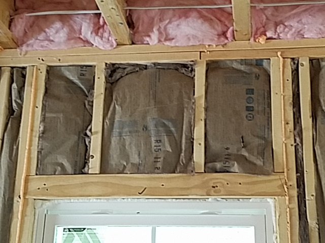

mgbinspect Posted September 23, 2019 Report Share Posted September 23, 2019 Yesterday, during a pre-drywall new construction inspection, I noticed that the framed window opening headers were 2 x 4's instead of 2 x 6's or 2 x 8's. The wall thickness is six inches, so there are three 2 x 4's in each header. Since this is the first time I've seen this, I wonder if any of my fellow home inspectors have run across this and found it to be an approved practice? Thanks in advance for any input. Quote Link to comment Share on other sites More sharing options...
Tom Raymond Posted September 23, 2019 Report Share Posted September 23, 2019 The actual header is likely at the rim joist. Did you pull back any insulation? Quote Link to comment Share on other sites More sharing options...
mgbinspect Posted September 23, 2019 Author Report Share Posted September 23, 2019 Hey Tom! I reached in to determine if any of the members were taller. They were not. Quote Link to comment Share on other sites More sharing options...
Marc Posted September 23, 2019 Report Share Posted September 23, 2019 (edited) 6 minutes ago, Tom Raymond said: The actual header is likely at the rim joist. Did you pull back any insulation? How would the ceiling load be transferred to a rim joist on a TIJ ceiling? Take a look at Table R 502.5(1). Edited September 23, 2019 by Marc Quote Link to comment Share on other sites More sharing options...
mgbinspect Posted September 23, 2019 Author Report Share Posted September 23, 2019 (edited) 6 minutes ago, Marc said: How would the ceiling load be transferred to a rim joist on a TIJ ceiling? (I was trying to put that together in my head as well...) Edited September 23, 2019 by mgbinspect Quote Link to comment Share on other sites More sharing options...
Tom Raymond Posted September 23, 2019 Report Share Posted September 23, 2019 Joist hangers. By moving the header into the platform you create room for installation. Especially important if you're going to rely on inefficient fiberglass. Quote Link to comment Share on other sites More sharing options...
mgbinspect Posted September 23, 2019 Author Report Share Posted September 23, 2019 Back to the subject - has anyone run across this? I think it's panelized construction. Quote Link to comment Share on other sites More sharing options...
Marc Posted September 23, 2019 Report Share Posted September 23, 2019 http://www.co.stevens.wa.us/landservices/documents/WALLFRAMINGSECTION.pdf Page 4 Quote Link to comment Share on other sites More sharing options...
Marc Posted September 23, 2019 Report Share Posted September 23, 2019 Just now, mgbinspect said: Back to the subject - has anyone run across this? I think it's panelized construction. I've never seen wall headers any smaller than 2X6 in my 'unsophisticated' area. 1 Quote Link to comment Share on other sites More sharing options...
mgbinspect Posted September 23, 2019 Author Report Share Posted September 23, 2019 3 minutes ago, Marc said: http://www.co.stevens.wa.us/landservices/documents/WALLFRAMINGSECTION.pdf Page 4 Thanks Marc! I don't see this configuration in there, so I'll call it out as needing further evaluation. Have a great day! Quote Link to comment Share on other sites More sharing options...
Tom Raymond Posted September 23, 2019 Report Share Posted September 23, 2019 Nothing in the code says that the header has to be at the top of the window. There is no prohibition of placing it in the platform assembly. In fact, the TJI manuals typically detail several options for doing exactly that. Quote Link to comment Share on other sites More sharing options...
Chad Fabry Posted September 23, 2019 Report Share Posted September 23, 2019 Supporting roof, ceiling, and one center bearing floor, the IRC says that 2 2x4's can span 27 inches. with a 50# snow load. Where you are, they can span 32 inches. 3 2x4's aren't in the chart but they're likely up to that task. Look at the plans. Quote Link to comment Share on other sites More sharing options...
