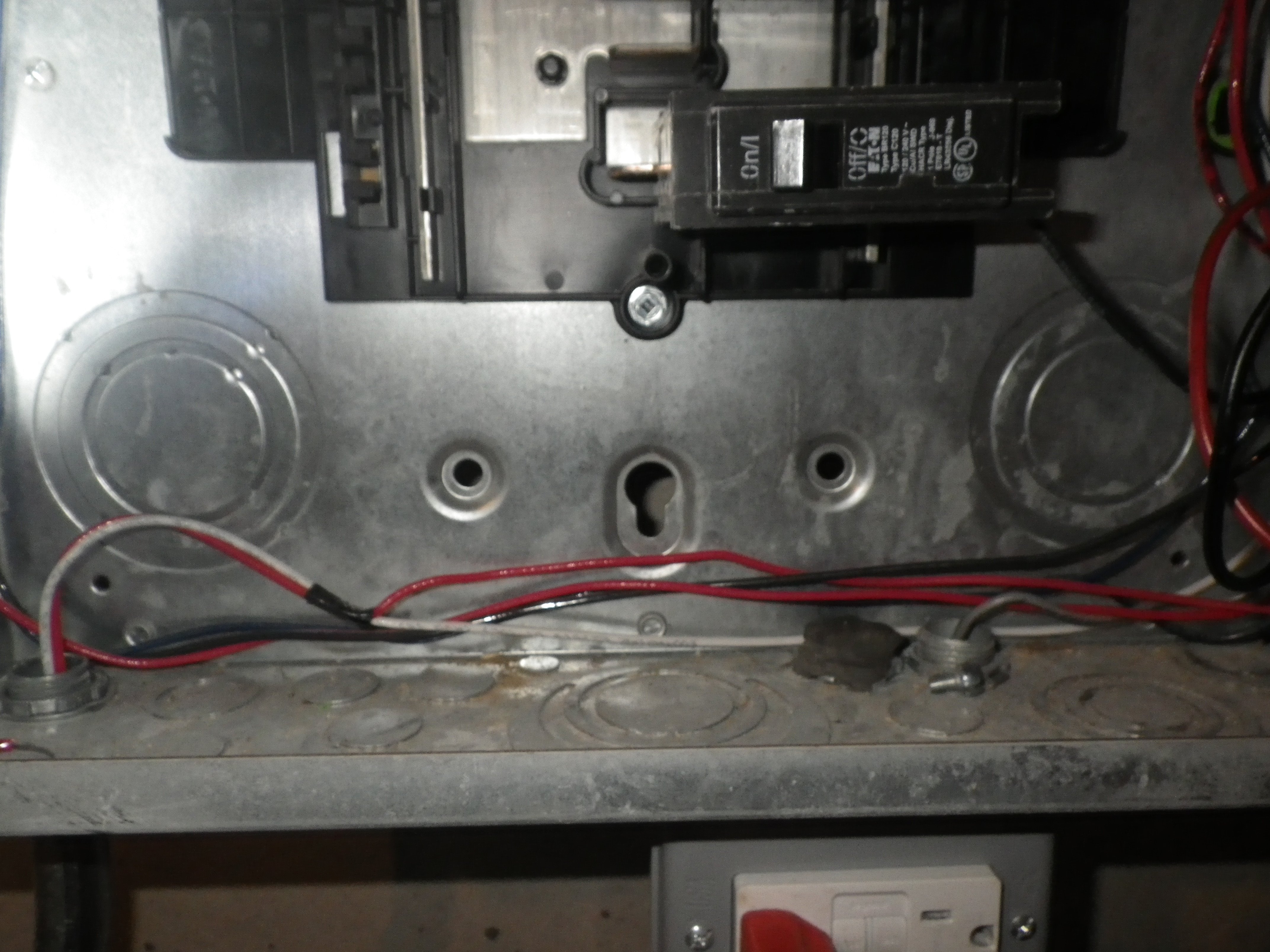

Jerry Simon Posted August 17, 2020 Report Share Posted August 17, 2020 You guys flag these three small open holes on the back of a main electrical panelboard's metal cabinet as needing to be sealed? Cabinet is not mounted flush against foundation wall (one could stick their pinkie into the larger hole). Same holes at top of cabinet if you're familiar with this brand. Quote Link to comment Share on other sites More sharing options...

Jim Katen Posted August 19, 2020 Report Share Posted August 19, 2020 While there probably is a standard for enclosures, and it probably does include restrictions on the placement and sizing of these openings, I don't know what those would be. The 9/16" noted in the book is just an example of a largish opening that doesn't need to be covered. The general rule is that knockouts always need to be covered - either by having clamps or bushings and wiring run through them, or by having knockout covers installed. Holes that the manufacturer made to accommodate mounting hardware do not need to be covered, even though they can get to be quite large. That said, in my reports, I don't recommend covering mounting holes unless I think that a mouse can get through or, more to the point, if I see evidence that mice have gotten through. Quote Link to comment Share on other sites More sharing options...

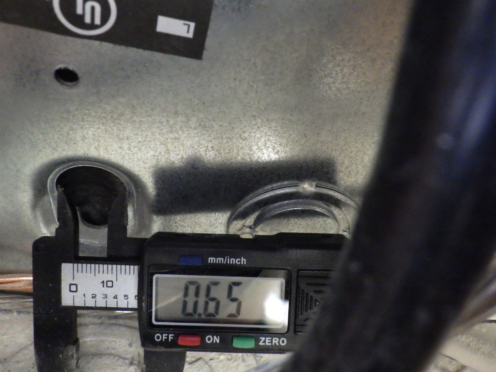

Jim Katen Posted August 23, 2020 Report Share Posted August 23, 2020 From another Eaton panel (the example in Electrical Inspection of Existing Dwellings is also an Eaton panel) earlier this week. This hole, at .65" is slightly larger than 5/8". My guess is that a mouse would have to be pretty darn motivated to get through this hole. Quote Link to comment Share on other sites More sharing options...
Jerry Simon Posted August 23, 2020 Author Report Share Posted August 23, 2020 2 hours ago, Jim Katen said: From another Eaton panel (the example in Electrical Inspection of Existing Dwellings is also an Eaton panel) earlier this week. This hole, at .65" is slightly larger than 5/8". My guess is that a mouse would have to be pretty darn motivated to get through this hole. Maybe, maybe not. I've been fighting those suckers for five years. EVERYTHING sealed outside, but finally had to spray-foam my wooden knee walls that they kept chewing through. Little assholes. Mouse Holes I originally was concerned about arcing/burning inside the panelboard that could escape through the openings. Quote Link to comment Share on other sites More sharing options...

Chad Fabry Posted August 26, 2020 Report Share Posted August 26, 2020 On 8/23/2020 at 3:01 PM, Jim Katen said: From another Eaton panel (the example in Electrical Inspection of Existing Dwellings is also an Eaton panel) earlier this week. This hole, at .65" is slightly larger than 5/8". My guess is that a mouse would have to be pretty darn motivated to get through this hole. Your vernier digital indicator is off. The scale shows 15mm and .60 inches. .60 inches which is almost exactly correct. 16 mm is almost exactly 5/8 inches. 16.5 mm =.65 inches Quote Link to comment Share on other sites More sharing options...

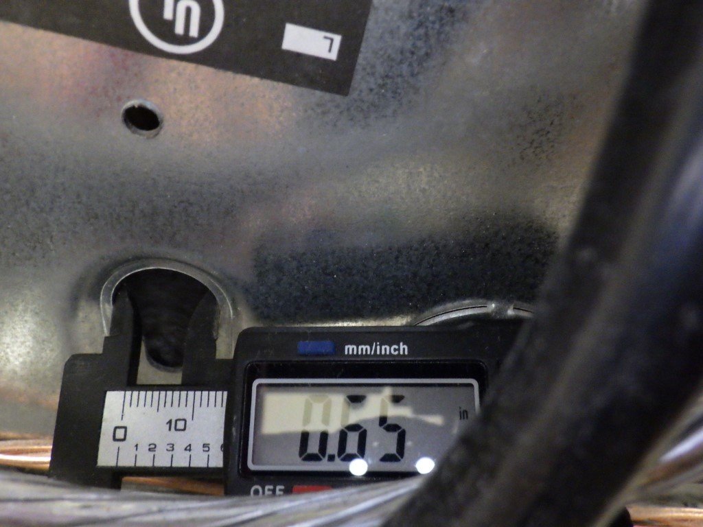

Jim Katen Posted August 27, 2020 Report Share Posted August 27, 2020 Good observation, but you can't go by the rule markings in this view. The front section of the digital display has some thickness, so with the camera slightly to the right, there's some parallax error. I zeroed out the digital reading before measuring it. It should be pretty darn accurate. If I were to move the camera to the left, it would show .65 on the rule as well. Actually, here's a previous attempt at a photo where the lighting was messed up. The camera is even further to the right and the parallax is slightly greater. Quote Link to comment Share on other sites More sharing options...
