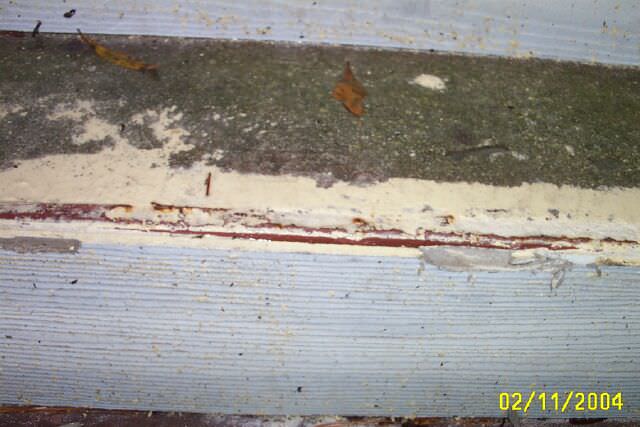

Danny Pritchard Posted February 11, 2004 Report Share Posted February 11, 2004 I found this interesting today.These are steps going to a 2nd floor condo unit.I was told these are the homeowners responsibility.The present owner has glued hardieboard to what I would guess is rusted out metal risers.This was the buyers biggest concern.Walking down the stairs after the inspection the hardieboard gave (2nd photo)way under the buyers foot and he almost fell down the stairs. Danny Pritchard Download Attachment: Hardieboard at steps0002.jpg 82.46 KB Download Attachment: Hardieboard at steps0001.jpg 86.32 KB Quote Link to comment Share on other sites More sharing options...

Steven Hockstein Posted February 17, 2004 Report Share Posted February 17, 2004 The feedback from the contractors that I know is generally positive. Two complaints have been that it can warp and become wavy in certain exposures and it is brittle and cracks if hit hard (especially during cold weather). Compared to the cost of natural wood siding or brick veneer, it is a reasonable option as an upgrade from vinyl. I am sure that installation as stair treads is nowhere to be found in the manufacturer's published installation specifications. Quote Link to comment Share on other sites More sharing options...
