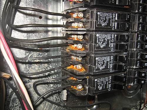

Chris Bernhardt Posted December 23, 2006 Report Share Posted December 23, 2006 I guess I can always write these up for an electrician to evaluate and determine the course of action but I was curious since the NEC says that you can't use a cleaner or do anything that might cause damage and there is the potential here for things I can't see and possibly future contact problems. Shouldn't one just replace the breakers to clear all doubt? Download Attachment: jse_IMG_8278.jpg 49.18 KB Chris, Oregon Quote Link to comment Share on other sites More sharing options...
inspectorjeff Posted December 23, 2006 Report Share Posted December 23, 2006 I would recommend replacements as a second action. The first action would be to determine and correct the water intrusion issue. Quote Link to comment Share on other sites More sharing options...
Eric B Posted December 23, 2006 Report Share Posted December 23, 2006 Let an electrician decide the course of action, that's his job. I'm not sure that you want to take responsibility for tell the client how to fix it. Quote Link to comment Share on other sites More sharing options...
Chris Bernhardt Posted December 23, 2006 Author Report Share Posted December 23, 2006 I certainly didn't mean to imply that someone other than a qualifed electrician work on the panel. But not all electicians just because they are licensed are qualified to evaluate stuff. I have certainly talked to my share who didn't apparently know the NEC very well. I can't imagine why it would be reasonable to say that rust on terminals is OK. As for the moisture source, that was a mystery. I couldn't see how the moisture had got there. The panel was down in a finished basement and the rust was only on one side of the panel mainly being right on the breakers. Chris, Oregon Quote Link to comment Share on other sites More sharing options...
Bill Kibbel Posted December 23, 2006 Report Share Posted December 23, 2006 As for the moisture source, that was a mystery. I couldn't see how the moisture had got there. The panel was down in a finished basement and the rust was only on one side of the panel mainly being right on the breakers. I find that condition frequently. It's usually from water entering the meter base. The SEC acts like a drain house from the bottom of the meter base into the service equipment panel, often dripping down the breakers on one side. Quote Link to comment Share on other sites More sharing options...
Chris Bernhardt Posted December 23, 2006 Author Report Share Posted December 23, 2006 I think your right now that I think about it. I did write the service up for no drip loop and exposed service points and no sealant around the mast. Chris, Oregon Quote Link to comment Share on other sites More sharing options...
Jim Katen Posted December 23, 2006 Report Share Posted December 23, 2006 Originally posted by inspectorjeff I would recommend replacements as a second action. The first action would be to determine and correct the water intrusion issue. I agree. Once a breaker's been wet it should be replaced. - Jim Katen, Oregon Quote Link to comment Share on other sites More sharing options...

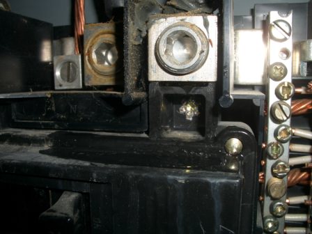

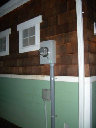

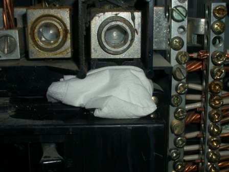

randynavarro Posted December 28, 2006 Report Share Posted December 28, 2006 Found my camera. Here's some shots of my wet electrical panel. View of meter base configuration. Perfectly normal and dry. The eave protects it from getting wet. Download Attachment: ExteriorMeter.JPG 75.42 KB Close up of main lug. Look carefully and you'll see the little drip right at the bottom of it. Download Attachment: CloseUpLug.JPG 87.08 KB My solution. Its brilliant!! A paper towel to soak up the water - doesn't let it drip down on to the rest of the breakers. Gotta rival Goodman's water heater drip pan for creativity! Download Attachment: PaperTowelLug.JPG 86.52 KB For those that have offered opinions as to the cause and / or solution of this water intrusion, trust me, I've addressed them all and have come to no clear solutions. Quote Link to comment Share on other sites More sharing options...
Jim Katen Posted December 28, 2006 Report Share Posted December 28, 2006 Originally posted by randynavarro . . . For those that have offered opinions as to the cause and / or solution of this water intrusion, trust me, I've addressed them all and have come to no clear solutions. Condensation. - Jim in Oregon Quote Link to comment Share on other sites More sharing options...
randynavarro Posted December 28, 2006 Report Share Posted December 28, 2006 Jim, I'd buy that but why is there condensation on only one of the lines and not all three? Quote Link to comment Share on other sites More sharing options...
Jim Katen Posted December 28, 2006 Report Share Posted December 28, 2006 Originally posted by randynavarro Jim, I'd buy that but why is there condensation on only one of the lines and not all three? Air currents are fickle things. Block the passage of air between the meter base and the service panel and see if the water stops. - Jim in Oregon Quote Link to comment Share on other sites More sharing options...
randynavarro Posted December 28, 2006 Report Share Posted December 28, 2006 The meter base is mounted directly behind the panel; connected with a 1 1/2" (or so) nipple. So, foaming inside the 1 1/2" nipple around the service cables? Quote Link to comment Share on other sites More sharing options...
Jim Katen Posted December 28, 2006 Report Share Posted December 28, 2006 Originally posted by randynavarro The meter base is mounted directly behind the panel; connected with a 1 1/2" (or so) nipple. So, foaming inside the 1 1/2" nipple around the service cables? I wouldn't use foam. Too messy. Try packing some loose fiberglass in the nipple. Use a dowel or pencil to really close up every gap. That way you can easily remove it if you need to. - Jim Katen, Oregon Quote Link to comment Share on other sites More sharing options...
chicago Posted December 28, 2006 Report Share Posted December 28, 2006 Randy I noticed that window on the right inside of the breaker panel. I assume you checked into that having any effect on the panel? Quote Link to comment Share on other sites More sharing options...
randynavarro Posted December 28, 2006 Report Share Posted December 28, 2006 Originally posted by chicago Randy I noticed that window on the right inside of the breaker panel. I assume you checked into that having any effect on the panel? Not following you. Are you talking about the window to the left of the panel in the picture of the exterior? Quote Link to comment Share on other sites More sharing options...
chicago Posted December 29, 2006 Report Share Posted December 29, 2006 Yes since on the inside it would be to the right of the panel.the lug with moisture is also on that side or am I following wrong? Quote Link to comment Share on other sites More sharing options...
randynavarro Posted December 29, 2006 Report Share Posted December 29, 2006 I'm tracking with you now. Yes, the window is on the same side as the leaking lug. If you're implying that the window is leaking, then not a chance. I just had the wall opened up about 1 year ago to add some circuits and the wall is dry as a bone. I think this will be a mystery until I get the time, if ever, to do some troubleshooting and experimentation with different solutions. Quote Link to comment Share on other sites More sharing options...
