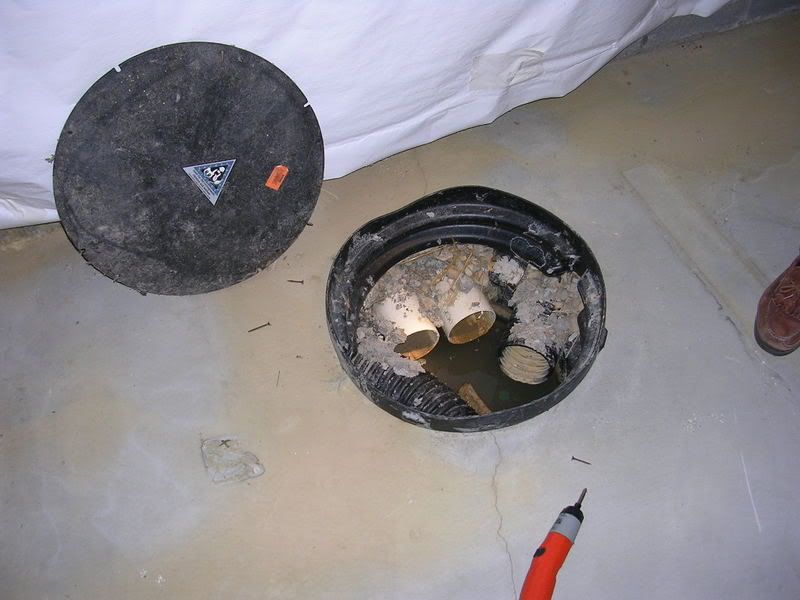

Terence McCann Posted March 9, 2007 Report Share Posted March 9, 2007 1st home I did in this development had a crock installed, pipes from foundation drainage system leading to it and an electrical outlet install right above the crock however, no pump. The lid was screwed on as well. I thought it might have been missed on original install but I did another home on the same street today with the same setup. Why go through all the work and then leave the sump pump out? Is there a system out there that is designed to work without a pump? Quote Link to comment Share on other sites More sharing options...

ozofprev Posted March 9, 2007 Report Share Posted March 9, 2007 Builder or AHJ may have wanted the option left open. "I don't think we'll need them, but..." Quote Link to comment Share on other sites More sharing options...
fqp25 Posted March 9, 2007 Report Share Posted March 9, 2007 I have seen practically the same thing in some developments around my neck of the woods. One time I almost fell in an open pit that was covered up by the moisture barrier in a crawl space. I think it is an oversight from the builder or plumber. Or maybe it's a result of being cheap to lower the bottom line, and the installation of a pump would fall onto the home buyer. Either way it's crappy workmanship, in my book... Quote Link to comment Share on other sites More sharing options...
StevenT Posted March 9, 2007 Report Share Posted March 9, 2007 I doubt if the lack of a pump is an oversight, unless the house was spec'd with a pump from the get go. If it's not, what they did do is great and I would install the pump without any complaints. Quote Link to comment Share on other sites More sharing options...
hausdok Posted March 9, 2007 Report Share Posted March 9, 2007 Hi, I agree. Heck, you could even clean the fines out of those danged drains by going through that well. OT - OF!!! M. Quote Link to comment Share on other sites More sharing options...
Mark P Posted March 10, 2007 Report Share Posted March 10, 2007 I believe the builders leave the pumps out to save money. Same reason they don't install AFIs or garbage disposals. Quote Link to comment Share on other sites More sharing options...
Les Posted March 10, 2007 Report Share Posted March 10, 2007 Mark they are disposers! I see hundreds of sumps without pumps. Usually no reason for pump, so why put one in! I have two homes with sumps and no pumps. One on a small lake and gravity does the job as Chad said and the other just drains into a bar ditch. Put a screen over the incoming pipe and keep your fishin minnies happy. Quote Link to comment Share on other sites More sharing options...
StevenT Posted March 10, 2007 Report Share Posted March 10, 2007 I agree that if the sump is draining there is no need for a pump... if it is draining. I would like to see the water table lower that what is APPEARS to be in the photo. Of course, there is the possibility that in the pic, something happened to quickly fill the sump and the drainage did not yet catch up. Upon a closer look at the pic, there appears to be what looks like black corregated flex tubing. (from 6 to 9 oclock) The water level seems to be the bottom of the tube. There is a chance that the tube is peforated and allowing the water to drain out elsewhere. Quote Link to comment Share on other sites More sharing options...
Terence McCann Posted March 10, 2007 Author Report Share Posted March 10, 2007 I never see sumps with out pumps here Les, that's what made this so odd. This house has been up since 1995 so if it was a big problem I'm sure it would have surfaced before my visit. Quote Link to comment Share on other sites More sharing options...
Les Posted March 10, 2007 Report Share Posted March 10, 2007 Terry, All new construction in our area has required foundation drainage and many jurisdictions require drainage and sump for approx 18yrs. Lots of new construction is built on engineered fill so drainage is usually dealt with at inception. Quote Link to comment Share on other sites More sharing options...
