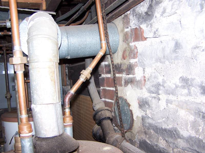

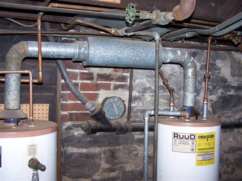

Mark P Posted May 22, 2007 Report Share Posted May 22, 2007 Okay, I have a lot of questions today after spending 6 hours on yesterday afternoon's inspection. This is the first, well maybe not so much a question, as just a second opinion and sharing something different. There are two water heaters (and yes one of them is older then the young lady buying the house, 1978). Take a look out how they are vented. I have never seen this and am not sure what to think of the set up, especially the big muffler looking thing in the middle. There is no pitch except for the short section in the back. Can anyone offer any insight. Regarding the venting I'm thinking I'm going to keep it simple and write "Water heaters vent pipes are pitched improperly - there must be a minimum of ¼ inch upward slope per foot up towards the chimney with no dips or sags - recommend qualified contractor repair as necessary" Download Attachment: water heater 2.jpg 93.33 KB Download Attachment: water heater.jpg 100.42 KB Link to comment Share on other sites More sharing options...
Neal Lewis Posted May 22, 2007 Report Share Posted May 22, 2007 Mark, The muffler looking thing is just the way vents are increased in size. I would be more concerned whether the chimney is unlined, judging by the age of the house. Link to comment Share on other sites More sharing options...
randynavarro Posted May 22, 2007 Report Share Posted May 22, 2007 Why 6 hours? Link to comment Share on other sites More sharing options...
Mark P Posted May 22, 2007 Author Report Share Posted May 22, 2007 Originally posted by randynavarro Why 6 hours? Geez, this house was just plain hard. Nothing was simple at all. It had been a 1890 single family changed to a duplex. Two boilers, two water heaters, two kitchens, multiple panel boxes, all kinds of crazy movement in: basement floor, garage walls, and get a load of this chimney. It was so high I'd have to have a chopper to get a look down it and I was not about to lean my ladder against it. I don't know if you can see in the pic but it was all kinds of crooked. Download Attachment: chimney.jpg 50.34 KB Link to comment Share on other sites More sharing options...
Les Posted May 22, 2007 Report Share Posted May 22, 2007 Mark, take this with a grain of salt! There is way more wrong here than the venting. In fact, I likely would not have gotten too excited about the venting. The flue liner may be an issue, if the brick chimney is an interior one and it does not look that way from the second photo. The flue plenum is ok, if the reducers going into it are equal and the units are equal btu's. The pressure valve on the left unit is not at all acceptable. There is no evidence of backdraft and a little evidence of condensation on the right unit. Neither unit looks to be a 1970's, but I wasn't there. The photo shows every type of pipe known to mankind, except pvc and abs. Kinda cool! I would write it, but would not give any prescriptive advice. "Water heaters are improperly installed" Whenever possible, don't tell them how to fix. Most inspectors get carried away telling folks everything that is wrong and how to fix. That is why I am not a fan of code inspections. We try to keep everything very short and present a reason or two why it is wrong and never allude to a "complete" repair. By the way - repair will be more than a newer better heater. Also, I have spent more than six hours with a young good looking woman doing an inspection. So what that she was my wife! Link to comment Share on other sites More sharing options...
Jim Katen Posted May 22, 2007 Report Share Posted May 22, 2007 The water heater vent connectors can't point at each other like that. They should be offset. - Jim Katen, Oregon Link to comment Share on other sites More sharing options...

StevenT Posted May 23, 2007 Report Share Posted May 23, 2007 In addition to the possibility of the chimney needing a liner, and the two flues being connected offset. What about the compatability of the size/volumn of the chimney being compatable to what it is venting. Too small OR too big is not good. Link to comment Share on other sites More sharing options...
