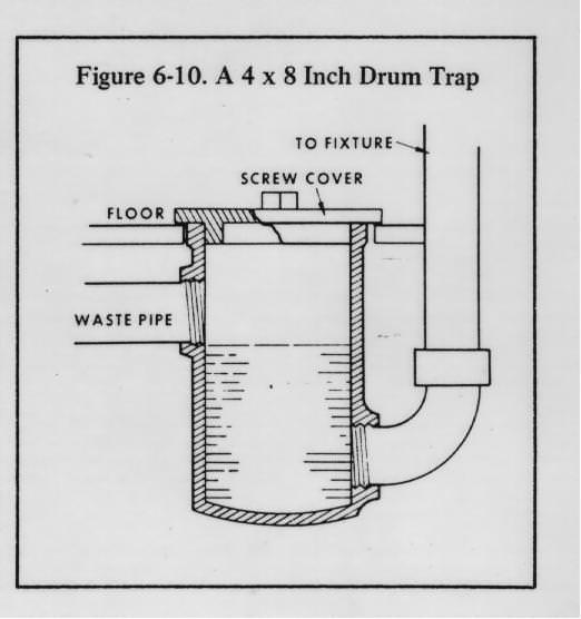

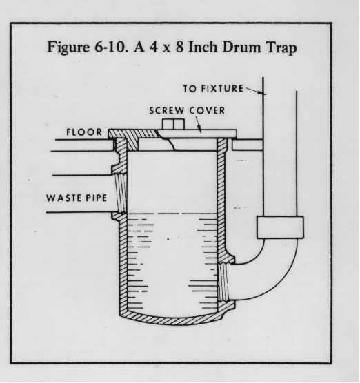

Brian G Posted March 13, 2004 Report Share Posted March 13, 2004 I did a 50 year old house the other day, with some of the original plumbing still in use. Under the bathroom I found something about the diameter of a coffee can (but taller) with the drain lines from the sink and tub run into it. It looks like cast iron and has a flat steel lid on it. Anybody know what this thing is? P.S. Where do you find instructions for posting photos here? Brian G. Quote Link to comment Share on other sites More sharing options...
swarga Posted March 13, 2004 Report Share Posted March 13, 2004 After you type in your message. click on the "Insert a file" link under the text box. Click on browse, find the location of the photo you want to upload. Your plumbing sounds like what I have heard called a pan or con trap. I am sure others here that are used to dealing with older houses will be more help. Quote Link to comment Share on other sites More sharing options...
hausdok Posted March 13, 2004 Report Share Posted March 13, 2004 Hi Brian, It sounds like a drum trap. They're common in pre-50's homes here and still used in commercial applications a lot. Think about those round steel covers on restroom floors. Nasty to deal with when a drain gets clogged, but they will capture things like lost jewelry, rings and coins. Some of them around here are so old that the drain lines going into them are soldered lead. ONE TEAM - ONE FIGHT!!! Mike Quote Link to comment Share on other sites More sharing options...

Jim Morrison Posted March 13, 2004 Report Share Posted March 13, 2004 Brian, It does sound like a drum trap. In the 50's around here they were usually brass. Since they aren't vented, they can be a bitch to replace. Retrofitting a vent in an existing residence can tricky. Quote Link to comment Share on other sites More sharing options...

Gerry Beaumont Posted March 13, 2004 Report Share Posted March 13, 2004 Hi to all, just to add to what has allready been stated, you are looking at a drumtrap, we still see many of these in the north east in older properties. I have seen them made from many materials including cast iron and Brass (If you buy this house I want the salvage rights) Here are a couple of pics the first is from the CDC (which tells you all you need to know about drumtraps !!) The second is somewhat surprising as it is from a supply house that can still offer replacement cover for some models !! Regards Gerry Download Attachment: 6p69-2.jpg 22.12 KB Download Attachment: drumtrapcleanout.jpg 2.68 KB Quote Link to comment Share on other sites More sharing options...

Gerry Beaumont Posted March 14, 2004 Report Share Posted March 14, 2004 Hi to all, OK I give in, I can't bare to see Brian suffer anymore, here witha bit of luck is his "THING" Regards Gerry Download Attachment: thing.jpg 17.92 KB Quote Link to comment Share on other sites More sharing options...

Bill Kibbel Posted March 14, 2004 Report Share Posted March 14, 2004 Brian, This is an old "drum trap". These traps have a greater sealing capacity than the "P" trap and pass large amounts of water quickly. Download Attachment: drumtrap.JPG 31.62 KB Quote Link to comment Share on other sites More sharing options...
