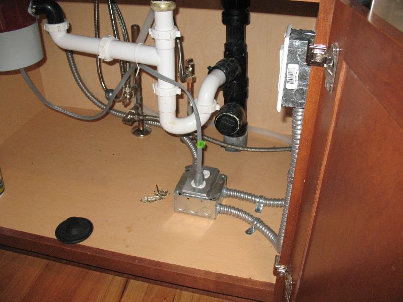

Richard Moore Posted September 28, 2007 Report Share Posted September 28, 2007 2 year old, 3000sf home today. Very few issues, and no other electrical problems, but this, under a kitchen island sink, is a classic. The face up receptacle is bad enough, especially in an area where stuff get tossed in, but it took a real "genius" to position it directly under the trap! Download Attachment: stupidreceptacle.jpg 127.24 KB "Honey, I've dropped my ring down the sink. Would you mind electrocuting yourself again?" Quote Link to comment Share on other sites More sharing options...

Richard Moore Posted September 28, 2007 Author Report Share Posted September 28, 2007 There were some non-electrical issues, but everything else electrical checked out OK. Keep in mind that this was a kitchen island. Those are installed very late in the construction and it's doubtful that whoever did this was the same electrician that wired the rest of the house. Quote Link to comment Share on other sites More sharing options...

Jesse Posted September 28, 2007 Report Share Posted September 28, 2007 Originally posted by randynavarro Originally posted by Jesse Looking at that picture, I'd expect that there'd be a lot more than a few issues in that house. Jesse, What other issues are you thinking of? The waste line materials used lead me to believe they weren't installed by an actual plumber. The house is only two years old, so it's probably original. The receptacle, as noted in the original post, is face-up, which I wouldn't expect a decent electrician to do. So a non-plumber did some plumbing, a non-electrician did some electric... See where I'm going, Randy? No specific issues, just a heightened index of suspicion. Quote Link to comment Share on other sites More sharing options...

Jim Katen Posted September 28, 2007 Report Share Posted September 28, 2007 For those of you who criticize face-up receptacles in cabinet bases, is there a particular NEC section that you use to back up your opinion? - Jim Katen, Oregon Quote Link to comment Share on other sites More sharing options...
Richard Moore Posted September 28, 2007 Author Report Share Posted September 28, 2007 Hi Jim, I can't say I've ever looked for the code. In part, I'm paid for my common sense, and, for me, that's enough in this situation under a kitchen sink (even without the drain issue) no matter what the good book says. If it was at the back of a cabinet used for long term, bulk, dry storage I might not be very excited about it but I would probably still recommend covering the unused slots. But, I can't say I've seen that, so I'll cross that bridge if and when I come to it. Quote Link to comment Share on other sites More sharing options...
Tim Maxwell Posted September 28, 2007 Report Share Posted September 28, 2007 I bet all of that was added after the house was built. The new owner wanted food disposer so they tore out the plumbing to install and then reconfigure and added the electrical. If it were there on original construction surely they would not have put the switch under the sink.... Quote Link to comment Share on other sites More sharing options...
Jim Katen Posted September 28, 2007 Report Share Posted September 28, 2007 Originally posted by Richard Moore Hi Jim, I can't say I've ever looked for the code. In part, I'm paid for my common sense, and, for me, that's enough in this situation under a kitchen sink (even without the drain issue) no matter what the good book says. I don't dispute that it's a poor location for a receptacle. I'm simply wondering if anyone knows of a code reference that prohibits it. - Jim Katen, Oregon Quote Link to comment Share on other sites More sharing options...
Richard Moore Posted September 28, 2007 Author Report Share Posted September 28, 2007 Now you made me look! The only thing I can find is 406.4(E). "Receptacles shall not be installed in a face-up position in countertops or similar work surfaces." I can't find anything on inside a cabinet in particular but you can't expect any code book to foresee all situations, especially the more bizarre ones. Quote Link to comment Share on other sites More sharing options...
Jim Katen Posted September 28, 2007 Report Share Posted September 28, 2007 Originally posted by Richard Moore Now you made me look! The only thing I can find is 406.4(E). "Receptacles shall not be installed in a face-up position in countertops or similar work surfaces." I can't find anything on inside a cabinet in particular but you can't expect any code book to foresee all situations, especially the more bizarre ones. I've never been able to find a prohibition against this either. Would it be alright with you if I posted your picture on Mike Holt's forum and asked them for feedback? - Jim Katen, Oregon Quote Link to comment Share on other sites More sharing options...
