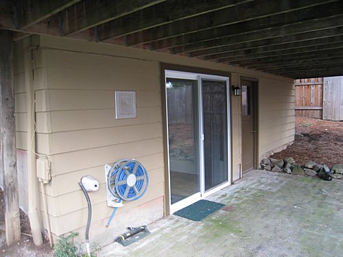

Chris Bernhardt Posted February 26, 2008 Report Share Posted February 26, 2008 From todays inspection. I found moisture in the floor at the corners of a south facing french door (no surprise) by scanning first with my moisture meter. I looked at it passively with the IR camera and could barely distinguish anything so I heated the area up with a blow dryer and then got a good pic. Image Insert: 27.99 KB Image Insert: 84.73 KB They cut a lap siding board and slapped on a ledger without flashing it and now the siding is damaged and who knows what else. Image Insert: 76.32 KB Establishing shot taken from the west and IR images from the east. My bad. Image Insert: 35.87 KB Siding to the right of the sliding glass door Image Insert: 35.71 KB Siding between the sliding glass door and the man door. Image Insert: 35.35 KB Siding right of the man door. Chris, Oregon Quote Link to comment Share on other sites More sharing options...
kurt Posted February 26, 2008 Report Share Posted February 26, 2008 What are the 3 IR images showing? Quote Link to comment Share on other sites More sharing options...
Chris Bernhardt Posted February 26, 2008 Report Share Posted February 26, 2008 The blue is colder. This is where the higher concentrations of moisture were. Normally what I have seen is lower temperatures along the drip edge where the moisture has been concentrated. In this case you can seen the concentration streaking down from the ledger. The surface of the siding was dry. I have shown it using the rainbow pallete rather than the iron pallete. Again, you can see why one of the newer cameras that can overlay the anomaly on the visual pic would be nice. Chris, Oregon Quote Link to comment Share on other sites More sharing options...
kurt Posted February 26, 2008 Report Share Posted February 26, 2008 Oh, OK....duh. You explained it, but I wasn't hearing. I was thinking the problem was the door shown in the establishing shot. It's the door on the deck above, no? If that's the case, I get it completely. Very interesting. Looks like the wall is full of water. Quote Link to comment Share on other sites More sharing options...

Jim Katen Posted February 26, 2008 Report Share Posted February 26, 2008 Originally posted by Chris Bernhardt The blue is colder. This is where the higher concentrations of moisture were. Normally what I have seen is lower temperatures along the drip edge where the moisture has been concentrated. In this case you can seen the concentration streaking down from the ledger. The surface of the siding was dry. How do you know it's water and not the shadow of the deck? - Jim Katen, Oregon Quote Link to comment Share on other sites More sharing options...
Chris Bernhardt Posted February 26, 2008 Report Share Posted February 26, 2008 How do you know it's water and not the shadow of the deck? The siding board at the ledger is visibly damaged (swelling, checking, mold, soft to probing). There are moistures stains, elevated moisture readings and swell patterns that indicate water is coming from above at the ledger all which were correlating with the IR images. It was easy to see visually what was going on. The IR is just helping image the problem. Another interesting thing was in the detached garage, which was unfinished, you could see the lap siding thru the plywood sheathing and the individual tabs of the 3 tab shingles thru the roof decking. I guess the conditions were just right for this. Chris, Oregon Quote Link to comment Share on other sites More sharing options...

Chris Bernhardt Posted February 27, 2008 Report Share Posted February 27, 2008 Did a moisture meter show higher levels of moisture on the interior drywall or in the wall cavity? In this case, No This is how I wrote it up - Moisture/rot damaged siding The hardboard lap siding on the entire house and garage is moisture and rot damaged. The siding on the south sides particularly so and even more so at the deck ledger, which doesnââ¬â¢t look to be properly fastened and flashed to the house. Replace the siding on the house and the garage. Contact a siding contractor or two and get options and costs. Have the deck ledgers properly installed and flashed into the building. There is most probably damage past the siding at or below the ledger so be prepared to get this fixed also. Chris, Oregon Quote Link to comment Share on other sites More sharing options...
kurt Posted February 27, 2008 Report Share Posted February 27, 2008 Not bad. Would it be better to say (paraphrased) "open up the wall, because my machinery is telling me you very likely have rot in the wall and it may need rebuilding"? IOW, I'm wondering about verbiage that reflects the findings of the tool. Thoughts? Quote Link to comment Share on other sites More sharing options...
