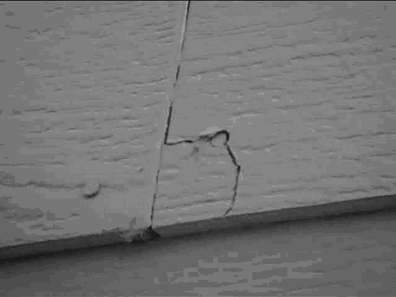

Upset Homeowner Posted April 19, 2008 Report Share Posted April 19, 2008 I just purchsed a new home 6 mo ago. I am running into some siding problems. I have hardiplank and some of it is falling off around the bottom of the house. I went to repair it and found out the problem is that the nails were shot into it too far. The buider tried to fix it by putting in one screw in each board and throwing dirt up to it to hold it in place. I also am noticing that some of the butt joints are not sealed. I live in the state of wisconsin. Do I have any legal recourse. Thanks Quote Link to comment Share on other sites More sharing options...
hausdok Posted April 19, 2008 Report Share Posted April 19, 2008 Hi, Well, first of all, this isn't the place to come for legal advice. Home inspectors are notoriously bad at offering legal advice. I'd get the nearest James Hardie rep out to evaluate it and provide you something in writing about what wrong and what can be done to fix it. They might be willing to accept a report from a competent home inspector along with photos but you'll have to ask them about that. Once you've done that, I suppose that, depending on how much it will cost to correct it, you can either take the siding installer to small claims court or get legal representation and sue the installer to force him to correct it. Either way, I bet it's going to cost you something out of pocket to reach some kind of resolution. ONE TEAM - ONE FIGHT!!! Mike Quote Link to comment Share on other sites More sharing options...

Jim Katen Posted May 2, 2008 Report Share Posted May 2, 2008 Originally posted by Redvette Has anyone seen failure problems with Hardie siding or any of the other fiber cement products? Of the thousands of homes that I've seen clad in FC siding, I've only see one that was failing. It was out at the Oregon Coast. On the south and west sides, the siding pieces had dozens of cracks. I strongly suspect that the material has been abused before it was installed. Here's a whole passel of pictures. Has anyone else seen this? Does anyone else agree that it looks like abused material? Image Insert: 25.68 KB Image Insert: 28.18 KB Image Insert: 35.62 KB Image Insert: 34.96 KB Image Insert: 37.83 KB Image Insert: 25.66 KB Image Insert: 31.62 KB Image Insert: 42.16 KB Image Insert: 43.97 KB Image Insert: 38.97 KB Quote Link to comment Share on other sites More sharing options...
randynavarro Posted May 2, 2008 Report Share Posted May 2, 2008 Interesting how most of those cracks are right at the dead center of the nail. Abused? I'm not sure. If there were cracks during the install, it'd be pretty hard to center that nail gun dead center on the crack and drive it through. Seems like the nails were part of the cracking? Expansion / contraction. I'm certainly not going to start condemning fiber-cement . . . yet. Good mystery, though. It'd be great to hear if there's any resolution on the cause. I'm guessing that's probably not going to happen, though. Quote Link to comment Share on other sites More sharing options...
Jim Katen Posted May 2, 2008 Report Share Posted May 2, 2008 Originally posted by randynavarro Interesting how most of those cracks are right at the dead center of the nail. Abused? I'm not sure. If there were cracks during the install, it'd be pretty hard to center that nail gun dead center on the crack and drive it through. Seems like the nails were part of the cracking? Expansion / contraction. I'm certainly not going to start condemning fiber-cement . . . yet. Good mystery, though. It'd be great to hear if there's any resolution on the cause. I'm guessing that's probably not going to happen, though. My buyer walked. Whoever owns the house will eventually have to replace at least the damaged pieces of siding. There were lots of nails that didn't cause cracking and there were lots of cracks that weren't located near nails. I found myself wondering about the lumber company truck driver's habit of dropping loads off the back of the truck. What if he dropped this load a little too hard? Or what if the installers, working in the rain, didn't bother to use two people to carry each piece and the FC flopped nearly in half every time they carried it from place to place? - Jim Katen, Oregon Quote Link to comment Share on other sites More sharing options...
Redvette Posted May 2, 2008 Report Share Posted May 2, 2008 I agree this appears to be installation problem or an issue with wall framing not a defect in the product. It looks like CertainTeed FC. If on the coast with south & western exposure, weather & wind could be a huge part of the problem. My sister had a B & B on the Newport coast with vinyl siding. Many times we heard the walls & windows flexing in 60 to 90 mph storms. I always wondered how much moisture was getting into the walls. Last summer the Everett Herald had a story about cracking in a FC board called "Maxiplank" in a Stanwood area home. There is class-action suit in California with this product. The photos also had cracking at the nails. It appeared to me the installer had difficulty using a hammer. Paul, Mukilteo, WA Quote Link to comment Share on other sites More sharing options...
hausdok Posted May 2, 2008 Report Share Posted May 2, 2008 Hi Jim, It looks to me like they put the stuff on wet and that the cracks developed when it dried and shrank. Perhaps they put it on wet and didn't get a perfectly straight line. When the stuff dried it would crack wherever one edge was crowning. I know, that sounds weird, but this stuff is cement, silica sand, and processed wood fiber after all. It's going to swell and shrink a certain amount when exposed to moisture and when it's allowed to get wet and then nailed into place things are going to happen when it dries out. ONE TEAM - ONE FIGHT!!! Mike Quote Link to comment Share on other sites More sharing options...
Chad Fabry Posted May 2, 2008 Report Share Posted May 2, 2008 Or what if the installers, working in the rain, didn't bother to use two people to carry each piece and the FC flopped nearly in half every time they carried it from place to place? I can almost guarantee that's what happened. Over flexing the product causes the layers to separate from each other. The only thing I've witnessed to be a true vulnerability is allowing the product to freeze if it is saturated. It makes it kind of crumbly. Quote Link to comment Share on other sites More sharing options...
Richard Moore Posted May 2, 2008 Report Share Posted May 2, 2008 I'm not sure I can buy the "put-on-wet" theory. Even the un-primed stuff is allowed to sit on the house for 90 days and all they warn against is gaps at the butt ends if installed wet or saturated... Image Insert: 29.12 KB Image Insert: 36.79 KB I can't tell if this was the pre-colored stuff, but as that seems to be fairly rare (probably way more expensive) I'm going to assume it was the regular, plain vanilla siding. All Jim's cracks look like they developed, or at least opened, sometime after painting. I'd have to go with mechanically abused material, but I'm just not sure when that abuse would have taken place. Part of the problem is I just don't want to believe anyone would install pre-damaged siding (but I'm probably being naive). Jim...were there any drywall cracks inside suggesting the house getting racked at some point...like someone might have driven a truck into a corner? Quote Link to comment Share on other sites More sharing options...
