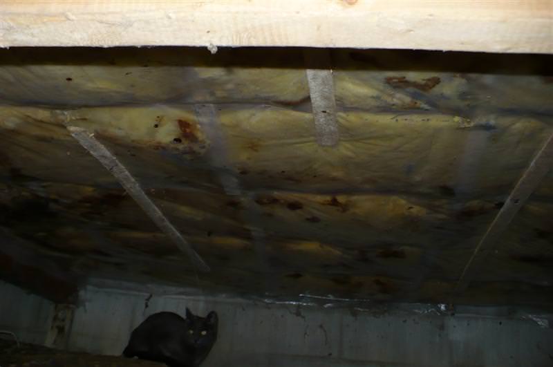

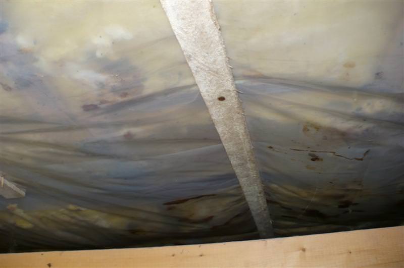

gtblum Posted August 21, 2008 Report Share Posted August 21, 2008 This is under an heated alcove between the garage and house that I did last night. One side of it is skirted, the other side is wide open to the prevailing wind. Should this poly be slashed, or removed or what do you think? This is bigtime snow country. Image Insert: 41.05 KB Image Insert: 40.28 KB Quote Link to comment Share on other sites More sharing options...
Jim Katen Posted August 21, 2008 Report Share Posted August 21, 2008 Originally posted by gtblum This is under an heated alcove between the garage and house that I did last night. One side of it is skirted, the other side is wide open to the prevailing wind. Should this poly be slashed, or removed or what do you think? This is bigtime snow country. If it were my house, I'd yank the plastic and the strips of lath then I'd sheath the underside of the joists with plywood. This would keep out the critters, protect the insulation and reduce airborne moisture movement. It would increase the risk of condensation on the top side of the plywood, but I think that the risk would be small. Alternatively, I'd wall in the open side and turn it into a crawlspace. - Jim Katen, Oregon Quote Link to comment Share on other sites More sharing options...

Tom Raymond Posted August 23, 2008 Report Share Posted August 23, 2008 If it were my house, I'd yank the plastic and the strips of lath then I'd sheath the underside of the joists with plywood. This would keep out the critters, protect the insulation and reduce airborne moisture movement. It would increase the risk of condensation on the top side of the plywood, but I think that the risk would be small. Alternatively, I'd wall in the open side and turn it into a crawlspace. - Jim Katen, Oregon Plywood and OSB are vapor bariers, so besides the critters why is this any different than the poly? Tom Quote Link to comment Share on other sites More sharing options...
Jim Katen Posted August 23, 2008 Report Share Posted August 23, 2008 Originally posted by Tom Raymond If it were my house, I'd yank the plastic and the strips of lath then I'd sheath the underside of the joists with plywood. This would keep out the critters, protect the insulation and reduce airborne moisture movement. It would increase the risk of condensation on the top side of the plywood, but I think that the risk would be small. Alternatively, I'd wall in the open side and turn it into a crawlspace. - Jim Katen, Oregon Plywood and OSB are vapor bariers, so besides the critters why is this any different than the poly? Tom The plywood is certainly a vapor retarder. In this instance, however, it would be much better than the plastic for one big reason. It will do a much better job of reducing air movement. This, in turn, will prevent a lot of moisture movement which, in turn, will reduce the likelihood of condensation. Moisture can move downward from the house into the joist spaces through diffusion or via air transport. Moisture movement through diffusion is usually a non-issue in buildings. The big culprit is air transport. If you can reduce air movement, you'll reduce condensation. Also, even with the poly, there's little risk of a problem in this location. Air very rarely moves downward from the inside of a house into the crawlspace. It almost always moves upward due to the stack effect. I doubt that plywood under the joists will be any worse than plywood on the outside of walls. - Jim Katen, Oregon Quote Link to comment Share on other sites More sharing options...

randynavarro Posted August 23, 2008 Report Share Posted August 23, 2008 Jim - clarification? Plywood has a perm rating of .36 6 mil plastic has a perm rating of .06 Plastic is a much better retarder than ply. You suggest that ply will do a better job than plastic at reducing air movement. Do you say this because there may be more seams and tears in the plastic? Quote Link to comment Share on other sites More sharing options...
Jim Katen Posted August 24, 2008 Report Share Posted August 24, 2008 Originally posted by randynavarro Jim - clarification? Plywood has a perm rating of .36 6 mil plastic has a perm rating of .06 Plastic is a much better retarder than ply. You suggest that ply will do a better job than plastic at reducing air movement. Do you say this because there may be more seams and tears in the plastic? Air movement has nothing to do with the perm rating. The perm rating affects vapor diffusion. We've learned that vapor diffusion is vastly less important in buildings than we used to think it was. Even though the plastic has a better perm rating, it will develop holes, tears, rips, and so forth. That will make it pretty much useless. The plywood is sturdier, has a decent enough perm rating to prevent wild swings in moisture (from the outdoor air) and will protect against wind, weather & critters. If the interior of the building is a steam sauna and if the stack effect magically reverses itself there might be some condensation down there, but I suspect that those conditions will be unlikely. Perm ratings have very little to do with the effects of moisture in buildings. It's all about air movement. The amount of moisture that passes through materials via vapor diffusion is minisule compared to the airborne moisture movement that occurs through the vast great gaps & holes in most buildings. - Jim Katen, Oregon Quote Link to comment Share on other sites More sharing options...
randynavarro Posted August 24, 2008 Report Share Posted August 24, 2008 Perm ratings have very little to do with the effects of moisture in buildings. It's all about air movement. The amount of moisture that passes through materials via vapor diffusion is minisule compared to the airborne moisture movement that occurs through the vast great gaps & holes in most buildings. Agreed. Air movement is much more important than vapor diffusion. So to be exceptionally clear. . . If one were to skin a wall perfectly with a 6 mil, heck, let's say 10 or 12 mil plastic; no seams, no holes, no cuts, that would be a better performing* wall than skinning with 1/2" plywood. Yes? *performance is defined as minimal vapor diffusion and basically zero air movement Quote Link to comment Share on other sites More sharing options...
Chad Fabry Posted August 24, 2008 Report Share Posted August 24, 2008 If one were to skin a wall perfectly with a 6 mil, heck, let's say 10 or 12 mil plastic; no seams, no holes, no cuts, that would be a better performing* wall than skinning with 1/2" plywood. Yes? A SIPS wall or ceiling panel has basically the same net effect resulting in very close to zero air movement and vapor diffusion. There wouldn't be a problem with a Thermos style wall either. The problem lies in real life details that allow air and vapor into a cavity where it can't escape. It all looks good on paper until you throw a SawzAll wielding Bubba into the recipe. Windows are all self flashing..Right? Quote Link to comment Share on other sites More sharing options...
Jim Katen Posted August 24, 2008 Report Share Posted August 24, 2008 Originally posted by randynavarro Perm ratings have very little to do with the effects of moisture in buildings. It's all about air movement. The amount of moisture that passes through materials via vapor diffusion is minisule compared to the airborne moisture movement that occurs through the vast great gaps & holes in most buildings. Agreed. Air movement is much more important than vapor diffusion. So to be exceptionally clear. . . If one were to skin a wall perfectly with a 6 mil, heck, let's say 10 or 12 mil plastic; no seams, no holes, no cuts, that would be a better performing* wall than skinning with 1/2" plywood. Yes? *performance is defined as minimal vapor diffusion and basically zero air movement Your hypothetical wall would have less vapor diffusion. I don't know if it would be better in any measurable way though. - Jim Katen, Oregon Quote Link to comment Share on other sites More sharing options...
randynavarro Posted August 24, 2008 Report Share Posted August 24, 2008 Your hypothetical wall would have less vapor diffusion. I don't know if it would be better in any measurable way though. Well, if we were to extend the experiment and build a small house, basically a cube with the same "perfect" parameters, we could test with a blower door. Quote Link to comment Share on other sites More sharing options...
