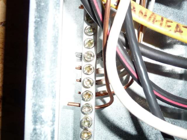

gtblum Posted August 8, 2009 Report Share Posted August 8, 2009 I had an electrician tell me that Cutler Hammer panel installation manuals state, double taps on the buss are A Ok as long as the wires are the same size. Anyone heard of this? Quote Link to comment Share on other sites More sharing options...
Jim Port Posted August 8, 2009 Report Share Posted August 8, 2009 Are you asking about the grounded or grounding conductors? Grounded conductors need to be one per hole. Grounding conductors can be 2-3 per hole, depending on the size range. They should be the same size per hole. Quote Link to comment Share on other sites More sharing options...
gtblum Posted August 8, 2009 Author Report Share Posted August 8, 2009 Click to Enlarge 53.13 KB Quote Link to comment Share on other sites More sharing options...
Jim Port Posted August 8, 2009 Report Share Posted August 8, 2009 As stated in my first post. One white per hole. Bare or green grounding can typically share the same hole. Quote Link to comment Share on other sites More sharing options...
gtblum Posted August 9, 2009 Author Report Share Posted August 9, 2009 I had an electrician tell me that Cutler Hammer panel installation manuals state, double taps on the buss are A Ok as long as the wires are the same size. Anyone heard of this? Thanks for the response Jim. This is how I called it but, what about the question? Sorry about not posting the pic with the OP. Quote Link to comment Share on other sites More sharing options...
Jim Port Posted August 9, 2009 Report Share Posted August 9, 2009 This was commonly done, but was incorrect. This was a listing and labeling violation. The label had to be read to know the correct method. This has now been spelled out in the NEC. Quote Link to comment Share on other sites More sharing options...

Jim Katen Posted August 9, 2009 Report Share Posted August 9, 2009 I had an electrician tell me that Cutler Hammer panel installation manuals state, double taps on the buss are A Ok as long as the wires are the same size. Anyone heard of this? Terminals that can be used with more than one conductor have to be "identified." (110.14(A)) In older editions of the NEC, such terminals had to be "approved for the purpose." I don't believe that you can make such a blanket statement about all Cutler Hammer panels. *Some* Cutler Hammer panels might allow more than one conductor per terminal. If they do, it will be clearly spelled out on the panel label. You have to read the labels carefully. Some allow two "grounding" conductors on the terminal or they allow two conductors on the "grounding" terminal. In both of those cases, they're not talking about the neutral (white)(grounded) wires. There are some manufacturers who will, indeed, allow two grounded (neutral)(white) wires per lug. Before you call this a problem, you've got to read the label. Of course, if the area you're in has adopted the 2002 (or later) NEC, then the point is moot for anything installed since then. Here are a couple of typical labels. - Jim Katen, Oregon Download Attachment: 108-0873_IMG.JPG 385.73 KB Download Attachment: Ite.JPG 93.83 KB Quote Link to comment Share on other sites More sharing options...

Jim Katen Posted August 9, 2009 Report Share Posted August 9, 2009 Sent that pdf to the client yesterday after reading it to the electrician. As far as I'm concerned at this point, unless they can produce the documentation on this box proving his argument. The play stands as called. The issue is one of labeling. Either the equipment is labeled for two wires under each lug or it isn't. Your answer should be printed right there on the panel label. I also think that Mr. Pauley's summary is misleading. You should know that he was the person who submitted the code change that prohibits double tapped neutrals beginning with the 2002 edition. The contents of that PDF is almost word-for-word the backup that he included in his code change submittal. He says, "The requirement has generally been enforced in the past by a close review of the manufacturer markings and by NEC® 110.3(B)." Note that he said "generally" enforced. 110.3(B) simply says that you have to install listed equipment in accordance with the instructions that came with it. Since some manufacturers allow two neutral conductors under a single lug on some panels, his statement is true, but misleading. He also cites UL 67 and quotes, ââ¬ÅAn individual terminal shall be provided for the connection of each branch-circuit neutral conductor.â⬠Quote Link to comment Share on other sites More sharing options...
gtblum Posted August 12, 2009 Author Report Share Posted August 12, 2009 Finally had time to post this pic. I'll apologize now if it's too big. Now that you can see it, what's the verdict? "wire holes are suitable for" Download Attachment: Cutler hammer.bmp 1608.74 KB Quote Link to comment Share on other sites More sharing options...
Jim Katen Posted August 12, 2009 Report Share Posted August 12, 2009 Finally had time to post this pic. I'll apologize now if it's too big. Now that you can see it, what's the verdict? "wire holes are suitable for" It says this (underlining is mine): When used as service equipment, any unused neutral holes may be used for equipment grounding. For equipment grounding applications, wire holes are suitable for (1) #14-4 or up to (3) #14-10 wires. Multiple wires in the same hole must be the same size and material. This device accpets Cutler-Hammer type GBK ground bars. Wire holes are suitable for (1) #14-4 or up to (3) #14-10 wires. Multiple wires in the same hole must be the same size and material. It's pretty clear to me that the provision for multiple wires in a single hole applies to equipment grounding conductors NOT to grounded (neutral) conductors. Per 110.14(A) there should only be one neutral wire per lug in this particular panel. That might not be true of all Cutler Hammer panels. - Jim Katen, Oregon Quote Link to comment Share on other sites More sharing options...

gtblum Posted August 13, 2009 Author Report Share Posted August 13, 2009 Must be he re-read the label. I was told tonight,the wiring had been corrected. Quote Link to comment Share on other sites More sharing options...
