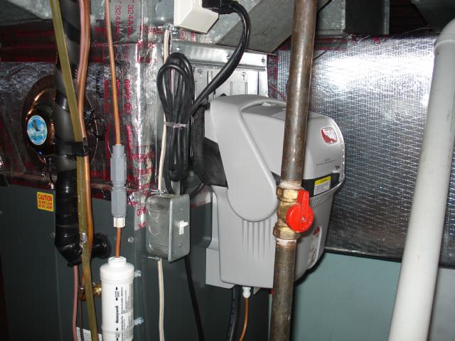

RobC Posted January 3, 2010 Report Share Posted January 3, 2010 Interesting looking hum. Would you have more info on it, brand name etc? Is it a bypass model? I like the double check valve idea and I'm guessing you're pre-filtering the supply. Another question if I may, is the unit on the supply plenum? Is +/- 25% too high, you think? I get that question from first time buyers and I tell them it's like marriage, a matter of keeping everybody happy. It's a game of keeping the ratio nose to window in equilibrium. Too dry - the nose is unhappy (window happy) Too wet - the window unhappy (nose happy) Balanced - the window and nose are happy. As far as those meaningless numbers.....I ignore them. Quote Link to comment Share on other sites More sharing options...

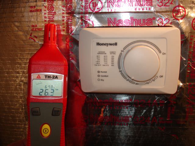

Terence McCann Posted January 3, 2010 Report Share Posted January 3, 2010 But why do the manufacturers put that nonsense on the humidistat? My guess is they want user to turn down the humidistat, when it starts getting cold outside, so that you don't do exactly what we're discussing. It's still goofy though. When I talk to people about this most of them get a glazed over look and want to move on. It is important though. I always put wording in my report regarding the ramifications about too much humidity in the winter. The photos are from my own house. The RH reading on the hygrometer--which probably isn't the most accurate instrument on the planet--was the same in the living space as it was in the basement. Is +/- 25% too high, you think? 25% may be OK depending on the outdoor air temp. Knowing what the warning signs are helps you judge. We were at 10F this morning and 25% would have been way too high. At that RH there would have been water on my windows (and in my attic). Don't forget that humidity can travel through drywall so as it goes into an attic it also goes through walls. Quote Link to comment Share on other sites More sharing options...
Marc Posted January 3, 2010 Report Share Posted January 3, 2010 Original quote by Terence:I tell the buyer to get a real humidistat, the type that comes with a barometer in most cases. In cold weather, 0-20 deg f. do not keep the home above 10% RH or so. I also tell them that if they start to see water condensing on the windows they're putting to much humidity into the home. I don't quite follow. I always though that an RH value of between 40% and 60% is healthiest for humans. My daughter got nosebleeds in the winter until I installed a portable room sized humidifyer in the largest room of the house which is set to maintain 60% humidity (duty cycle hits 100% for a few days during cold spells as the RH varies from 40 to 60%). Water condensing on the windows is a sign of heat loss. Of course, I'm from the Gulf Coastal area where the winters seldom get below 32 degrees. Marc Quote Link to comment Share on other sites More sharing options...
Bain Posted January 4, 2010 Report Share Posted January 4, 2010 It's a Honeywell TrueSTEAM, Rob, and it's a direct injection, so there's no membrane in the ductwork and much less water is used than traditional humidifiers. The water supply is filtered as you supposed, and the system is on the supply-side trunk duct. You can Google the unit and learn a lot more than I can tell you about it. You and I are fairly close to each other, Terry, and the low was in the upper single digits last night. There was the slightest bit of moisture on a couple of windows--single pane with storms--directly above registers, but the others were clear. I'll crank down the RH per your advice and see what happens. I know what moisture does to buildings, but the humidifer is a recent addition and it's incredible how much more comfortable it makes my house. Skin, nose . . . virtually everything is happier in a house that has a little humidity. Also, if you look to the left of the humidifier, you'll see an RGF Guardian air purifier. It's the total nuts (Does anyone here play poker?). Cooking odors, big-ass wet German Shepherd odors . . . they're all just a memory now. Here's a brochure for the purifier. Scroll down to the second page to get the lowdown on how it works. Download Attachment: rgf guardian.pdf 464 KB (Umm, and I promise I'm not one of those spammers in disguise that show up every once in a while to hawk a product.) Quote Link to comment Share on other sites More sharing options...
Terence McCann Posted January 4, 2010 Report Share Posted January 4, 2010 Original quote by Terence:I tell the buyer to get a real humidistat, the type that comes with a barometer in most cases. In cold weather, 0-20 deg f. do not keep the home above 10% RH or so. I also tell them that if they start to see water condensing on the windows they're putting to much humidity into the home. I don't quite follow. I always though that an RH value of between 40% and 60% is healthiest for humans. My daughter got nosebleeds in the winter until I installed a portable room sized humidifyer in the largest room of the house which is set to maintain 60% humidity (duty cycle hits 100% for a few days during cold spells as the RH varies from 40 to 60%). Water condensing on the windows is a sign of heat loss. Of course, I'm from the Gulf Coastal area where the winters seldom get below 32 degrees. Marc The key is your regional area - this is why I said this applies to the climate where I live in one of my previous posts. If I tried to stick an RH of 60% in my home when it's 10F outside I'd be mopping up condensation for sure. Over humidifying a home in this area is a real problem. I try to keep my home where we stop shocking each other (most of the time) but don't see any problems with condensation. Quote Link to comment Share on other sites More sharing options...
Terence McCann Posted January 4, 2010 Report Share Posted January 4, 2010 Nice mechanical system John. I didn't know that H/W produced a residential steam humidifier. Is it wired to the fan or heat circuit? Quote Link to comment Share on other sites More sharing options...
hausdok Posted January 4, 2010 Report Share Posted January 4, 2010 John, If I'm reading that right, you've plugged an ozone generator into your HVAC system. Everything I've ever read about those things - except the stuff printed by the folks that make them - said that ozone kills living organisms and that, though it's really effective at eliminating the bacteria and stuff that leaves odors in the air, it literally kills lung tissue. Is this gizmo somehow different than the typical ozone generator? ONE TEAM - ONE FIGHT!!! Mike Quote Link to comment Share on other sites More sharing options...
Bain Posted January 4, 2010 Report Share Posted January 4, 2010 Terry, it's wired into the fan. The humidifier and blower will energize whether there's a heat demand or not. Mike, I'd never heard of that, but a quick Google explains what you're talking about. I don't know what to say other than, "Holy Mackerel." I will definitely probe further and get back to you. Quote Link to comment Share on other sites More sharing options...

kurt Posted January 4, 2010 Report Share Posted January 4, 2010 I purchased a Fluke 971 a few months back in anticipation of this winter, and it's been quite interesting. First, whatever the dial says on any humidistat is fluff; I've yet to find any humidistat that provided the RH printed on the dial; it's always off at least 20% from what they say, both over and under. Second, I've now been educated on how wildly different every attic is. It's amazing how some attics can have everything set up completely wrong, and be just fine, and how some attics are set up "perfectly", but the RH is excessive. Point being, Katen and Mike are right when they say all houses are different. One can't point at anything as a culprit until one has gone over the entire "machine" and figured it out. Does anyone else have a 971, and if so, how are they using it? Quote Link to comment Share on other sites More sharing options...
