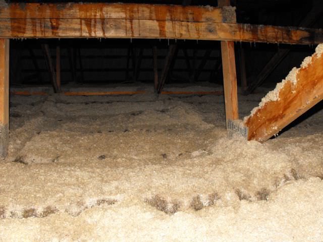

John Dirks Jr Posted January 6, 2010 Author Report Share Posted January 6, 2010 I know you have a moisture encounter meter, what were your readings on the sheathing? I didn't use the moisture meter in the attic. To me it was clear that there was a condensation problem. I didn't need the tool to help me conclude a suspicion. The evidence was clear. The moisture was visible with the naked eye and the roof sheathing and gable wall was wet to the touch. Quote Link to comment Share on other sites More sharing options...
John Kogel Posted January 6, 2010 Report Share Posted January 6, 2010 I know you have a moisture encounter meter, what were your readings on the sheathing? I didn't use the moisture meter in the attic. . I agree, John. The pics you posted show soaking wet sheathing. The first order would be to dry it up, I think. Then clean up, insulate, seal the hatch and I would definitely call for venting those fans outside. Some people generate much more moisture just by the way they operate their heaters and fans. Like the others have said, no two houses are the same. Hatch leaks are pretty common, but some attics aren't affected. It could be just life styles. A couple of leaky fan pics to illustrate. The 60 year old attic was probably fine until they stuck that vent pipe up there. Click to Enlarge 66 KB Click to Enlarge 67.63 KB Quote Link to comment Share on other sites More sharing options...
Brandon Whitmore Posted January 6, 2010 Report Share Posted January 6, 2010 Side note: that flex duct vent pipe (heat duct) is most likely not allowed for that use. Quote Link to comment Share on other sites More sharing options...
hausdok Posted January 6, 2010 Report Share Posted January 6, 2010 Side note: that flex duct vent pipe (heat duct) is most likely not allowed for that use. Care to explain that, 'cuz that's what's exclusively used in new construction around here. OT - OF!!! M. Quote Link to comment Share on other sites More sharing options...
Chad Fabry Posted January 6, 2010 Report Share Posted January 6, 2010 Care to explain that, 'cuz that's what's exclusively used in new construction around here. I don't believe it's required by code but every fan I've installed recommended insulated duct in unconditioned spaces to prevent condensation. Bottom left of page two Quote Link to comment Share on other sites More sharing options...
