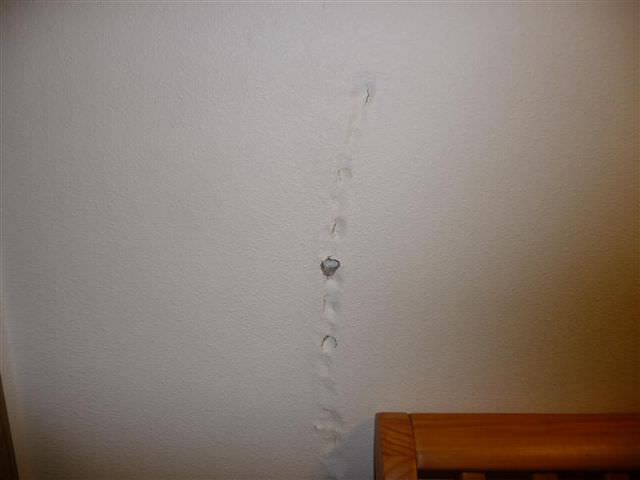

Robert Jones Posted January 28, 2010 Report Share Posted January 28, 2010 This is a home built in 2002. This wall damage is caused by the hot water pipe that is coming from the water heater. The water heater is driectly on the other side of this wall in the garage. From the relatively small area of damage it doesn't appear to be a water leak. The area is very hot to the touch and the damaged drywall is crumbling. Is this a bonding issue? Insulation issue? Somethng else. Thanks. Click to Enlarge 24.77 KB Click to Enlarge 49.87 KB Click to Enlarge 20.55 KB Link to comment Share on other sites More sharing options...
mgbinspect Posted January 28, 2010 Report Share Posted January 28, 2010 Hmmm... well, I wonder if that pipe has taken a nail, which will seal in a copper pipe quite nicely. Often at first they don't leak at all, but eventually begin to seep and then become a fine constant spray. It's another one of those now and then disaster restoration happenings. They can take years to actually leak significantly. Of course, you'd get a high reading with a moisture meter if that is the case. How'd things look below? Link to comment Share on other sites More sharing options...
Robert Jones Posted January 28, 2010 Author Report Share Posted January 28, 2010 The bottom was perectly dry/normal. I was thinking that if there was a leak, that more of the drywall would be soft/damaged. According to the homeowner(whatever that is worth), the damage hasn't gotten worse since they moved in which was approx 2 yrs ago. I call shennanigan's but.... Link to comment Share on other sites More sharing options...
mgbinspect Posted January 28, 2010 Report Share Posted January 28, 2010 The ultimate reaction between a hot copper pipe and Cinese drywall? - throwing it out in total ignorance... Unfortunately, I have no other thoughts.. but I'm quite interested to see what the brain trust comes up with. Good luck! As a matter of fact, looking at the composition of the material around the hole, it hardly resembles drywall anymore. It looks to me like a chemical reaction between the copper and the gypsum. Link to comment Share on other sites More sharing options...
Marc Posted January 28, 2010 Report Share Posted January 28, 2010 Maybe a one-time event in the past, such as a leak on the pipe, did the damage to the wall, corroded the pipe and was simply never fixed. Marc Link to comment Share on other sites More sharing options...
Robert Jones Posted January 28, 2010 Author Report Share Posted January 28, 2010 I agree. You can see the condition of that copper pipe in the second pic and the heat was to the point that you really didn't want to leave your hand there for any period of time. Link to comment Share on other sites More sharing options...
inspector57 Posted January 28, 2010 Report Share Posted January 28, 2010 I would report this: "There is damaged drywall in the xxx room that is in the same area as the water pipe. Have the wall opened to investigate the cause and repair it." I personally would lean toward water damage but it might just be damaged drywall that was installed anyway and not properly finished. Link to comment Share on other sites More sharing options...
mgbinspect Posted January 28, 2010 Report Share Posted January 28, 2010 The gypsum looks completely expanded (blown out) - no longer dense. That's my bet - a reaction. I've dealt with a ton of water damage, and it usually not only shows stains, but would not typically be so isolated and defined. It seems to outline be where the pipe contacts. I'm no rocket scientist, but there are seversal possible players in the scenario, if it is a reaction: the gysum, which I believe is basic; the copper, possibly excessive flux and heat (an accelerator?). The materials apparently don't like each other. And, if it's as hot as you say it is, I'd definitely urge the home owners to stop ignoring it. Good luck, Robert. MIke Link to comment Share on other sites More sharing options...
Ed Cope Posted January 28, 2010 Report Share Posted January 28, 2010 I can't tell from the picture. Is the pipe close to the drywall in the second picture? You said that the bottom of the wall was dry. Could it be that the plumber used soft copper in the wall and did not have enough room to make the bend required to come out of the wall at the top? Maybe he came up in the center of the wall at the bottom and then pushed it up against the drywall to make the bend at the top. Without any insulation on the pipe it could have been sweating inside the wall. The moisture made an outline of the pipe on the wall until it got towards the bottom where it fell off. If the hole has been there for two years, as the owner said, the warm air getting into the wall may have stoped the sweating and any further damage. Ed Link to comment Share on other sites More sharing options...

Erik Posted January 28, 2010 Report Share Posted January 28, 2010 Looking at what I can see in the pictures are you sure that wasn't a tape seem? looks like some one patched the wall with tape but put no mud behind the tape Link to comment Share on other sites More sharing options...

Terence McCann Posted January 28, 2010 Report Share Posted January 28, 2010 In the second picture it looks like a couplng, that had a tiny leak, and self sealed. Did you check the areas with a moisture meter? Link to comment Share on other sites More sharing options...

Robert Jones Posted January 28, 2010 Author Report Share Posted January 28, 2010 Sorry guys was offline. This was not a manufactured home, stick built in 2002. I did check the area with a moisture meter, the area was normal/dry. Definately not a tape seam. I actually dug around that second pic and made the hole a little larger to try and see the pipe. Link to comment Share on other sites More sharing options...
Terence McCann Posted January 28, 2010 Report Share Posted January 28, 2010 Sorry guys was offline. This was not a manufactured home, stick built in 2002. I did check the area with a moisture meter, the area was normal/dry. Definately not a tape seam. I actually dug around that second pic and made the hole a little larger to try and see the pipe. Is that a pipe coupling in the second picture Robert? Link to comment Share on other sites More sharing options...
